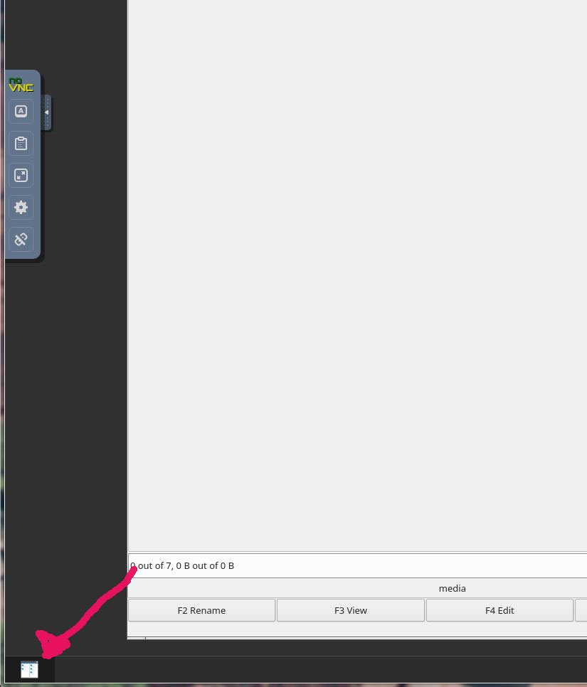

Web UI goes to blank screen with nothing  but a VNC side slide window... I get no actual Krusader UI
Look down to the bottom of the Krusader VNC window and click on the icon to see if it is possible that the app was just minimized.
This I what I have, I am not sure where to look for it to be minimized. Is this the menu I should be in?
No here:
3 minutes ago, Frank1940 said:
No here:
I am not sure if you are pointing to the windows task bar at the bottom, outside of the browser or not, but windows is not showing any VNC applications down there.  It only comes up with a new Chrome tab, with the left VNC menu slide out bar, and the gray background.  ?

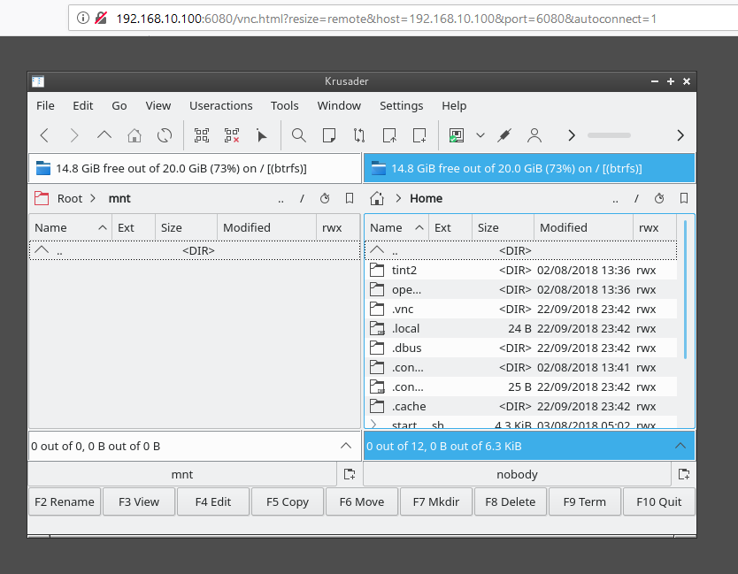

hey guys, got this installed but cannot see my disks.  under host path 2, i put /mnt/ but cannot find my disks anywhere.   am trying to use this instead of MC, need some help please.
here is a screen shot of where I end up.
figured it out, sorry, didn't know i needed to go into the media folder to find my disks, i was looking for mnt..
