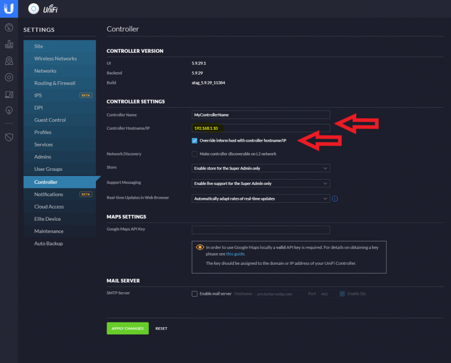

On 3/7/2019 at 10:51 AM, sreknob said:
Big thanks as usual to the team!
For those having adoption issues, I vaguely remember having issues before about that.
In case you don't already have custom IP in controller settings, you might want to make sure that you have set the IP under settings.
I had a issue where the controller was trying to set-inform with my private docker IP (172.17..1.X) instead.
See screenshot below, checking "Override inform host with controller hostname/IP" and entering the IP of your server above that.
This worked perfectly for me.  I tried to do the initial installs of the AP and got the adoption loop when I had the docker to set to bridge.  One I changed the above settings in the controller everything connected properly.  No need to change the docker to host with this change.
Glad it worked for you @block134

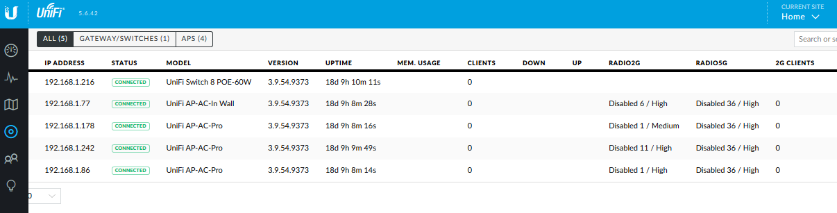

I'm going to hazard a guess that it's because the radios are disabled?
My fault, should have mentioned that Unifi is displaying the radios as disabled is incorrect.  All AP's are working normally.  I would normally see both wired and wireless clients.

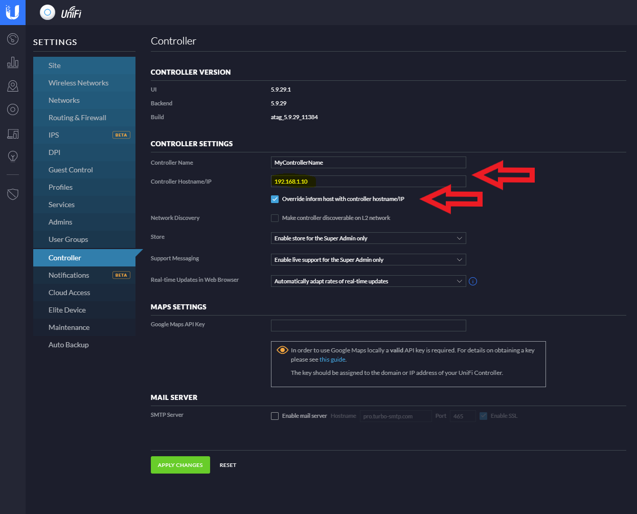

Im new to Unifi and this is a brand new installation  USG with 16-port 150W Switch and one UAP Pro for a small Business. All three devices are stuck in the adopting stage, then they show disconnected for couple of second and again back t adopting in a never ending loop. any ideas?
You need to do what's being done in this picture or read the post right above your one.image.png.8bc217f65ae5771dc220e9639f82e74d.png
(Stolen from post further up)
Edited by j0nnymoe
Yes this worked for me thank you very much.  This should be part of the initial instructions
