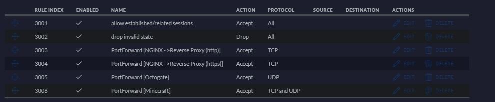

Hello everybody!
Yesterday I did the latest update for the Unifi Controller according to the instructions described here. Through the updates, my USG3P was patched to the current firmware.
Since then, the port forwardings no longer seem to work. Two ports (80 and 443) were forwarded to a letsencrypt docker responsible for a Nextcloud container. The whole thing went wonderfully until yesterday's update.
According to CLI and WebGUI, all rules are in place, but the cloud is beyond reach. Also other port forwardings to a test network and a Minecraft server do not work. Thus, I exclude a mistake in the Docker containers.
Does anyone have a similar or even the same problem and a solution for it?
The whole thing runs on the current Relase version of Unraid (6.6.6).
Grettings
Edited by Gorosch

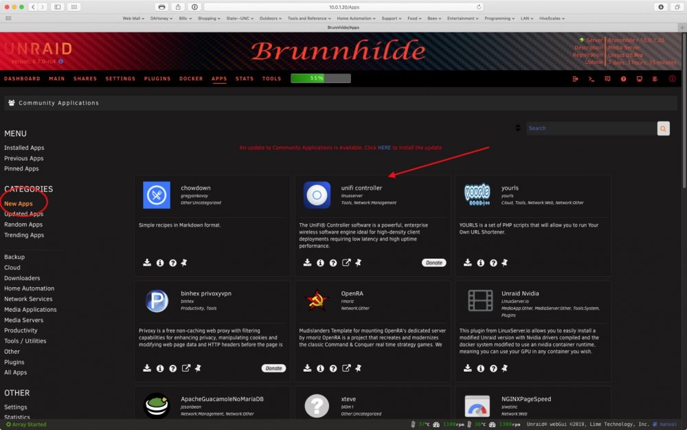

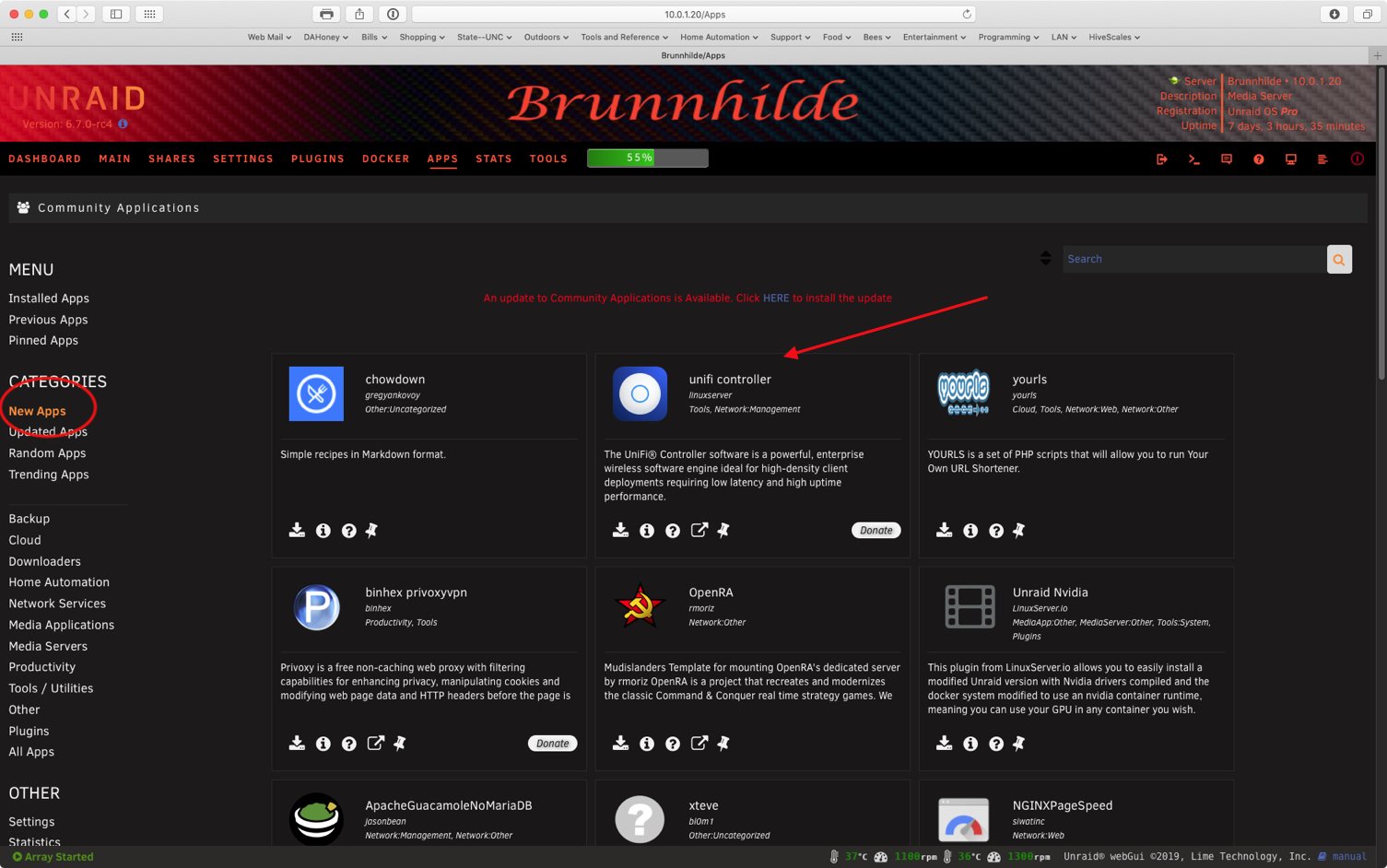

This is going to sound completely ridiculous, but i cant even seem to find any unifi containers in the app search in unraid. I even search for apps by linuxserver and see nothing relating to unifi. What might I be doing wrong?
Edited by r6xual
If you select the “New Apps” category you don't even need to search. It’s right in the middle.
Sounds like CA is woefully out of date.  Check for updates
This was the issue. I did not know you could / needed to update the plugin. Thank you thank you!
