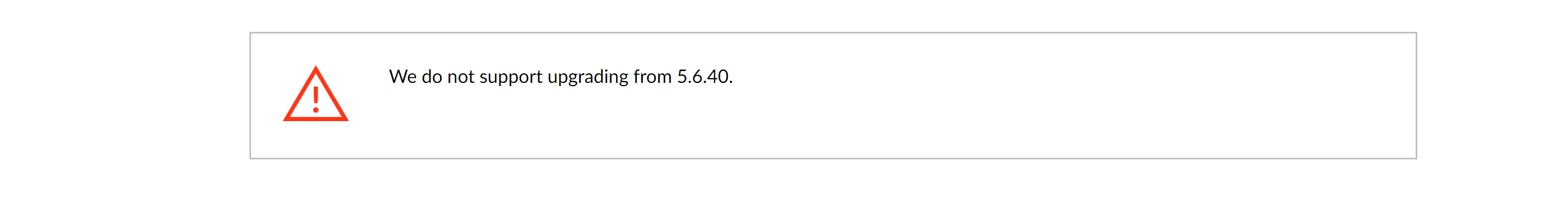

1. Backing up appdata foler for the old Unifi Linuxserver IO docker (v5.6.40)
2. Stopping the old docker
3. Installing this new docker v5.7.x branch (getting this error message on the splash screen)
4. Reinstalled new docker using LTS branch with success (config present devices adopted)
5. Retried pulling the v5.7.x branch and receivedd the same error message by editng the repository parameter in the docker
Please help me with how to upgrade to 5.7.x and above.

A quick update on this. Since this I figured out how to get passed the above. This may help others.
1. Skipped 5.7.x tree and went to 5.8.x
2. Rather than just changing the tag and pulling 5.8.30 I had:
     a. created a backup via the Unifi controller in 5.6.40
     b. created a new 5.8.x docker (with new appdata folder) in the Unraid UI
     c. Walk through new docker settings in 5.8.30
     d. Once in the Unifi UI reesore the backup created
3. To then move to 5.9.x just edit the docker in Unraid GUI, change the tage to "5.9" then pull updated instance
4. Log in
All just worked.
Edited by FestivusOz
