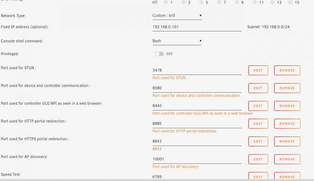

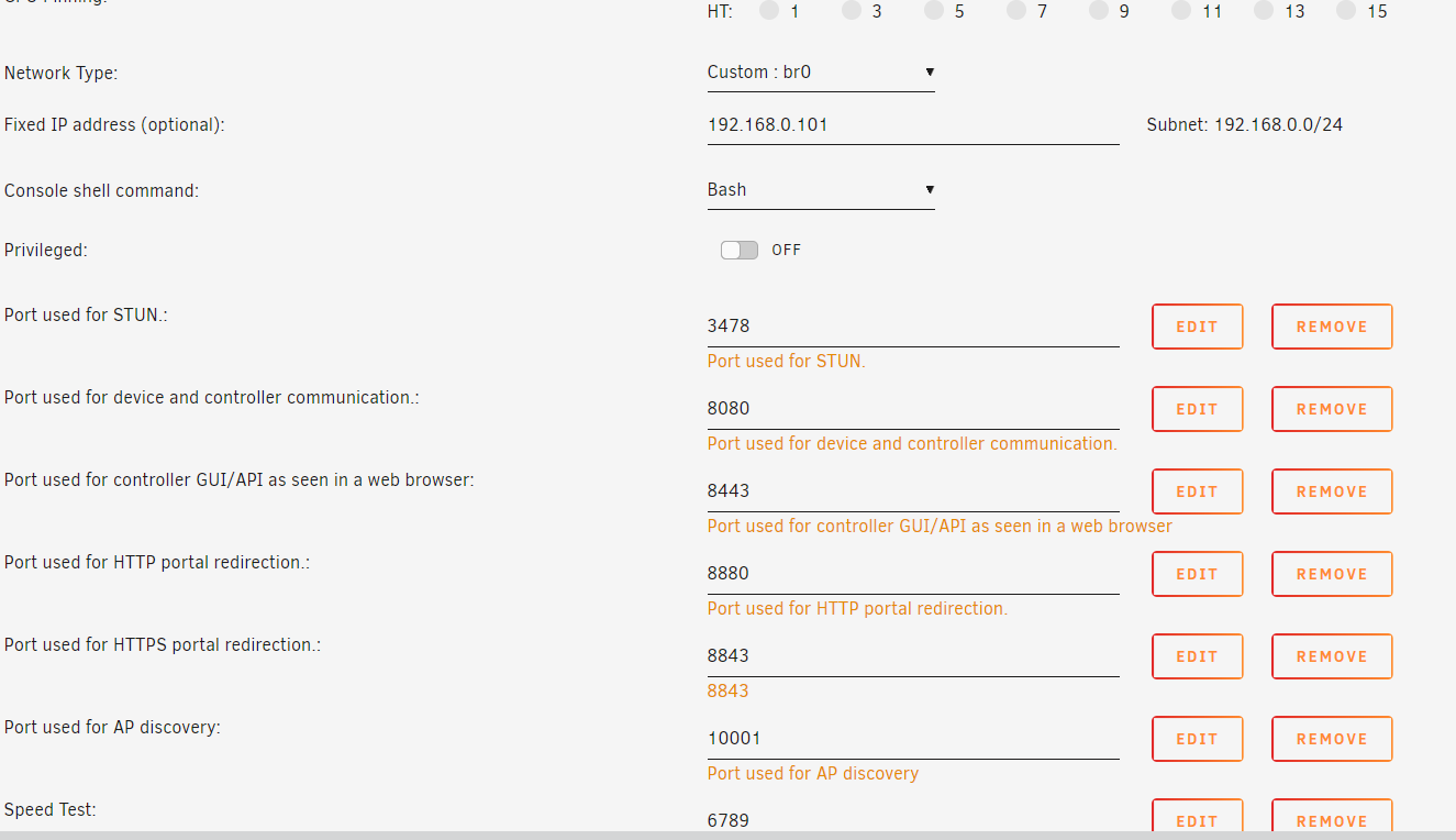

Having an issue when i move the docker to Custom: Br0 due to having conflicts with host mode. When i change to Br0 custom, i get this error. Things seems to be working at first glance tho

Another issue I just found is when I add UDP 1900 as a port it does not show up.

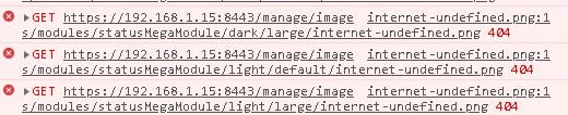

Has anyone come across this before?
Capture.JPG.299c0dd3b1424d8cfbc79cd13b7eb42d.JPGCapture2.JPG.58b5b29b52eea656ba1c5ff7bf8ba316.JPG
