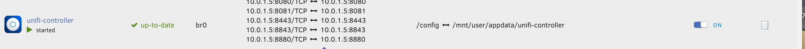

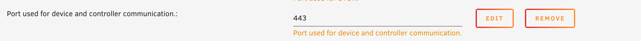

SInce I have it running in its own IP, how do I change the ports to be standard http/https ports? I've tried editing system.properties and the docker settings with no luck
Port mappings are configured in the docker configuration. Just go to the docker tab and click the unifi-controller link. This will open the configuration page and you can use the edit buttons to change the port mappings.
Except that it doesn't seem to work. I set the web interface in the docker edit screen to 443 and it still maps to 8443.1634166972_ScreenShot2019-07-18at09_03_13.thumb.png.b6f0ca04bc6f591a560390fcc857b203.png
1519534424_ScreenShot2019-07-18at09_03_47.thumb.png.220782f233196666830d80bc16b22668.png
If you click on 'Show docker allocations' at the bottom of the docker container edit screen, does it show another container as already using port 443 in bridge mode (assuming you are using the container in bridge mode on the host IP)?
Both Heimdall and Pihole (and probably others) want to use that port by default.
EDIT: Oops, just noticed you said in a previous post it is running on its own IP.
Edited by Hoopster
You did use the “Edit” button to change the setting right. Not sure that it matters, but it might. Checking for conflicts as @Hoopster suggested is also a good idea. Also posting the run command so that others can see the full settings. Be sure to redact any user/password fields.
