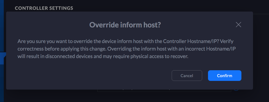

Also, do you have the 'Overide inform host with controller hostname/IP' checkbox selected in the Controller Settings?  This is pretty much mandatory with this container.

Ok, but it gives me a warning saying I need to make sure that host name is correct or I won't be able to connect.
By default it has unifi.yourdomain.com  . Do I need to change that or just check the box and leave the default address?
Well, you certainly don't want to override it with unifi.yourdomain.com :)
The Controller Hostname/IP should contain the IP address of your unRAID server if you are running the container in bridge mode on the host server (some find they need to run it in host networking mode initially to even do adoption).  If you have the container assigned its own IP address on a VLAN or custom network, you should enter that IP address.

Well, you certainly don't want to override it with unifi.yourdomain.com [emoji4]
Mine is in bridge mode on the host unRAID server so I have the unRAID IP address as the Controller host.

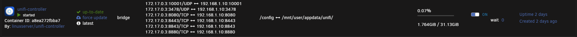

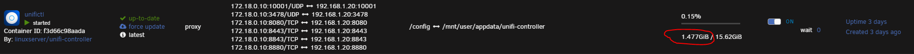

Not sure anybody is experiencing the similar issue as me, after I upgraded to the latest release - 5.11.50, the memory load this unifi container keeps increasing, looks like some memory leak issue. Initially, after setup, the load is just about  800MB, after 3 days, increased to 1.5GB. Previously, with the same version, same configuration, that memory load reached more than 4.5GB.

The latest is 5.12.35. I updated this container to that version a couple of days ago and in those two days the container is now using 1.76 GB.  Frankly, I do not know if that is "normal" as I have not been checking memory usage on docker containers frequently.  It is much, much more than any other active docker container is using (the next largest are CrashPlan at 803 MB and Plex at 534 MB), but, I don't know what is "normal" for UniFi.
Edited by Hoopster
Thanks for sharing your data! I will give it a try to upgrade and report back some times later. I neither have an idea what's the normal memory load for unifi controller, but keeps increasing to 4.5GB and more seems not so normal.

I'm having the same memory leak issue with my UniFi docker container. When I first start the container, it uses about 700MB then after about 3-4 days its all the way up to 6.5+GB. Eventually, if I don't do anything about it, the entire server will lock up and a hard reset is the only option. However, if I see that my ram is at 95% or so and I simply restart the container, it drops to about 43%. It's pretty ridiculous. My last resort to fix the issue was to backup the Unifi controller using the web interface, completely uninstall the docker container, delete everything in appdata and reinstall. I then restored my backup using the unifi controller interface again. This didn't help. I've also tried to set a max memory usage on the docker container to 3--4GB. After it reaches the limit, the container becomes unresponsive, but at least it doesn't take down the whole server. Apparently this issue has been around for a long time. Is there any solution?
