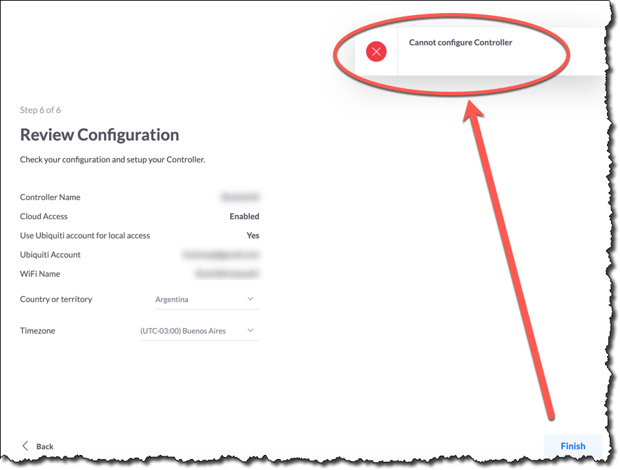

Hi, i'm trying to use the app, i have tried with :latest and default, but the error is always the same, in the step 6 (manual configuration), appears the error: Cannot configure Controller, this is the screen capture:
could you help me to solve the issue?
thanks and regards.

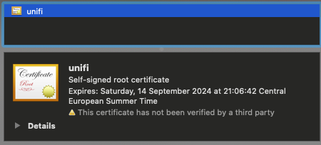

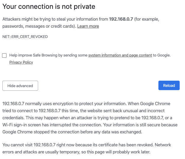

I wonder if I might get some help with my problem in here, even though it's not a docker problem.
I just updated my Mac to 10.15 Catalina, and now I can't access the controller on my server https://192.168.0.7:8443/ any longer.
Before the update I got the "Your connection is not private" message, but pressing Advanced I could go on anyway. That's not available now.
I might have had this problem before, and then doing some kind of certificate, that's now invalid, but I don't remember what I did and I don't know what to do now.
Please help me with this.
Thanks.
/Söder

This looks more like an issue Chrome blocking the invalid cert rather an issue with the docker container.
That's why I wrote as I did in my post. 😃 I thought that I maybe could get some help with it anyways.
/Söder
