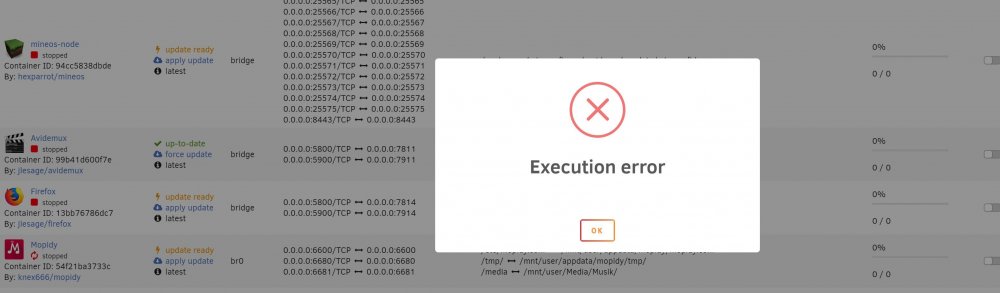

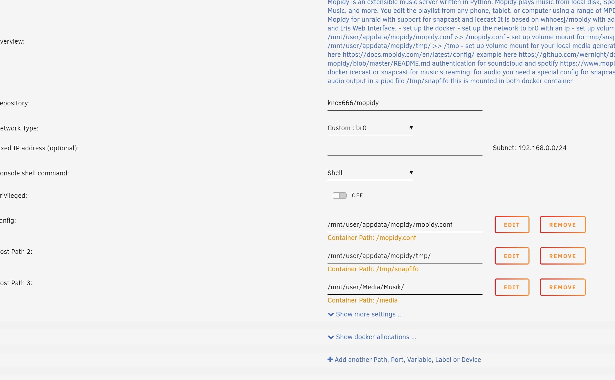

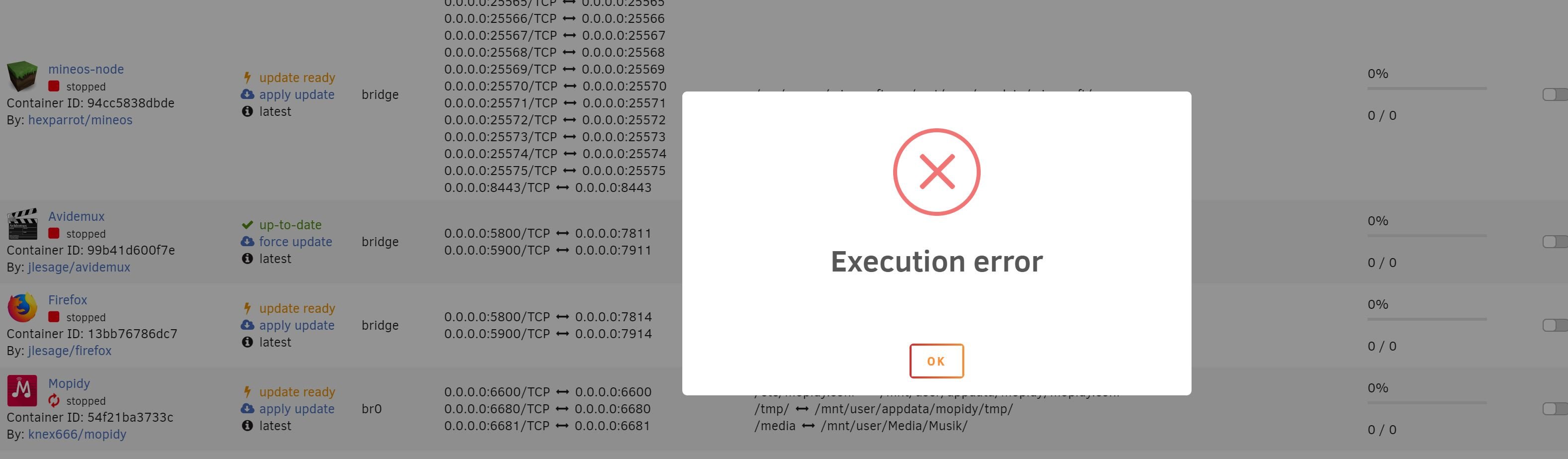

Cant seem to install it. I made sure all paths were correct and picked an ip address but its always telling me its failed.
root@localhost:# /usr/local/emhttp/plugins/dynamix.docker.manager/scripts/docker run -d --name='Mopidy' --net='br0' --ip='192.168.0.5' -e TZ="America/New_York" -e HOST_OS="Unraid" -v '/mnt/user/appdata/mopidy/mopidy.conf':'/etc/mopidy.conf':'rw' -v '/mnt/user/appdata/mopidy/tmp/':'/tmp/':'rw' -v '/mnt/user/media/Music/':'/media':'rw' 'knex666/mopidy'
061521d60da08664c0bd6ff1937ad685bf238f92ee2efc3de398bd875550d334
/usr/bin/docker: Error response from daemon: OCI runtime create failed: container_linux.go:344: starting container process caused "process_linux.go:424: container init caused "rootfs_linux.go:58: mounting \"/mnt/user/appdata/mopidy/mopidy.conf\" to rootfs \"/var/lib/docker/btrfs/subvolumes/404d13417f8511c1a7192a4b26a0311fed3bfec5bb534e5dfa92611bc5c1eb46\" at \"/var/lib/docker/btrfs/subvolumes/404d13417f8511c1a7192a4b26a0311fed3bfec5bb534e5dfa92611bc5c1eb46/etc/mopidy.conf\" caused \"not a directory\""": unknown: Are you trying to mount a directory onto a file (or vice-versa)? Check if the specified host path exists and is the expected type.
Is the mopidy .conf suppose to be a folder or file? Because it does create a folder in appdata but nothing inside. Guessing because it cant start?
Edited by mkono87
That looks to me like you're trying to to mount a file which you can't.  only folders allowed
Ah see thats what the template does by default so I was a little confused if it was intended to be a folder name too.
I still get the same error though.
Edited by mkono87
No it is right it is a file and as explayned above you have to create that file put it to the specific path and mounting works
Thats not true ;) but the file has to exists which is not does by default

hi I installed and uninstalled this program and tried to reinstall
but its not working
when I click Start to start the application  I get a execution error and a null error
what I gotta do to get this puppy up and running.. as I wanna try to stream internet radio
but its not working
Can you post the error message for me to debug?
@knex666 this is what happens when i try to start it.. i left them as the defaults as i just only wanna stream internet radio  through the unraid motherboards sound card  not like my desktop  so cant even test your program...
as i want to have my unraid hooked up to my stereo and just stream radio  and not need the app open.. and i never edited the conf file maybe thats why i having issues i just left it as default.. like any app set it up then just run webgui.. so many my fault
Edited by comet424
