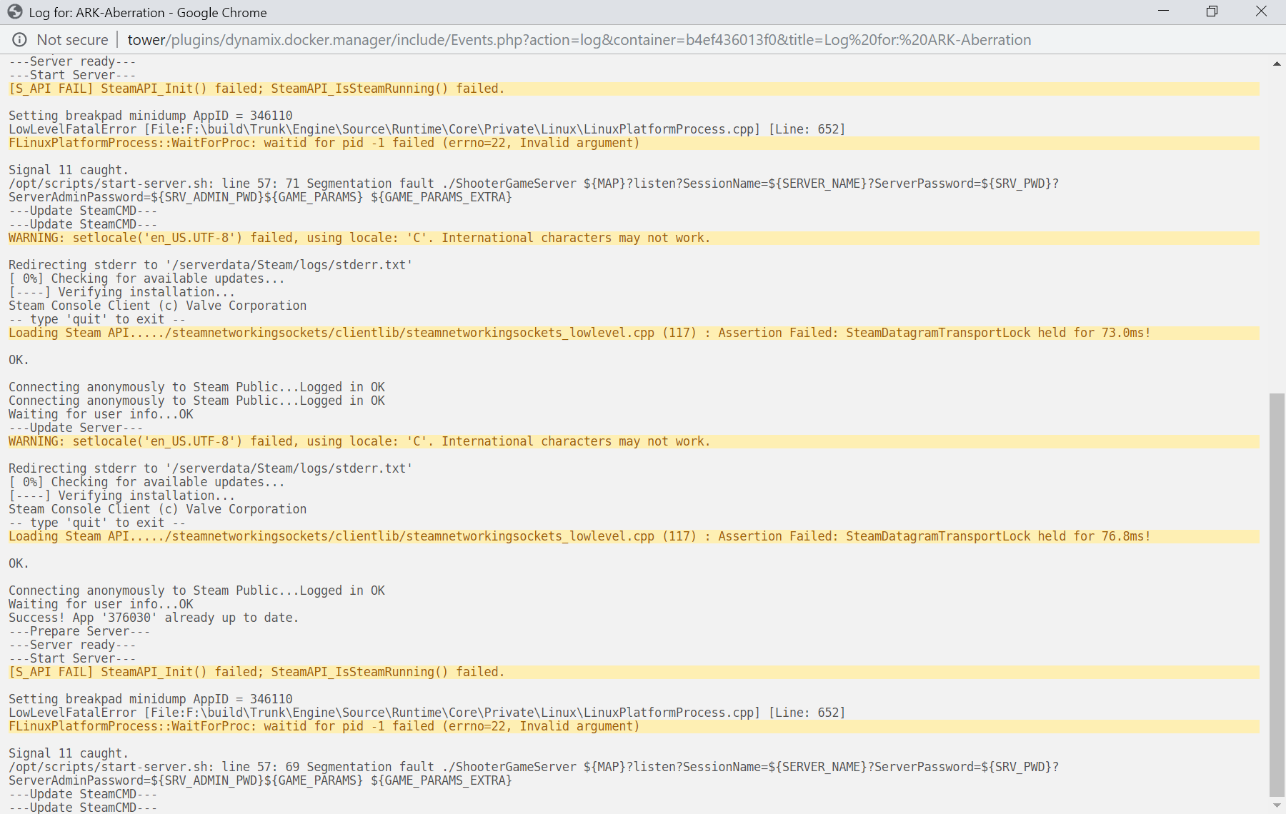

First, I would like to thank @ich777 for building these Docker images!
I would also like to thank @Jo7410 for posting his config earlier.  This helped me confirm what I thought I needed to put in to make certain things work (like clustering, which I think I've configured but I need to test).
I have been setting up my local copy of the ARK Server docker image, and I've come across one issue, one minor issue, and one feature request that I would like to see implemented.
Whenever I attempt to use the flag -automanagedmods the Docker image will not successfully start the server.  When I try to use it, I end up with a loop that ends with:
Signal 11 caught.
/opt/scripts/start-server.sh: line 57: 71 Segmentation fault ./ShooterGameServer ${MAP}?listen?SessionName=${SERVER_NAME}?ServerPassword=${SRV_PWD}?ServerAdminPassword=${SRV_ADMIN_PWD}${GAME_PARAMS} ${GAME_PARAMS_EXTRA}
Due to this, I have to manually copy over the Mod files I want to use in my server.  In addition, if Mods are specified without manually copying the files over then I get the error in my log (the actual value after container: is different depending on the mod(s) specified):
e":"No such container: 8c4de0864230"}
I used the instructions at https://www.akliz.net/manage/knowledgebase/66/How-to-Install-ARK-Survival-Evolved-Mods-on-a-Server.html to copy the Mod files over.
This is not a major issue for me, but perhaps add a comment to the documentation about this if it is not an easy solution to fix this.
One minor issue is that the Server Name: (Container Variable: SERVER_NAME) field does not appear to handle spaces despite the Ark Server ini file allowing spaces in the Server Name.  This is not a major issue, and can be corrected in the ini file after the Docker is up and running, but there is risk of the Server Name changing whenever the Docker image rebuilds the ini file.  If possible, please adjust this setting to pass spaces correctly, but if this is not an easy fix then it should be fine with the documentation mentioning that it cannot parse spaces.
I would like to request that the field Server Password (Container Variable: SRV_PWD) be made optional instead of mandatory.  Due to the age of my children, I use a whitelist with the -exclusivejoin flag so that they do not need to type a password to play.  However, the Docker image requires that a password be specified.  I think I can modify this after the Docker is built and running from the ini file, but I have observed that the ini file is recreated whenever the Docker config is changed (and also at other times, although I have not figured out what triggers this).
Where did you put in the -automanagedmods? In the 'Game Parameters' or in the 'Extra Game Parameters' if you put it in the 'Extra Game Parameters' it should work fine.

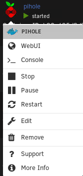

Click again on the log button on the Docker overview page, this is because you changed something in the Docker on Unraid (maybe a 'Game Parameter' or 'Extra Game Parameter' or something else) and it runns now under a differnt Container ID (look at the picture underneath), the log is still there but the ID has changed from '8c4de0864230' to something else so it can't find the log for the Container ID: 8c4de0864230, like above click again on the log button and the window will show the log with the new Container ID.

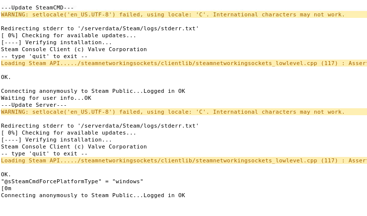

First time trying this, using 'the Forest' as my first attempt. I'm not sure if I'm doing something wrong here. First it says failed to determine free disk space but also says wine32 is missing. I have plenty of disk space available :/
I will look into that, give me a few moments, must install the Docker again...
Where did you put the folder for steamcmd and theforest? If it's in the standard directory you need plenty of space on the cache drives.
I will report back.
Edit1: No problem so far
Edit2: @AnyColourYouLike Server is running now, i noticed that i also got the wine32 error but it keeps on and starts the server (since it's a 64bit game it could run without win32 - no need to install it because the docker will even get bigger) attached 2 screenshots.
Edited by ich777

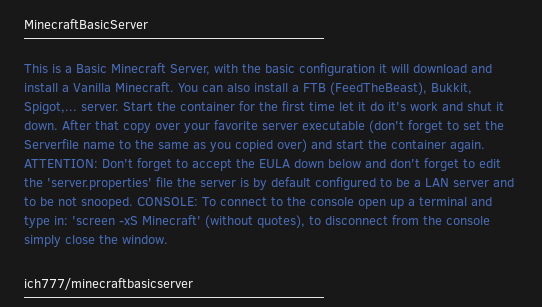

Could you please do an Unraid Docker for Minecraft Bedrock Edition? It's the only reliable, well performing server for Bedrock Edition(Nukkit is terrible), and I've been struggling with making my own container for it(I'm very new to Docker) - I can get it to run, but I can't get my preferences to be anywhere accessible, nor can I get it to be persistent. I end up with folders created outside the container, but all interactions going on inside the container, and it's just a big mess.
Very simplistic server, the "bedrock_server" file is a binary you simply run, the settings are stored in "server.preferences" and the default ports it runs on are 19132 (ipv4 over UDP) and 19133 (ipv6 over UDP)
As far as I can tell there's no "graceful" way to shut it down outside of it's own console.
also here's the official icon for the game, which I imagine you'd use if you do make the docker for it:
Hello, yes i will take a look at this in the next few days, but can you explain whats different to the standard minecraft server? Is this a version without java?
Thanks so much!
Minecraft Bedrock Edition is the Microsoft App Store(Windows 10) version(as well as the Portable Edition, and the XBox One, etc), which is a "separate game" entirely. It's a new engine, and the servers/clients are not cross-platform capable(separate licensing as well). It's written in C++ and is a separate entity. :)
Edited by kronflux

23 hours ago, kronflux said:
Thanks so much!
Is the part for the cross-platform right, you wrote that it's not cross-platform capable...
So this would make no sense to make a server for this if you're on windows if they are not cross-platform capable.
Edit: Uploaded the template and should work fine, tested everything ;)
Should be available in a few hours :)
Edited by ich777
I apologize for how long it has taken to reply to this.  My priority was getting my kids setup how they wanted, and this allowed me to work a little more with this Docker Image:
Signal 11 caught.
I have verified that I placed this flag into Extra Game Parameters.  I went ahead and captured the output from when I edit the Docker:
root@localhost:# /usr/local/emhttp/plugins/dynamix.docker.manager/scripts/docker run -d --name='ARK-TheIsland' --net='bridge' -e TZ="America/Chicago" -e HOST_OS="Unraid" -e 'GAME_ID'='376030' -e 'USERNAME'='' -e 'VALIDATE'='' -e 'PASSWRD'='' -e 'MAP'='TheIsland' -e 'SERVER_NAME'='Call-The-Island' -e 'SRV_PWD'='' -e 'SRV_ADMIN_PWD'='ARKAdmin' -e 'GAME_PARAMS'='?Port=7777 ?QueryPort=27015 ?RCONEnabled=True ?RCONPort=27016 ?bAllowUnlimitedRespecs=true ?FastDecayUnsnappedCoreStructures=true' -e 'GAME_PARAMS_EXTRA'='-server -log -exclusivejoin -automanagedmods -NoBattlEye -clusterid=call1 -ClusterDirOverride=/serverdata/clusterfiles' -e 'UID'='99' -e 'GID'='100' -p '7777:7777/udp' -p '7778:7778/udp' -p '27015:27015/udp' -p '27016:27016/tcp' -v '/mnt/user/appdata/steamcmd':'/serverdata/steamcmd':'rw' -v '/mnt/user/appdata/ark-se/island':'/serverdata/serverfiles':'rw' -v '/mnt/usr/appdata/ark-se/cluster':'/serverdata/clusterfiles':'rw' --restart=unless-stopped 'ich777/steamcmd:arkse'
30e4fd7cbd207015fc8a7ac69096a52b41cd6befba92f8fe5c4ba03e2a84b864
Whenever I include the -automanagedmods flag, I get this error looping in my log until I stop the Docker image.  Removing only the -automanagedmods flag allows the server to start and run as expected, except it does not check/update the installed mods.
This behavior is consistent across three separate ARK Docker Images.
Please look at this post *click* i think this is more of an ARK error than one from the docker (i know this post is a little bit old but should be recent enough).

root@localhost:# /usr/local/emhttp/plugins/dynamix.docker.manager/scripts/docker run -d --name='ARK-Aberration' --net='bridge' -e TZ="America/Chicago" -e HOST_OS="Unraid" -e 'GAME_ID'='376030' -e 'USERNAME'='' -e 'VALIDATE'='' -e 'PASSWRD'='' -e 'MAP'='Aberration_P' -e 'SERVER_NAME'='' -e 'SRV_PWD'='' -e 'SRV_ADMIN_PWD'='ARKAdmin' -e 'GAME_PARAMS'='?Port=7781 ?QueryPort=27015 ?RCONEnabled=True ?RCONPort=27020 ?bAllowUnlimitedRespecs=true ?FastDecayUnsnappedCoreStructures=true ?MaxPlayers=10' -e 'GAME_PARAMS_EXTRA'='-server -log -exclusivejoin -NoBattlEye -clusterid=call1 -ClusterDirOverride=/serverdata/clusterfiles' -e 'UID'='99' -e 'GID'='100' -p '27020:27020/tcp' -p '7781:7781/udp' -p '7782:7782/tcp' -p '27019:27015/udp' -v '/mnt/user/appdata/steamcmd':'/serverdata/steamcmd':'rw' -v '/mnt/user/appdata/ark-se/aberration':'/serverdata/serverfiles':'rw' -v '/mnt/usr/appdata/ark-se/cluster':'/serverdata/clusterfiles':'rw' --restart=unless-stopped 'ich777/steamcmd:arkse'

That is correct per the ARK command line.  However, the Docker gives the same looping error on startup as when I use the -automanagedmods flag if I do not have the spaces in there.  I noticed on @Jo7410 's post that they were using spaces before the ? and when I added spaces to mine the looping error was resolved.
OK, this is strange.  The looping error was the first major problem I encountered the first time I used the Docker, and it was resolved by adding spaces to the Game Parameters field like I saw in @Jo7410's screenshot.  I tried removing the spaces just now so that I could capture the error and Docker build message, and everything worked just fine.  I cannot explain it.
56 minutes ago, ich777 said:
Please try to correct the game parameters eventually this is the problem...
I'm not understanding what needs to be corrected here.  The INI file location is where the ARK software sets it up at.
Is the problem solved with the servername? Then i will change the discription like two comments above and add a note that if you want the name from the ini file you have to leave that empty.
Yes, by changing the required setting and leaving the field blank my issue is resolved.  Thank you for your assistance so far, and thank you for building this Docker image!
Edited by bubo
Updated the Game Parameter's discussion.
No, not in the 'Extra Game Parameters' there must be spaces eg: '-log -automanagemods'.
Spaces are not allowed in the 'Game Parameters'
These two Variables 'Game Parameters' and 'Extra Game Parameters' are the command line, it's added to the start command of the server.
Eventually there was a typo or some other kind of error and the server went to a looping state (if you put a false command in there where the server can't start it will loop forever).
My bad, want to say that you should remove the space from the 'Game Parameters' and hopefully this will solve the other problem with the ini file. ;)
