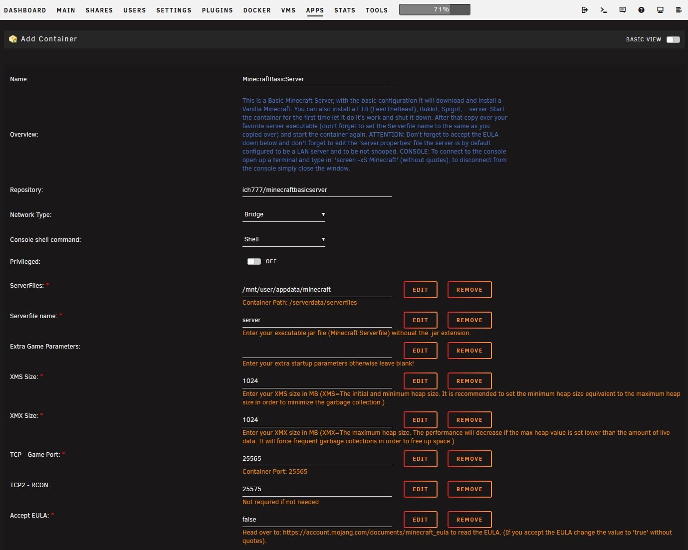

You only have to configure these few variables (leave the ports as the are and increase the XMS and XMX Size a little bit if you have many mods to let's say: 4096 and set Accept EULA to true).
Look on how to set up a forge server on google and copy then the files over to the server directory (don't forget to stop the conatiner, delete everything in the folder and then put copy everything over and start the conatiner again).Screenshot.thumb.jpg.087a9bced532780b1a4bb316a9b7cdb8.jpg

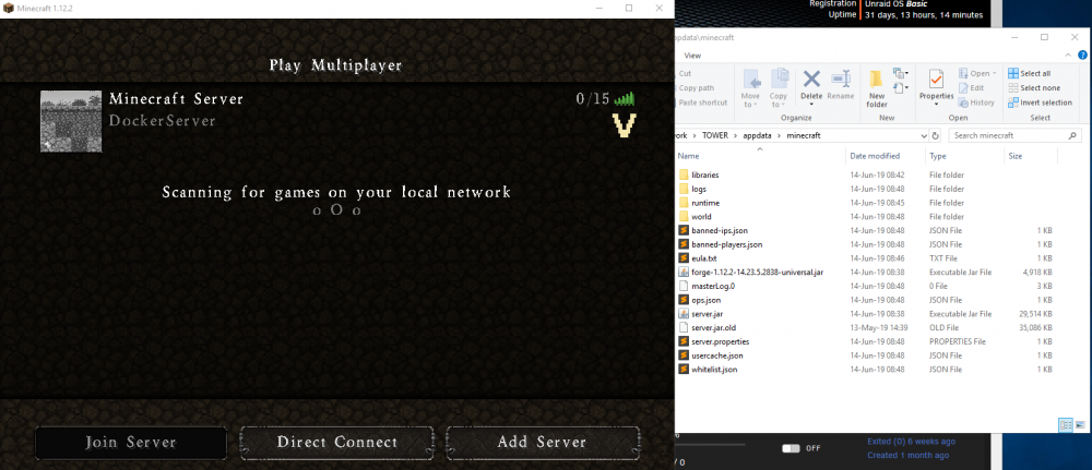

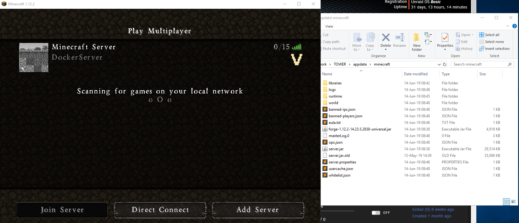

I create a forge server in my desktop and place all the files inside and i rename the minecraft.version to server.jar
I run it and I have a vanilla version
I made a screen of minecraft and of my folder files
What am I doing wrong?
