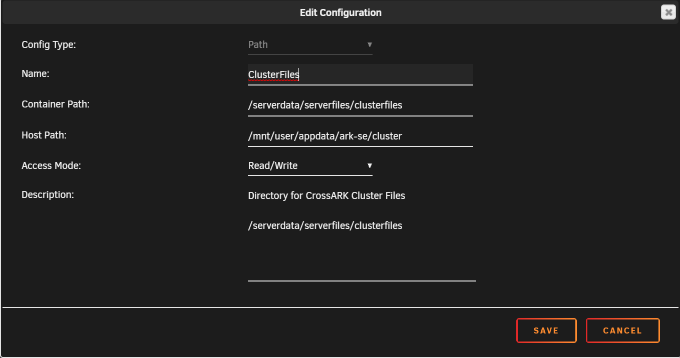

What did you use for settings to get them in a cluster?
1.  Make sure your different servers are up and running, and that you can see them all at the same time from your in game server browser.
2.  Add a new path to the docker settings for the Cluster directory.  This should be pointing to the same directory for each of your servers:
3.  Add the Cluster ID and Cluster Dir Override flags to your Extra Game Parameters field.  I use "call1" for my Cluster ID, but this can be anything you prefer.  My flags look like:
-clusterid=call1 -ClusterDirOverride=/serverdata/serverfiles/clusterfiles
Edited by bubo

I am just allowing Docker to manage core allocation.  What I'm observing is that after the server finishes startup procedures, each map is consuming less than 0.5% on idle and less than 2% on load (it's just me and my boys playing).  My concern is more the RAM usage.
I used /mnt/user because that was the default in this Docker, and I wanted the cluster directory to be in the same directory as the map serverfiles.  I don't know if there is a significance between /mnt/user and /mnt/cache in this usage scenario.
/mnt/cache/appdata will create a directory on the cache if your appdata is located on the aray (i think that's not in many installations the case)
/mnt/user/appdata will take the configured settings and disks on the shares tab for the appdata folder

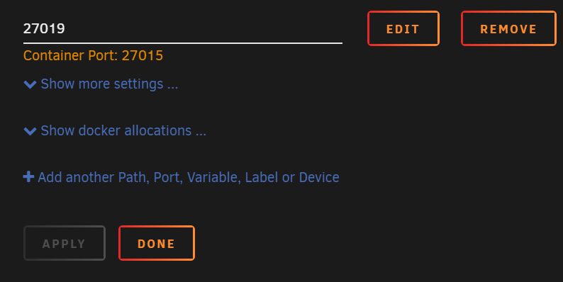

I have  request for your Ark SE docker xml file, can it be more flexible in the ports.  I want to set up a cluster and in order to do that, I discovered that the container port and external port needs to be the same, and on your template you have it greyed out so we cannot change it.  Can you adjust so that the user can change internal port also.
41 minutes ago, deaerator said:
@ich777
Sorry but thats not me who grays out the port numbers, thats a common behavoir.
Btw have you read the description of the first udp port? It says that you must delete the port and create a new one (if you do that and start the docker edit the docker again and you will see that the port that you've created is greyed out too).
Please read corefully the discription of my dockers that's allready a part of the discription of the ports ;)
I can't do anything about this behavoir, thats why i wrote it in the discription of the port. ;)
(Btw i wrote this to the discription for the udp ports for all my dockers)
In other words, delete my port, create a new one with the right protocoll and the right port numbers and you're good to go. ;)
Edited by ich777
Adding on to what ich777 said, when you change the ports it is in your best interest to recreate all four ports.
The UDP ports are needed to connect to the game.
The RCON port technically is optional, but if you want to use any RCON tools then they are needed.
Steam UDP technically works with the internal ports all set to 27015 in the sense that you can see and connect to your server when you are browsing for your server.  However, CrossARK transfers cannot see the other servers if their Steam UDP ports are the same as the map you are currently on.  If you can see your server from the initial connect screen but cannot see the server for CrossARK transfer after setting the ClusterFile correctly, then check to make sure the Container Port for Steam UDP is not the same on both maps.
Edited by bubo

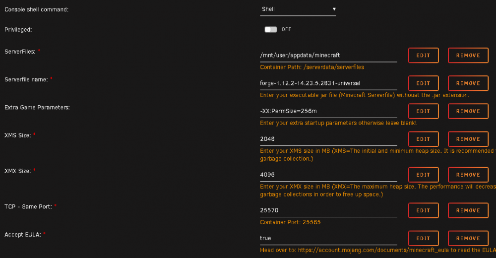

included my docker setup too. Thanks to anyone who might be able to help! :)

@henkim21 For me the server works just fine, here is my configuration from the docker, have you also put in the Extra Game Parameters?
What i've done:
  • Install the docker and change the serverfilename to: 'forge-1.12.2-14.23.5.2831-universal' (configure the ports to your needs and set Accept EULA to 'true')
  • After the docker installed the runtime and displays a error in the log stop the docker
  • Delete the minecraft.jar that the server downloaded.
  • Download and install your modpack: Link
  • Edit the docker again and fill Extra Game Parameters with: '-xx:PermSize=256m' change the XMS and XMX Size to '2048' and '4096' and click on 'Apply' (everything without quotes).

17 hours ago, ich777 said:
I will look into this in a few hours.
What i've done:
  • Open the logs and wait for it to say something about the EULA and that you should restart the docker again.
  • Restart the Docker ;)
  • ...and Boooom there you go... it works (in my case) :D
Try these stepps and report back.
Just tried these steps. Thank you for your support, really appreciate. I copied my files over and when I start the docker, it keeps trying to download a new version of the MC server executable even though I've got minecraft_server.1.12.2.jar in the folder... :(
Log:
---Checking for 'runtime' folder---
---runtime folder found---
---Checking if Runtime is installed---
---Runtime found---
---Checking for Minecraft Server executable ---
---Downloading Minecraft Server 1.14.1---
---Something went wrong, please install Minecraft Server manually. Putting server into sleep mode---
When you say download and install your modpack, I am just downloading the serverpack and copying it over.  Does that mirror what you did in that step?
Edited by henkim21
Yeah then you've don't edited the serverfilename like i mentioned above (it must be the named like the forge jar). But you've also got the forge jar in the folder?
Are you sure you've downloaded the server and not the client version?
Please try to download the version that i've linked above.
Do everything step by step then it should work just fine.
Edited by ich777
Download it from the link that i've provided and extract it to the server directory (be sure that you've once started the docker and do it's thing, than there will be the error that something went wrong, stop the docker, delete the server.jar in the docker, extract the downloaded serverfiles to the server directory and start the docker - please be sure that you edited the settings on the dockerpage right!)
yes thats exactly what i've done. bothe forge....jar and mincraft_server.jar is in ther. that's how it came in the serverpack from the download link. the docker setting is matching the forge...jar
Can you please post a few pictures from your docker template screen and also from ypur server directory.
I have no problem with this modpack and didn't understand why it doesn't run on your unraid server.
