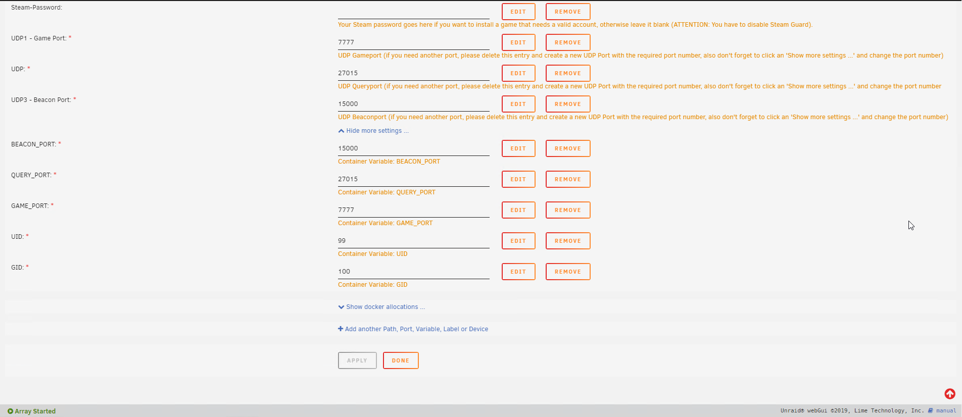

Hi, @ich777!
Thank you so much for all these game server dockers, they're incredible. I'm fairly new to Unraid and it's clear you've done a lot of work on these templates.
I'm having a little trouble getting a Mordhau server up. I thought I'd done everything right, but I cannot join the server at all. It does not appear on the server browser, and I cannot connect to it directly from the console. Here's a screenshot of the running docker. I can see the server is running from the log, but I cannot connect to it.
I have those ports open in my router, but even if I didn't I can't even connect locally.
Any thoughts? Let me know if you need additional info, I'm not fully sure what you need from me for troubleshooting :)
1 hour ago, LeJoker said:
Hi, @ich777!
Thank you fo using my dockers. ;)
Can you post a picture from the port forwarding from your router/firewall?
Wich ISP are you using?
I think there is something wrong with the forwarding, have you changed anything else in the docker?
Edited by ich777

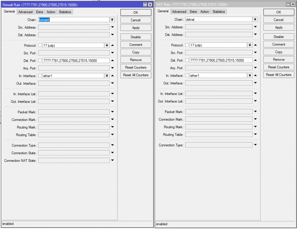

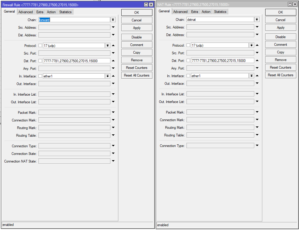

Thanks for the quick reply, @ich777!
I didn't change anything inside, I used it as-is from the plugins installer.
I'm 100% sure it's not my firewall configuration, since I can't connect locally, which doesn't go through the firewall. Windows firewall on the client-end PC is off completely. My other docker containers all work fine (Plex, for example) but with the Mordhau container, I needed to use "bridge" mode, whereas all my other containers use "host" mode, which seems to be doing some translation to an internal IP on the container. When I tried to use "host" mode on the Mordhau container, it did not translate *any* IPs/ports. (The column was empty) I'm *guessing* it's to do with that, but I've no idea!
For good measure, here are my firewall rules. I know those aren't the issue, but I'm also in tech support and I know I hate when people ignore my troubleshooting requests because they "know" better.
The left window is the firewall rule, which allows the connection past the firewall. The right window is the NAT rule which forwards it to my Unraid server. (This was adapted from another Unreal Engine game, hence the additional ports). These rules only apply to connections coming in from my ISP though. Local connections do not go through the firewall.

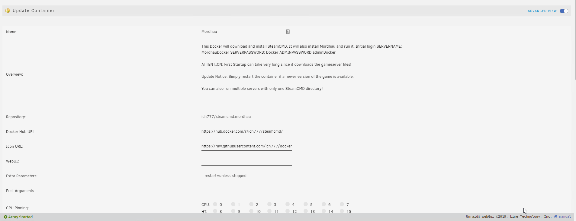

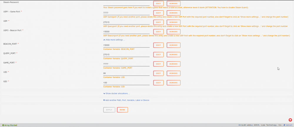

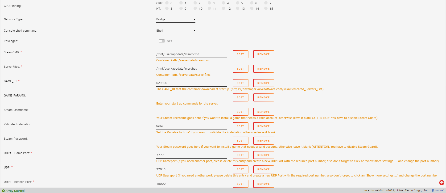

Here's a few screenshots I took of the actual docker container config, in case that helps as well.
No that's fine, change it to host mode and all ports will be forwarded to the host (nothing shows up because i don't expose the ports in the docker for easier host mode like in your case - one thing is the steam query port you can't nat that it has to be the port that you specified eg: 27015 has to be 27015 and not 27016 or another number).
That's really strange i can set it up on my server if you want and you can try to connect in bridge mode and in host mode if you want...
But give me some time, weekend is family time for me and i've got little time on the weekends.
Also i don't know your firewall. Haven't you specified a ip for the ports to forward?
Edited by ich777
Sure, if it works for you maybe I can copy your settings, too.
Since my last post, I have tried both in bridge and in host, and I've also added in my steam user/pass in case that was warranted. Still no dice. I'm sure it's me doing something wrong, I'm pretty new both to Unraid and to Docker.
Yeah I do forward it to an IP on another tab not shown in the screenshots. The ports are forwarded to my Unraid server IP.
