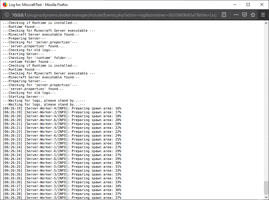

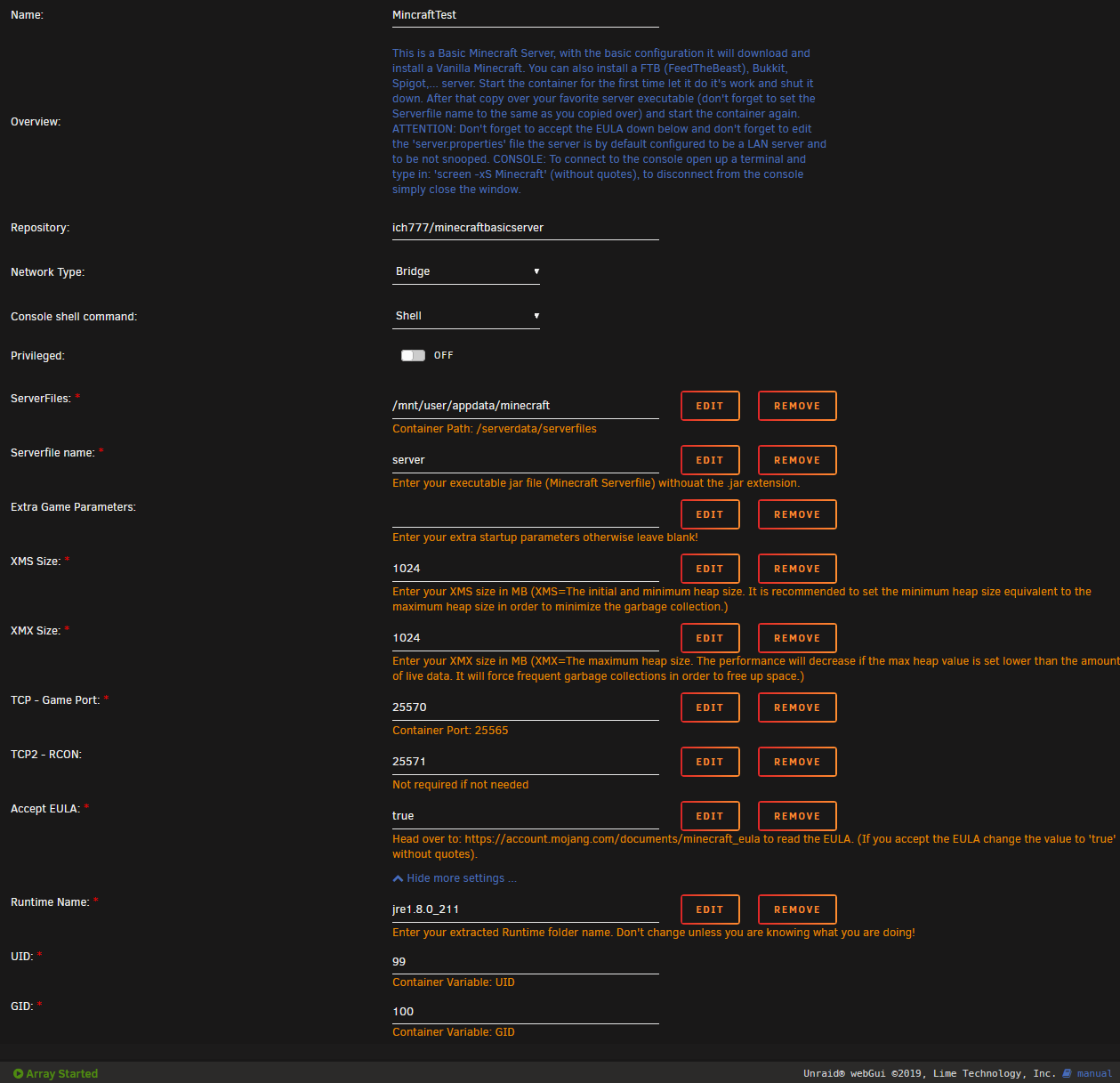

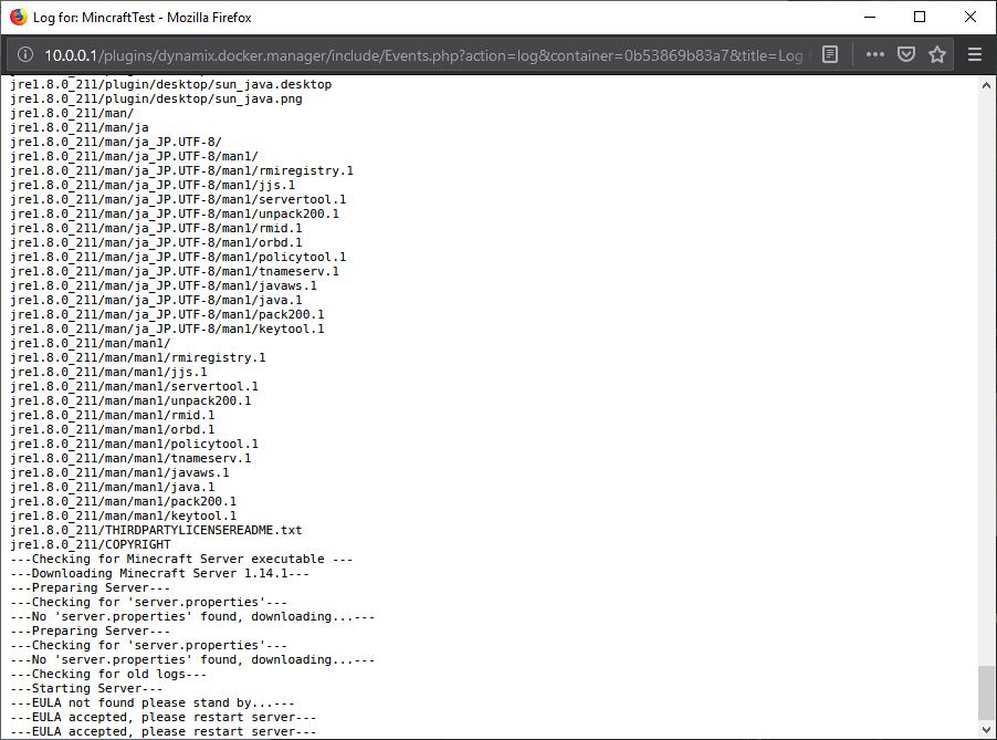

5 hours ago, SH4LT1S said:
I checked the folder, it is inside. Did not change name.
No problem here, Screenshot of first start:
Screenshot after accepting EULA:
Screenshot from Docker page:
Please post a screenshot, this error means that the server can't find the java executable. Change you something else? Without more info troubleshooting is really difficult.
Did you use a Mac and copied something to the server directory from a zip file or somithing like that?
Edited by ich777

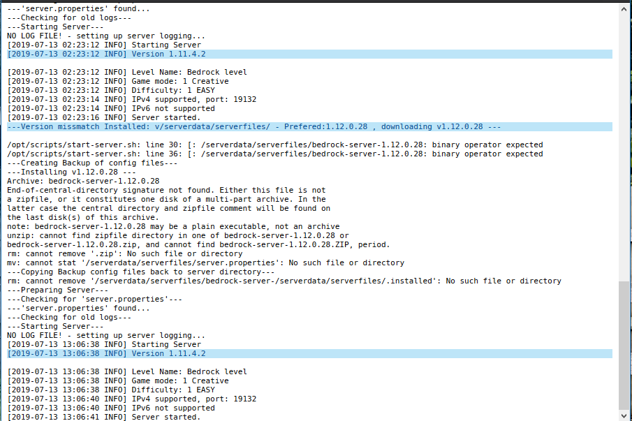

First, awesome job on the "MinecraftBedrockEdition" container, it's been working great.  I do have a question on updates.  Since the latest server version is 1.12.0.28, I updated the "Game Version:" parameter to match, but it cannot pull the zip file.  It does try per the logs but once it cannot find it, the container defaults back to 1.11.4.2 giving a server mismatch with the client.  Do I need to take additional steps here?  Any advice?  TIA!
I will look into this as soon as possible please give me a few days.
