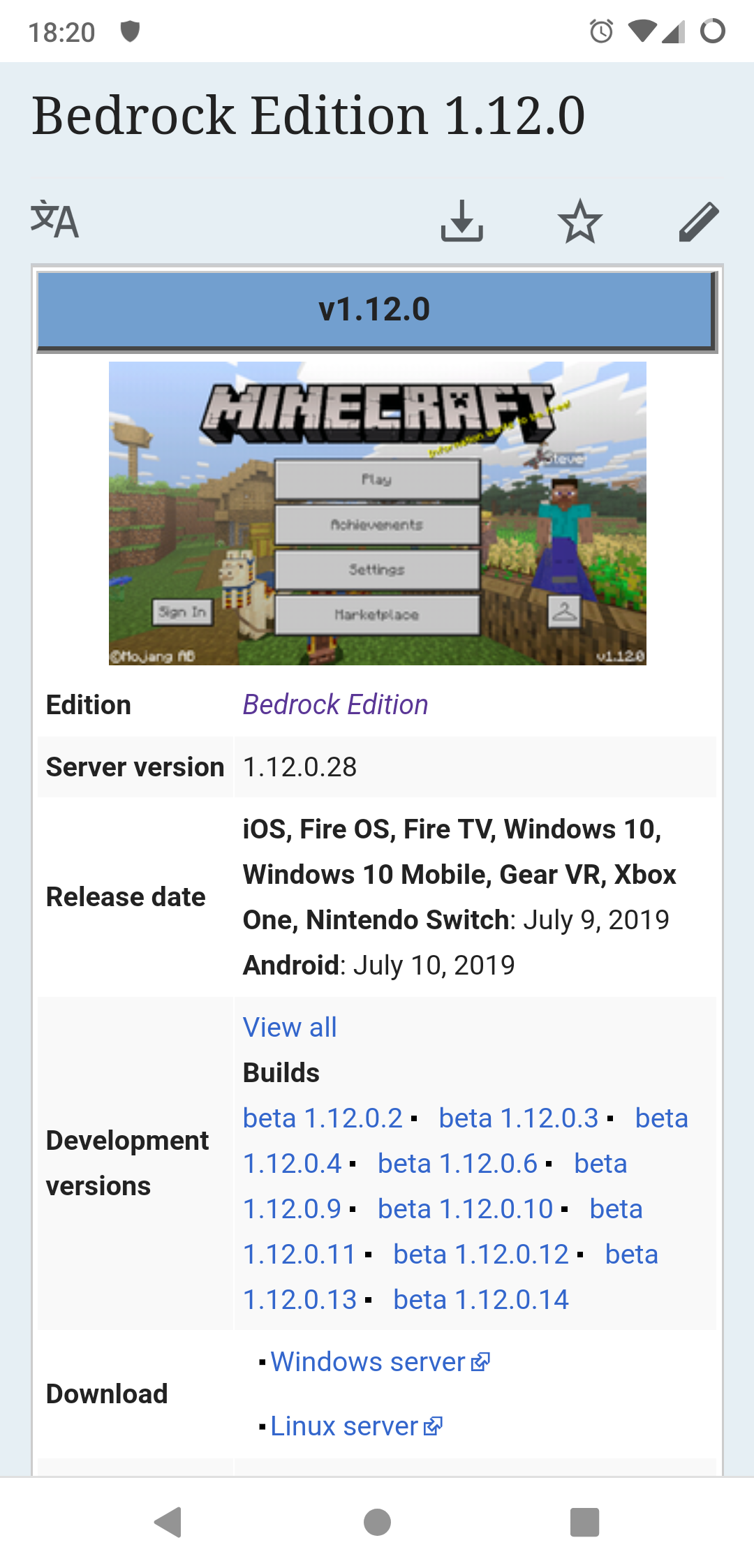

I have been trying to get the Minecraft Bedrock version to work, but Minecraft on Win10 bedrock always kicks back saying it is out of date. In the docker set up I have entered 1.12 (I think thats the most recent..?) and it still is showing up as out of date. Do I need to adjust that somewhere else?
According to the wiki the latest server version is 1.12.0.28.
EDIT: Tested it and it works with version 1.12.0.28
Edited by ich777
So I just install the docker, with 1.12.0.28 in the docker settings and then do I need to run any other settings for it before getting it to work? I have not set up a minecraft server before, not sure if there are other settings I need to fix first. If there is a directions page or readme I am just missing, please let me know.
