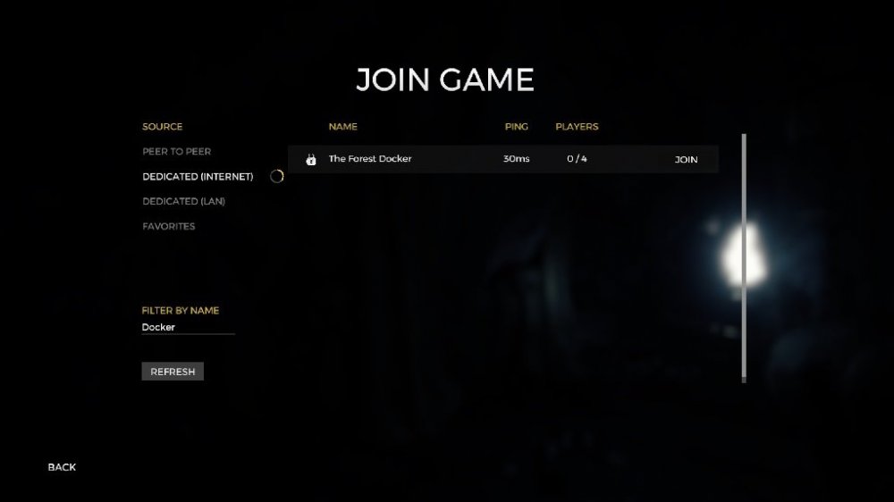

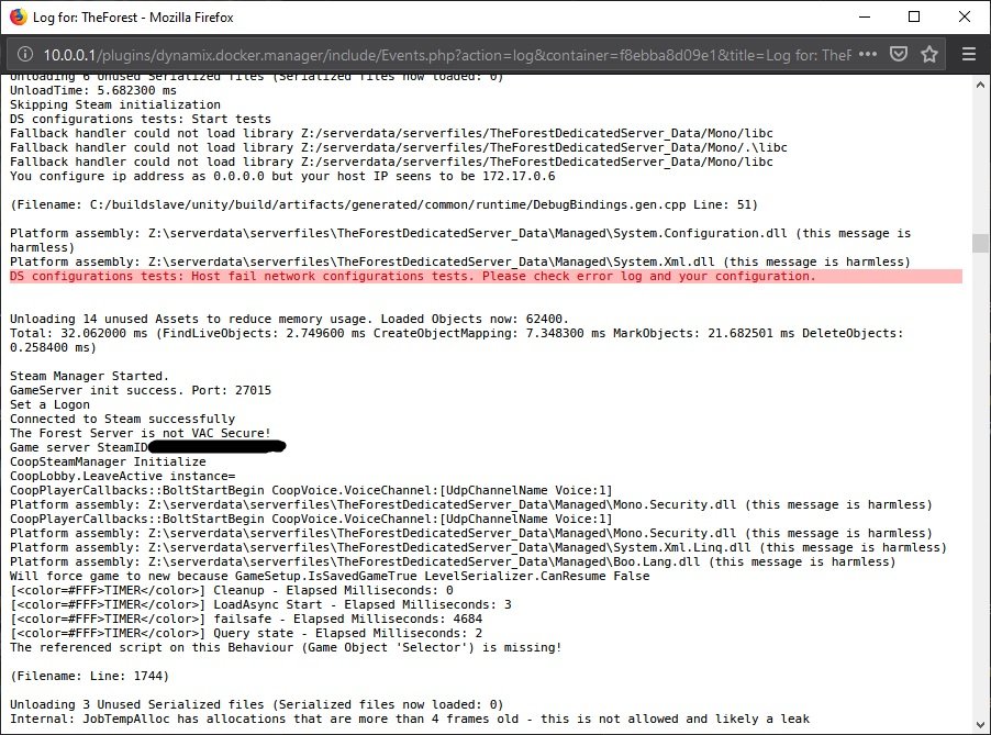

So I'm trying to start The Forest Server. I am trying to make it a public server. I've forarded the appropriate ports, but when I try to use the '-serversteamaccount YOURTOKEN' to the GAME_PARAMS, the log then says it's failing to connect to steam.
The part that shows it fail is this part of the log.
DS configurations tests: Host fail network configurations tests. Please check error log and your configuration.
Unloading 14 unused Assets to reduce memory usage. Loaded Objects now: 62400.
Total: 32.025799 ms (FindLiveObjects: 2.936700 ms CreateObjectMapping: 8.068200 ms MarkObjects: 20.739500 ms DeleteObjects: 0.270400 ms)
Steam Manager Started.
GameServer init success. Port: 27015
Set a Logon
Failed to connect to Steam
This is from the connection log:

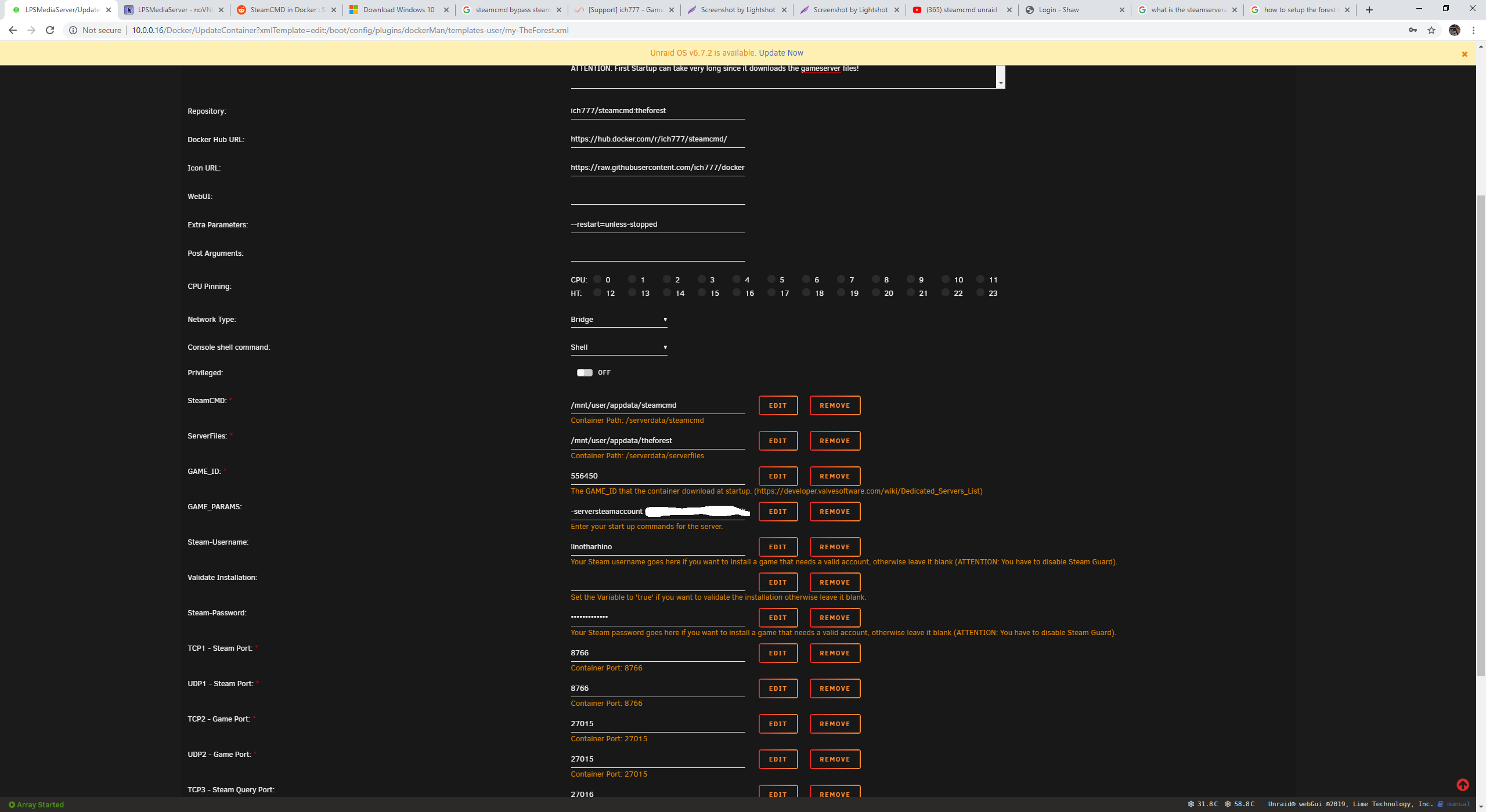

I've also attached my setup of the Docker in the attachments.
Set a Logon
I will take a look into that when i got home.
But it should work fine if you forward all the ports from the container TCP/UDP in your router/firewall.
Please note that this container is BETA since it's running WINE it's a little buggy but should work fine.
Edited by ich777

I think I have the same or similar issue as @lionel.pereira85 Tried all night to install this server and it kept erroring out on something like "Wine: cannot find TheForestDedicatedServer.exe" so I reinstalled it and let it sit and still nothing. So I just downloaded those files from Steam and copied them to the location it was looking for, everything seemed to be discovered. Now I am having Steam Guard and login issues among other things. Temped to just turn off steam guard as it keeps asking me to enter the code, not sure how I can enter the steam guard code via console inside UnRaid though.
Thanks for any help on the matter!
@lionel.pereira85

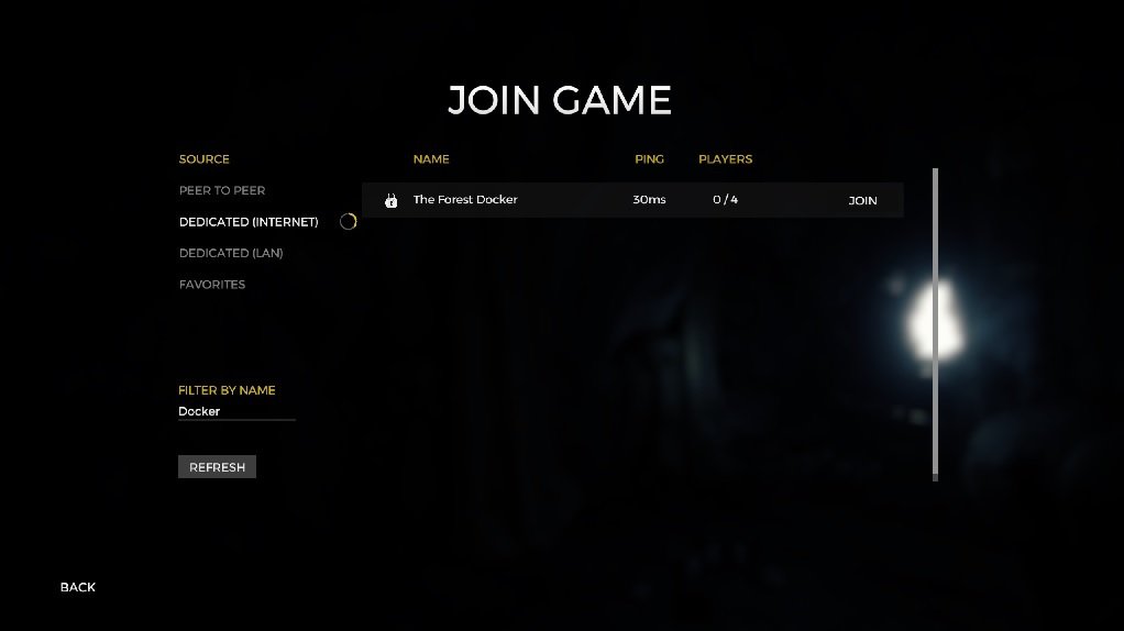

First of all this Docker need no username and password provided to download the files for The Forest. It's based on the APP ID: 556450 see here: *click*
The Docker works just fine, but please note that you must generate a token for APP ID: '242760' <- this is The Forest (not for APP ID: '556450' <- this is The Forest Dedicated Server) - allready updated the Template with this info - and you must open all the ports that are set in the docker in your router/firewall both TCP and UDP.
Then the log should look like this if it can connect to steam:
If the game can't connect to steam there will be an error in the line where it says above 'Connection to Steam successfully'
And finaly you can join ingame:
Edited by ich777
5 hours ago, ich777 said:
@lionel.pereira85
AWESOME!!! I got it working!! Thanks! I appreciate it!
