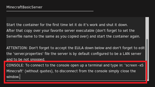

I just installed the minecraft basic server docker and I can't figure out how to make players operators.
With the console, have you read the discription of the container?
In the Docker section of Unraid leftclick on the Minecraft container -> Console (a new windows open's) -> type in 'screen -xS Minecraft' (without quotes, now you're connected to game console and now type in 'op [nameoftheplayer]' -> you've OP'd someone. When you're done simply close the window.
Edited by ich777
