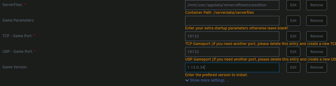

Hello i cannot update the Minecraft server.
The client says that the server version 1.12.0.28 is outdated.

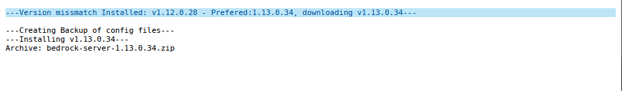

When i stop the server, to change the game version to the newest (1.13.0.34) and then start it again, it says:

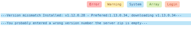

---Version missmatch Installed: v1.12.0.28 - Prefered:1.13.0.34, downloading v1.13.0.34---
---You probably entered a wrong version number the server zip is empty---
How can i solve this problem?

Your server can't download the file, that's the only thing i can say, i've downloaded it also and it works fine oob.

Please check if you got any space in the version number (in front or at the ending).

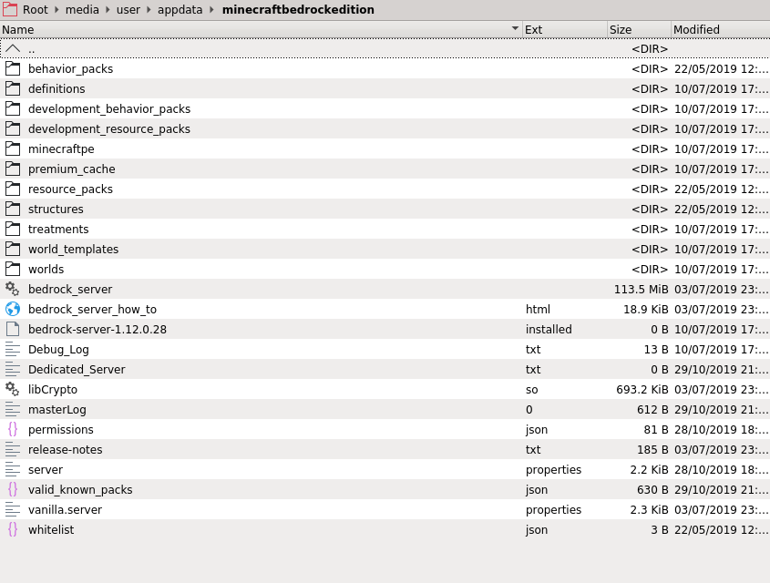

Also please check if you got a bedrock-server-1.13.0.34.zip in your main directory, if you it's in there delete it and restart the container.

There is no bedrock-server-1.13.0.34.zip-file in the main directory:
and there is also no empty space between the numbers:

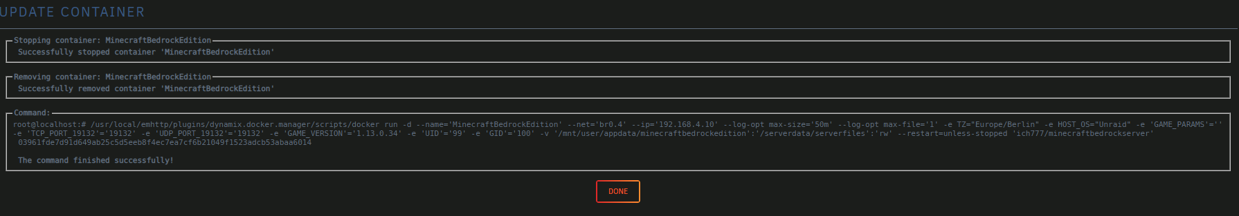

When i hit "apply" then this is showing up:
and the log:

It seems that your server can't download the executable, it get's it from here: Click
(This is the direct link to version 1.13.0.34)

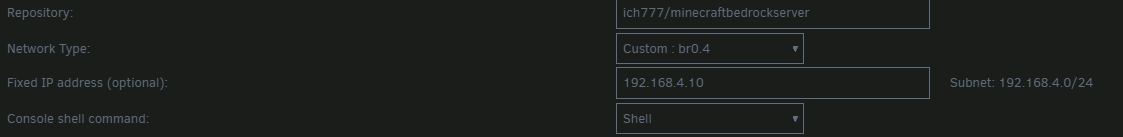

I found the solution...
There was an issue with my VLAN and some PfSense-firewall permissions that i dont understand xD.
I changed the network type to "bridge" than the update ran fine. After that i switched back to the VLAN.

Fine, like i've said, the container couldn't download the zip file.
Hope it all works now. ;)
