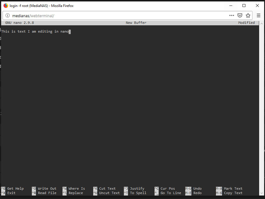

Unfortunately I don't know what nano is. haha. Crap.
nano is a Linux text editor.  Open a terminal window in the unRAID GUI and type 'nano' at the command line.
ahhhh. I've used it before. It has just been a long time. Thanks. I'll see if I can figure this out.
