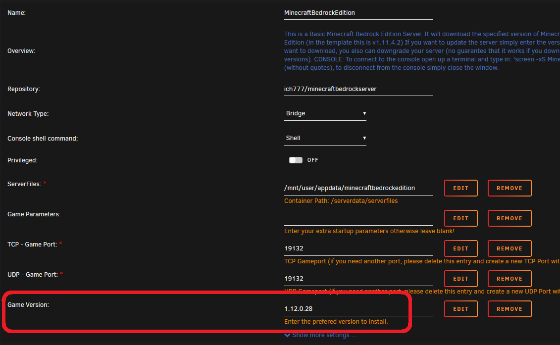

Sorry but can't reproduce this behavour, can you please post a picture of your minecraft-bedrock directory and a picture from your docker configuration page?
EDIT: Got it, is it possible that you've got a [space] at the end of the version number?
grafik.png.53546de14ac5a876b38fa4164b596bf3.thumb.png.50634d85e7df8a34dad1069a29e29ea5.png

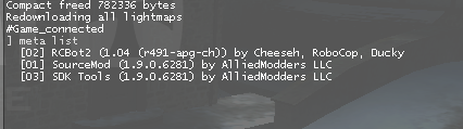

...the two MetaMod Source plugins that did load there is Sourcemod and SDK tools and it works perfectly.
The rcbot2 VDF file at the time of that console output was ...
The SourceMod VDF that did load is...

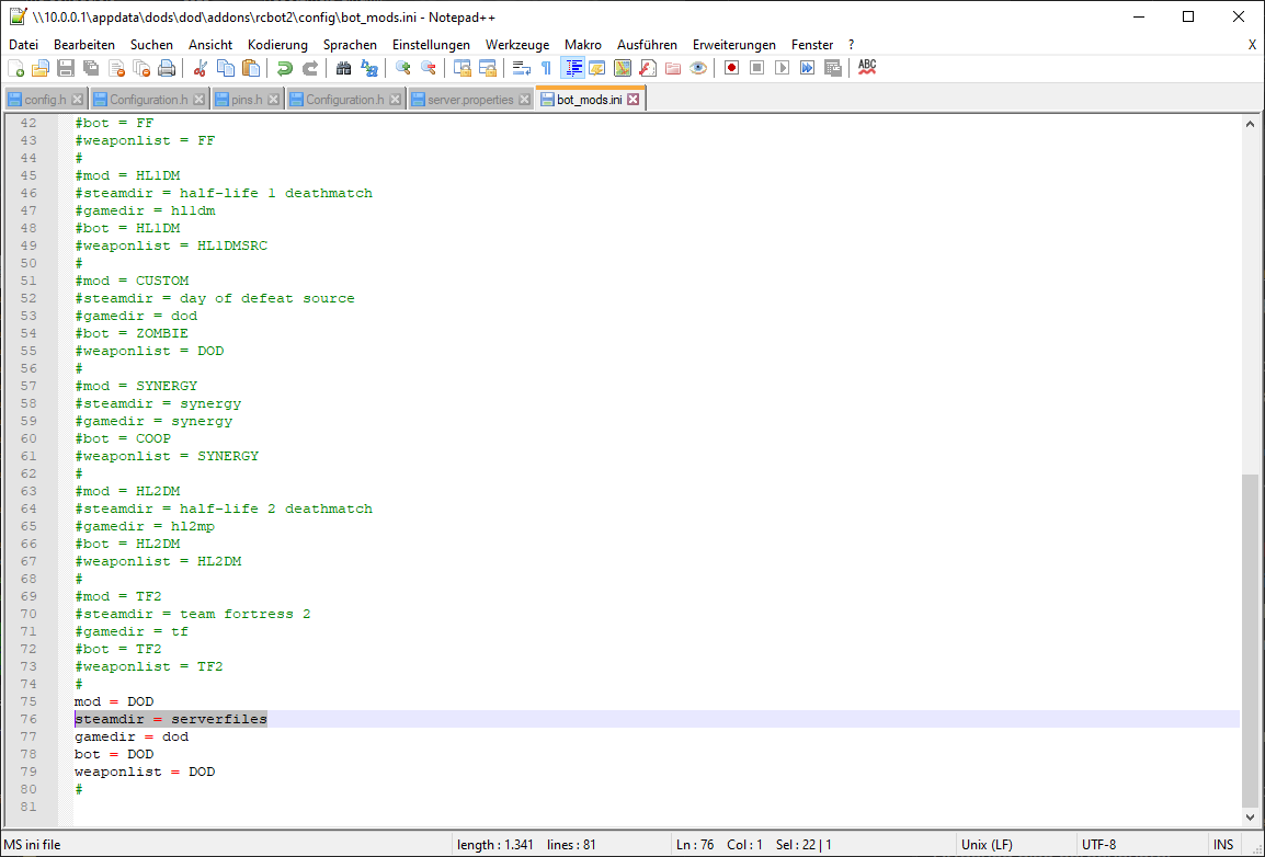

I think the error is path related, but not sure why, hence the actual files used (in the now fixed link) may help.
Go to your server directory into dod/addons/rcbot2/config (in my case appdata\dods\dod\addons\rcbot2\config) and edit the bot_mods.ini.
Go to 'mod = DOD' and change the steamdir from 'dods' to 'serverfiles' and the mod should load just fine.
Attached also screenshots:
Yep, worked, the explanation makes sense it was a naming issue after all, it helped me understand a little more on the volume mapping as well.
Just for others if you install RCBot2 for TF2, HL2DM or DoD:s...  there is also another folder to rename or the bots will not follow waypoints.
The waypoint folder also needs the "serverfiles" rename...
Rename.... appdata\dods\dod\addons\rcbot2\waypoints\dods to  appdata\dods\dod\addons\rcbot2\waypoints\serverfiles
Bots will now follow waypoints.
