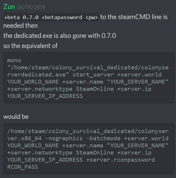

17 hours ago, bubo said:
Hopefully @ich777 can look at this, but this summer has him short on time.
I don't play Colony Survival myself, but a quick look at today's update indicates that it was a significant overhaul including an upgrade from the 2017 Unity version to the 2019 Unity version.  Can you look in your directory to see if "colonyserverdedicated.exe" is present?  I suspect either corruption during the download, or it was renamed as part of the change to the 2019 Unity version.
There isn't a file with that name. These are the files that exist.
colonyserver.x86_64*  colonyserverrcon.exe*      gamedata/  masterLog.0       steamapps/
colonyserver_Data/    colonyserverrcon.exe.mdb*  linux64/   steam_appid.txt*  steamclient.so*
OK, again I don't play this game so take my advice with caution.
Linux64/ is a folder, so can you check inside there as well. If the colonyserverdedicated.exe file is not in there, then it looks like your download had an issue. Inside the Docker configuration there is a field for "Validate Installation". Type "true" in that field and it should check the files then attempt a new download. If that works, then don't forget to remove true afterwards or it will check every time the Docker starts.
The only file in the linux64 folder is a file named "steamclient.so*". I also have validate installation set to true and have removed and re-"installed" the container, along with also removing container with image to do a full redownload.
OK, I went ahead and installed the docker myself just to see what files are pulled.  My installation of the Colony Survival server also does not have the colonyserverdedicated.exe file.  I tried to find a file manifest, and according to SteamDB the new release does not have colonyserverdedicated.exe as part of the distro from Steam.
I'm not sure if colonyserverdedicated.exe is supposed to be generated out of the distro, or if the developers for Colony Survival have changed how the dedicated server is setup.  I did find that others are looking for instructions for 0.7.0 as seen on Reddit.  Again, I don't play this game so I can't say I'm correct, but I'm leaning towards a change from the developers of Colony Survival.  Can you check the Colony Survival community to see if anyone has had success with a 0.7.0 dedicated server?  We would need to know the command line they are using with 0.7.0 (and if their command line uses colonyserverdedicated.exe then ask if they can tell you what path it's supposed to be located at).
Once we can confirm how 0.7.0 is supposed to launch the server, then we'll have to wait for @ich777 to have time to rebuild the Docker to match it (assuming there is a new method other than colonyserverdedicated.exe).  Doing these checks for him should reduce the time/load needed to get it working.
I couldn't leave it alone, so I hopped into the official Discord for Colony Survival.  I found that the new launch file is colonyserver.x86_64 so we will need for @ich777 to adjust the script inside the Docker to point there.
Edited by bubo
Holy cow, thanks a bunch for looking into this as deeply as you have. I figured it had to do with the major update.
