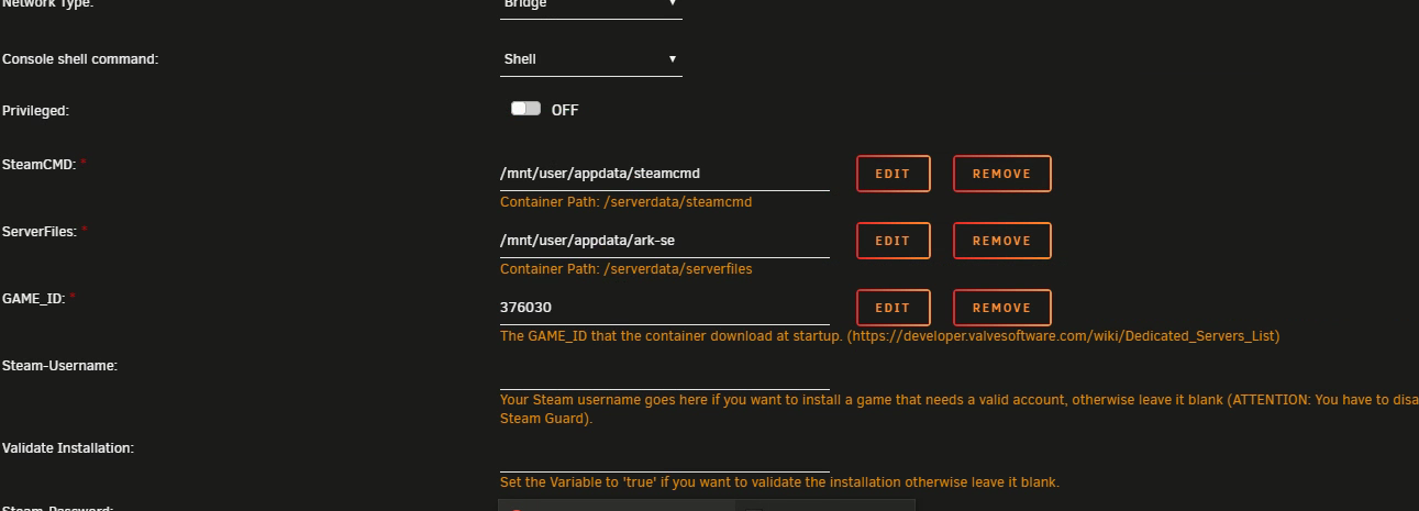

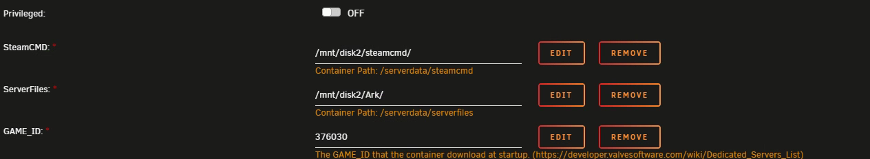

I am also testing out the Ark docker- it does not look like it respects the file locations for steamcmd and serverfiles directories.  I have them mapped directly to one of my disks but the share is empty and docker still contains all the related files.
This should work, no?
Don't know what you exactly mean, you must set the path on first creation of the docker otherwise it will not work correctly (on the first start all dockers, not only mine, will create the required directorys and permissions for the folders and files needed).
Delete the docker completely and map them when you install the docker.

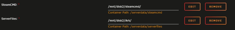

That is what I am doing during the install:
Before:
After:
Then checking those shares- there is nothing in them and they put everything in the container- maybe I am just used to steamcache docker that allowed me to pick a disk location for all the data.

Sorry but what do you mean 'put everything in the container'?
Delete the container, then install it new and set the path's to where they should be (think /mnt/disk2/steamcmd - btw never write direct to a disk everytime to 'user' and then to a share, if you write direct to a disk the parity won't work!) <- read this.
To check if everything is ok just turn on 'Advanced View' in the Docker page on the right upper corner.

Not sure exactly what I did wrong, but deleted and set it back up and it did put the files in the correct place this time.  Don't care much about parity- I have scheduled backups that take care of data security.  Nothing runs 24/7, just have 4 gaming computers used on demand.
