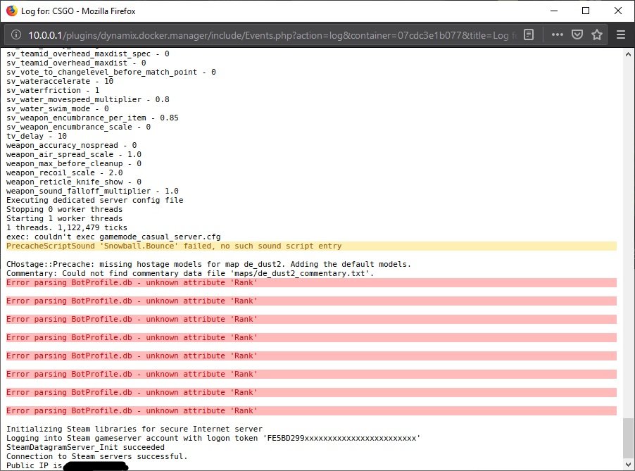

On 4/26/2019 at 4:10 PM, ich777 said:
Wich token?
Is the container running? What does the log say?
Edit: Can you connect when you enter the IP:PORT in CS GO?

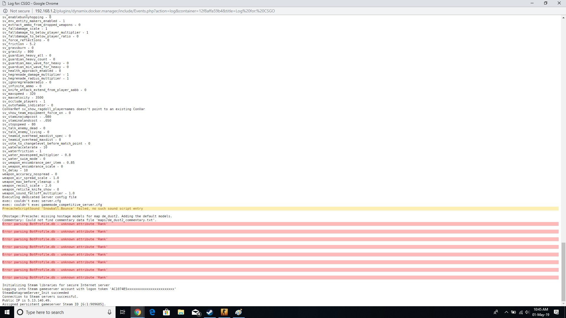

i create on dis link https://steamcommunity.com/dev/managegameservers
the container is running

On 4/28/2019 at 4:47 PM, ich777 said:
@EamonMcM Tried the container and it works without any problem.
How did you set the token? Did you know that every server needs it's own token? Are all the ports open and have you forwarded them in your router properly?
Please add this to the end of the start parameters:
+sv_setsteamaccount YOURTOKEN
Replace YOURTOKEN with your token ;)
Your log should then look something like this:

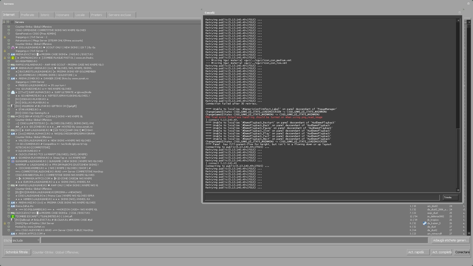

use google translate becoze my english to rith is veri bad Romania
Eu detin un server de cs go care ruleaza pe un PC cu windows os .
aproape 6 ani detin server CS 1.6 si de 2 ani CS GO
acelasi server a fost pus si pe unraid windows VM  merge ok  dar foloseste foarte multe resurse .
acest docker nu merge , nu stiu cum la tine merge !!??
in log imi arata ca merge si care este ip-ul dar din joc cs go nu se poate conecta
de port foword nu se pune problema ca este facut corect
Am atasat poze pentru a dovedi

I found the solution
studying the files in the running server I found some missing files in the docker server, I copied those files and it all works ok
is not a docher error , is an error at steamcmd

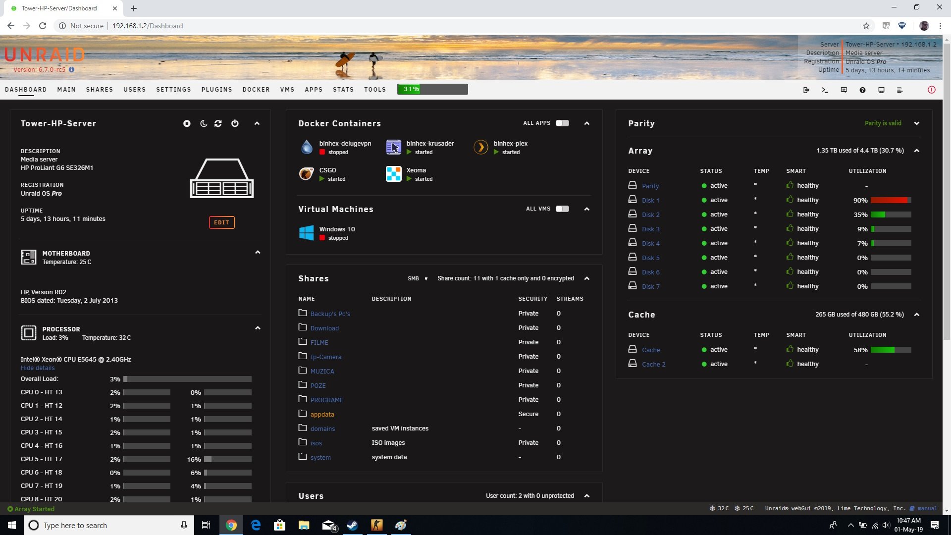

18 minutes ago, yellowcooln said:
Unrelated to the topic,
These are the RC builds of unraid.
