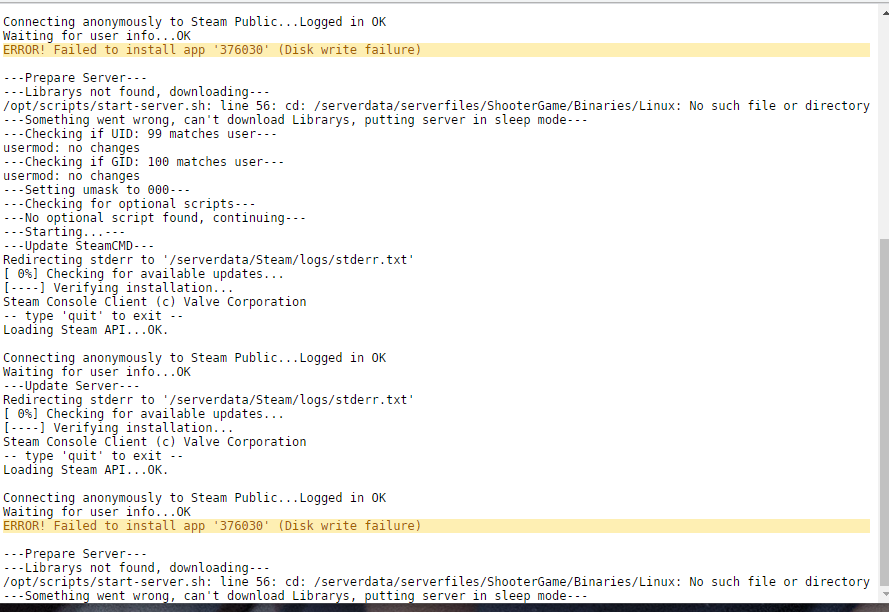

6 minutes ago, audioclass said:
Edit:  The weird part is that the container MADE these folders successfully, and was able to download/extract all of the info to steamcmd folder without trouble.  I'm lost haha.
Is your Cache actually called cache?
What are the path mappings in the template, are they matching or pointing to the right direction (usually I use /mnt/cache/... in my containers instead of /mnt/user/... because some games won't work with /mnt/user/...).
  • Replies 12.6k
  • Views 2.2m
Yes, the path /mnt/cache/appdata/conanexiles exists, as does the /mnt/user/appdata/conanexiles.  I have tried both just in case.  Here is a screencap of the docker settings screen.  I believe it is mostly default aside from having swapped the /serverdata/serverfiles/ path back and forth between /mnt/user and /mnt/cache during this troubleshooting process.
Sorry if the image is huge, 4k monitor:
Edit: Also, if it is worth mentioning, the rest of my containers are working alright(nextcloud, mariadb, sonarr radarr etc.), updating fine and such.  And, my valheim server worked fine in the past, but has the same symptoms as this conanexiles container now.
Edit 2: I also just noticed I appended / to the end of conanexiles, but not steamcmd.  I tried removing this just in case that was somehow causing problems but the issue persists.
Edited by audioclass
Are there any important save files on there? Have you tried already to wipe the containers, including the game directories in your appdata (Valheim has also a automatic backup function so that you can extract the save files from there) and download a fresh copy from the CA App?
This is really strange and I've never experienced anything like that... :/
10 minutes ago, audioclass said:
Sorry
May I ask why you run the container Privileged?
Yes, I have tried removing the containers, and completely deleting the associated folders (steamcmd, valheim(after grabbing a backup) and conanexiles) before grabbing a fresh container from CA.  Sadly even this seems to have no effect.  Is it an issue with my appdata folder itself perhaps?  I'd prefer not to wipe that out if possible, but it is seeming more and more likely :(
Oh, that was only done because of this issue.  I tried running as privileged just in case that was the cause, but as you can see, it wasn't 🤣
It can't be solved

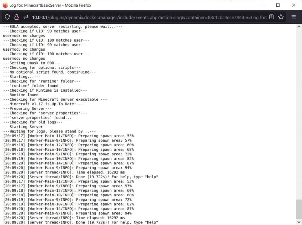

Hey
I just tried making an 1.17 minecraft server with the minecraftbasicserver docker.
I am getting the following error:
Error: A JNI error has occurred, please check your installation and try again
Exception in thread "main" java.lang.UnsupportedClassVersionError: net/minecraft/server/Main has been compiled by a more recent version of the Java Runtime (class file version 60.0), this version of the Java Runtime only recognizes class file versions up to 52.0
        at java.lang.ClassLoader.defineClass1(Native Method)
        at java.lang.ClassLoader.defineClass(ClassLoader.java:756)
        at java.security.SecureClassLoader.defineClass(SecureClassLoader.java:142)
        at java.net.URLClassLoader.defineClass(URLClassLoader.java:468)
        at java.net.URLClassLoader.access$100(URLClassLoader.java:74)
        at java.net.URLClassLoader$1.run(URLClassLoader.java:369)
        at java.net.URLClassLoader$1.run(URLClassLoader.java:363)
        at java.security.AccessController.doPrivileged(Native Method)
        at java.net.URLClassLoader.findClass(URLClassLoader.java:362)
        at java.lang.ClassLoader.loadClass(ClassLoader.java:418)
        at sun.misc.Launcher$AppClassLoader.loadClass(Launcher.java:355)
        at java.lang.ClassLoader.loadClass(ClassLoader.java:351)
        at sun.launcher.LauncherHelper.checkAndLoadMain(LauncherHelper.java:601)
My older server (1.16.5) still works fine. It is using a different port aswell.
It seems the error is related to the java version in the folder. It is a fresh install so nothing from my old server.
Am i doing something wrong?
@audioclass & @tianyun123lo Valve has actually broken SteamCMD on Linux: Github Issue
We'll have to wait until a new version of SteamCMD is realesed or you create the directory "steamapps" manually in the game directory (that is created in your appdata folder for the specific game you want to install) after it failed one time and start the container again, this should fix the issue temporarily too.
Try the following:
  1. Stop the container
  2. Go to your game directory and delete the Runtime folder
  3. Go in the template and click on "Show more..."
  4. Change the Entry "Runtime Name" to: 'jre16' (without quotes)
  5. Click on Apply
On 6/8/2021 at 7:47 PM, ich777 said:
Try the following:
  5. Click on Apply
Thanks for replying :)
I tried what you suggested but i still get the error.
It's a little different:
Error: LinkageError occurred while loading main class net.minecraft.server.Main
        java.lang.UnsupportedClassVersionError: net/minecraft/server/Main has been compiled by a more recent version of the Java Runtime (class file version 60.0), this version of the Java Runtime only recognizes class file versions up to 55.0
I also tried jre 15
Then the error looks like this:
        java.lang.UnsupportedClassVersionError: net/minecraft/server/Main has been compiled by a more recent version of the Java Runtime (class file version 60.0), this version of the Java Runtime only recognizes class file versions up to 59.0
Sorry seen now that you actually need JRE16, pushed an update of the container, do the following:
  2. Delete the runtime folder once again
  3. Force an update from the container
  4. Go in the template and click on "Show more..."
  5. Change the Entry "Runtime Name" to: 'jre16' (without quotes)
  6. Click on Apply
This worked, I stopped the container, added the steamapps directory to the gameserver's appdata folder, restarted and everything seems to be coming online.
  6. Click on Apply
Thank you again
It is working now after updating the docker and following your instructions :)
1 minute ago, Sundur said:
Thank you again
Have to say sorry, wasn't aware that Minecraft 1.17 needs Java16. :)
Also change the template that Java16 is selected by default for no installations, should take a few hours to update in the CA App. :)
Thank you for the report, much appreciated!

Logging in user '' to Steam Public ...
Logged in OK
Waiting for user info...OK
ERROR! Failed to install app '294420' (Disk write failure)
---Prepare Server---
grep: /serverdata/serverfiles/serverconfig.xml: No such file or directory
---Creating SaveGameFolder config ---
sed: can't read /serverdata/serverfiles/serverconfig.xml: No such file or directory
---Savegame location found---
---Creating UserDataFolder config ---
---UserDataFolder location found---
---Server ready---
---Start Server---
/opt/scripts/start-server.sh: line 100: /serverdata/serverfiles/7DaysToDieServer.x86_64: No such file or directory
---Checking if UID: 99 matches user---
usermod: no changes
---Checking if GID: 100 matches user---
usermod: no changes
---Setting umask to 000---
---Starting...---
---Update SteamCMD---
Redirecting stderr to '/serverdata/Steam/logs/stderr.txt'
[ 0%] Checking for available updates...
[----] Verifying installation...
Steam Console Client (c) Valve Corporation
-- type 'quit' to exit --
Loading Steam API...OK.
Logged in OK
---Update Server---
---Validating installation---
---Update Server---
Session terminated, killing shell... ...killed.
I tryed a lot of things.. (Username was delete in this log):(
Please read this post:
Valve broke SteamCMD and there is a workaround in that post.

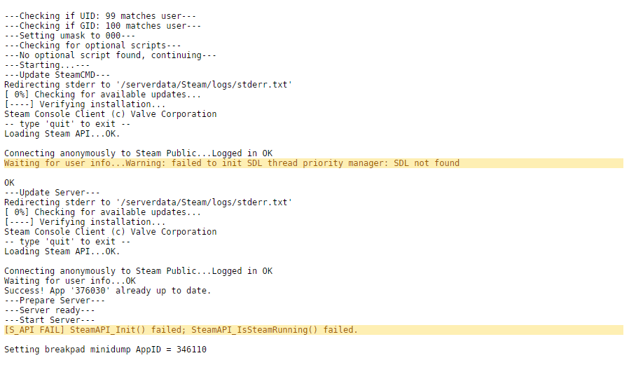

Thank you for your guidance. It has run successfully, but there are new problems. How can we solve them123.png.df4d51097e520b23f3e23539cfc6867b.png
I have used a few of your docker containers and I'm extremely grateful for the work you've done.  Recently I've been hosting a '7 Days to Die' server, and I'm wondering if it's possible to disable auto-updating or to manually switch to the beta branch?  I want to try modded but I need to revert to a slightly older version for this, I'm curious if this is possible.
This is just a Warning and can be ignored the message "Setting breakpad minidump AppID = 346110" is actually the message that the server is started and waiting for connections.

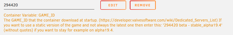

Yes, I have appended this text to the GAME_ID description in the template (if you pull a new one from the CA App):

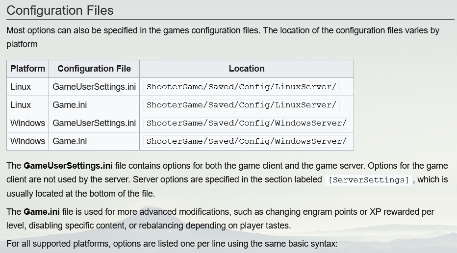

Thank you. Last question, which file is the server configuration file to modify
@audioclass, @tianyun123lo & @Suriniya Valve fixed SteamCMD and installations from game server containers work now flawlessly again when installing games from scratch without the disk write error. :)
To update SteamCMD restart one container and it will update SteamCMD.
Please look here: Click
You can append it to the GAME_PARAMS in the Docker template or you can edit the server configuration itself that is located at (the screenshot is from that site that I've linked - in your case you have to choose the Linux paths):
