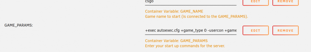

Is it possible to get the CSGO server to run 128 tickrate instead of 64 tickrate?
I have tried add the following to autoexec.cfg
sv_maxrate 0
sv_minrate 80000
sm_cvar sv_maxcmdrate 128
sv_mincmdrate 128
sv_minupdaterate 128
sm_cvar sv_maxupdaterate 128
I have rebooted after editing anything in the config files.
Please help

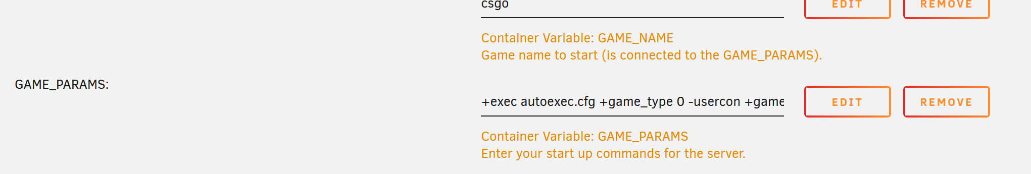

Have you also added '+exec autoexec.cfg' to the GAME_PARAMS? Otherwise the autoexec.cfg isn't loaded:
Im feeling so stupid now, thats the only place i havent tried to look or change anything 🤦‍♂️
I will try that, thanks
