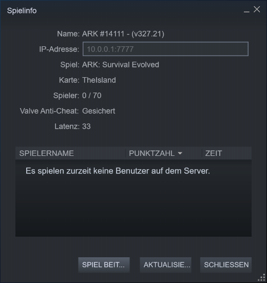

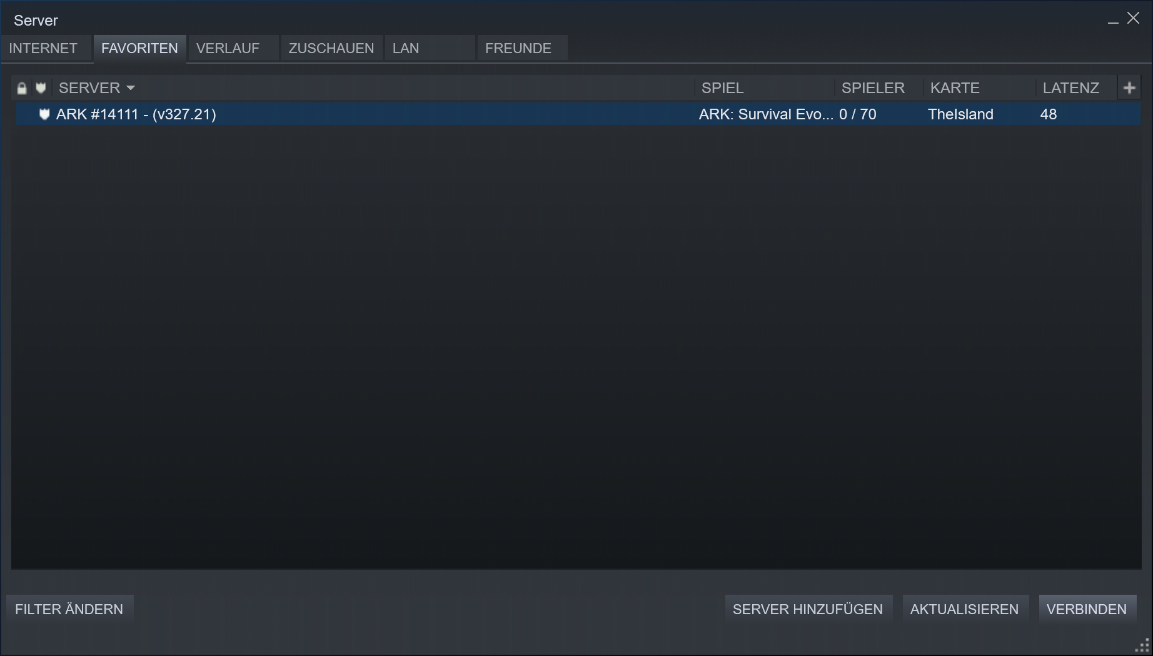

1 hour ago, Ong Hui Hoong said:
i purchase the game from steam, i cannot connect also, this is odd... @_@
Something with your setup is wrong I think, I now tried it and downloaded a fresh copy from the CA App, I can just see it fine from the Steam Server Browser:
...and also can connect to it and play on it.
