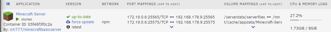

My Minecraft server has a cpu load of around 30% and memory usage of around 2GB:
Is this the usual load? I wonder because there are only 3 players online. Does it mean 10 players will overload it?
Eventually, does the players experience any lag or blocks getting placed or removed with a delay?
For Minecraft you can calculate in the worst case for every connected user with about 1GB of RAM.
I don't ever see a Server is getting overloaded by players but keep in mind Minecraft Java Edition is not very well optimized for Multithreading and prefers speed over core count.
If the players experience, like mentioned above, blocks getting placed or removed with a delay then the server is is actually overloaded and you see messages that say something like: "The server is xxxxx Ticks behind, is the server overloaded?" (these messages can occur really early in the game with not much players connected).
That also depends on the things that the server has to render/calculate (Redstone circuits, animals,...), you can also crash servers with the right Redstone circuits.
Oh I also forget about blowing things up in the game with TNT and calculating the flow of water/lava...
If you have a mod server like Spigot or Bukkit, Worldedit for example can also have a huge impact on the performance when you use it heavily.
Only external players in rare cases, so I think this was related to the internet connection.
Yes, I saw those message. It seems only to happen after a long playing time and it happens even with only 2 players online. It's a little bit strange because the CPU should have enough single thread performance I think.
I will post an update if I ever reach 10 players ^^
