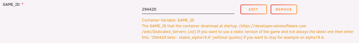

Is there a way to stop the steamcmd from auto-updating the app?  It auto-updated 7 days to die when the docker was restarted and broke our darkness falls + sorcery save.
Actually yes:
You can also join @Spectral Force's Discord for support for my 7DtD container: https://discord.gg/VwwYA5h
