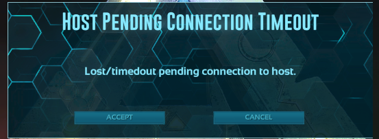

13 minutes ago, ich777 said:
This seems perfectly fine, because 27015 is the Steam server query port so that it can communicate with the Steam servers and it is then translated to 7777.
Have you changed any port in the template itself with another one or is this the default template as it is available in the CA App?
Eventually @Cyd can help with this.
I have now tried it with the bare default template and I can connect fine without a problem, but I also run it in bridge mode.
I used the default template.  I posted a screenshot of my settings above.  All I changed was Name, Validate Installation, & Server Name.
At this point I'm definitely leaning towards it being a network thing.. but I'm not sure how to figure out what's not setup right.
Thanks for your help so far!
