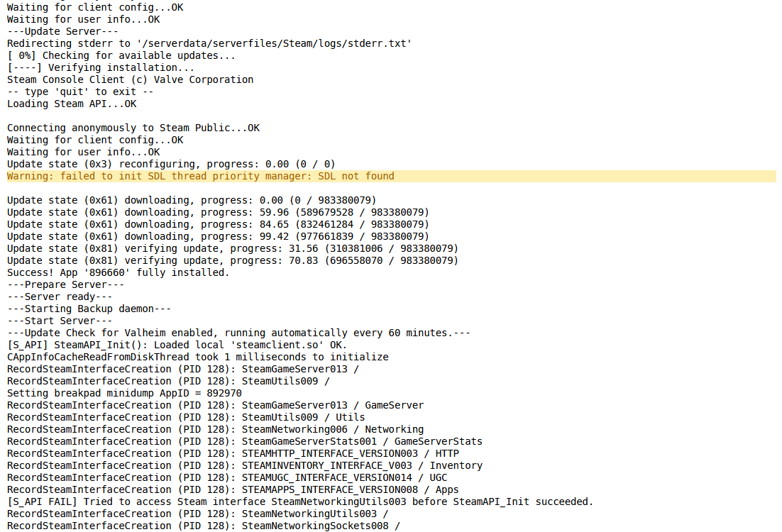

I've now restarted my Valheim server and it picked up the update just fine:
If you have any troubles please see here:
I can concur - my server updated successfully on its own as well. Now if I could just get the second one running 😃
