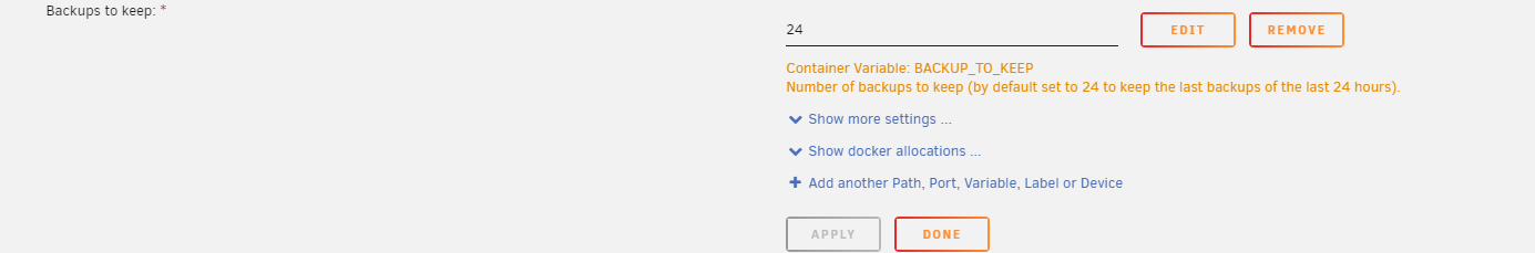

Anyone having issues with backups.  I recently lost a weeks worth of progress.  I kept the default backup setting but it doesnt seem to honor it.  This is my second server running.
Please try to stop the container, remove the Backup folder, start the container again and see if the backup archives are created properly...
