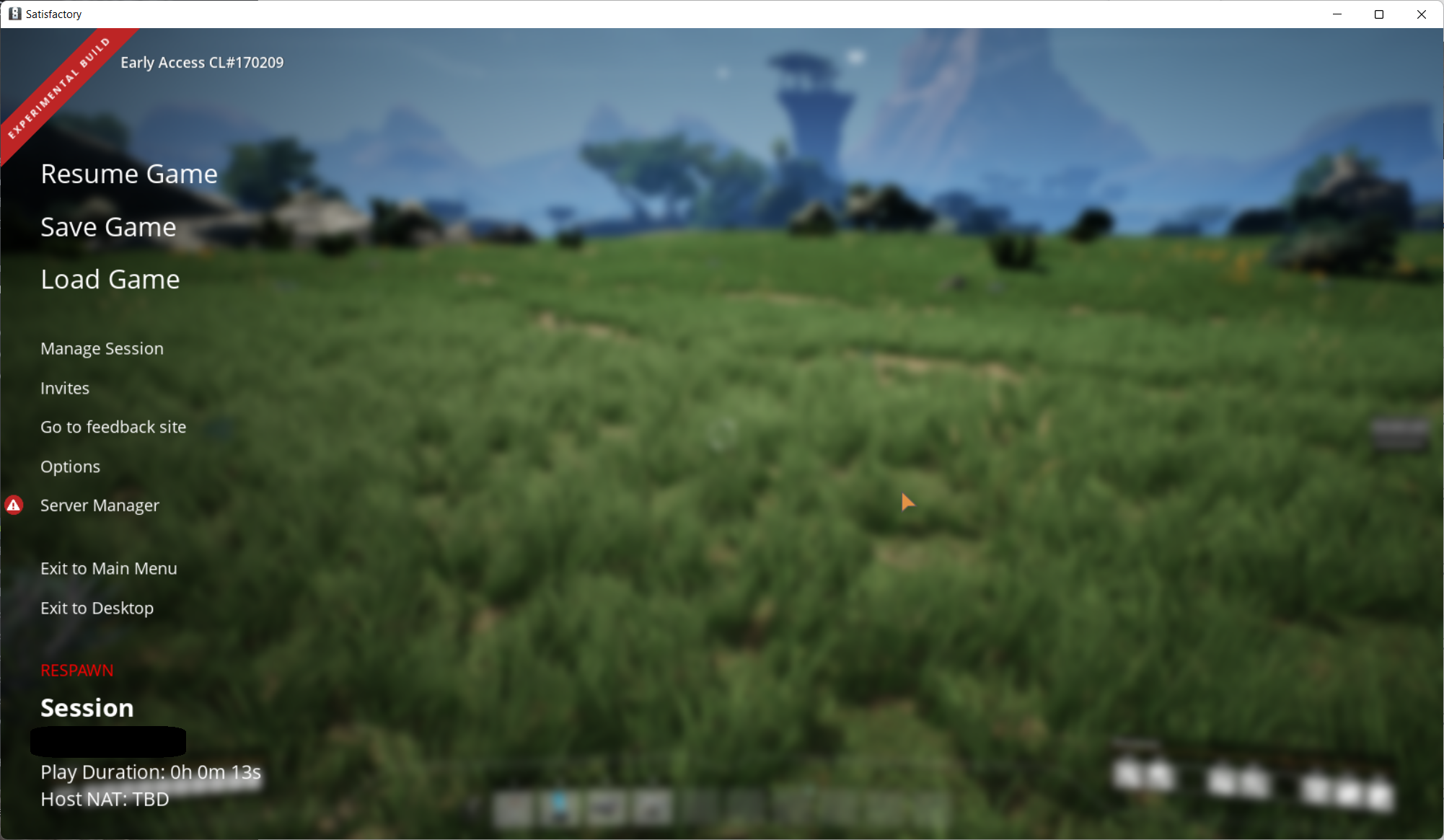

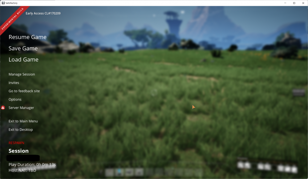

Installed from CA with defaults minus set an ip instead of bridging the network.  I logged into server, created a world, and then went and added some of my local saves.  Switching between world saves is a bit buggy, seems to error then the next time it works.  So far so good for experimental.  I'll need to play more.
I appear to be experiencing an error asking about a subscription, yet I own the game and have logged in at least via my client to Epic Online Services. Any ideas?
@nmills3 & @8064r7 seems like both of you having the same issue.
Can you post a screenshot from you Docker template, have you anything changed to the template itself?
Have both of you a Cache pool on your server, to what is the appdata share set in terms of "Use Cache" on the Share page ("Yes", "No", "Only", "Prefer")?

@ich777 Here's the settings i'm using, i think i left them all on default
And here's my settings for appdata
Do you have enough space on the cache drive left?
Try the following:
- Delete the container
- Delete the satisfactory directory that lifes you appdata folder
- Pull a fresh copy from the CA App and let everything on default
- Open a Log window right after the container is pulled down and see what the log says and maybe post the log output here
My best guess is that something went wrong when connecting to Steam and downloading the game.
Do you have some kind of blocking software on your network like AdGuard or PiHole?
