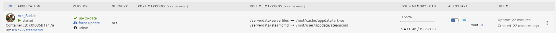

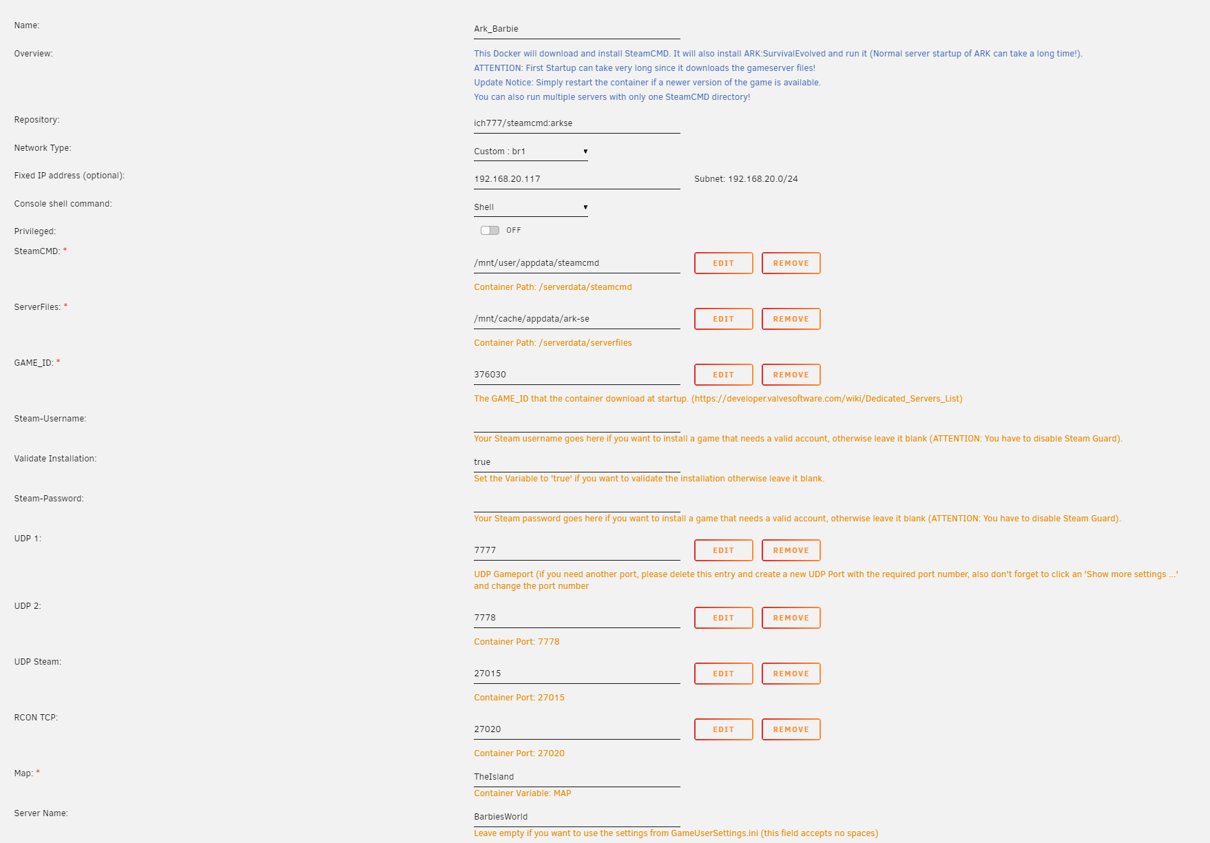

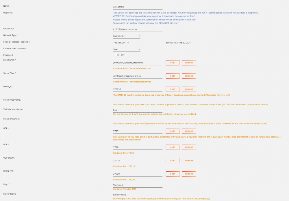

I'm not sure what I'm missing here.. Attached is a screenshot of how I have the Ark Server setup...
It's not showing up in the list of Unofficial servers.  I tried going through this thread but didn't see anything I missed.
(I have also updated my FW information and forwarded Ports, both TCP/UDP to be safe.)
The log file for the container ends with this..
You don't miss anything the server is up and running from what I see in the logs, have you already tried to connect through the Steam server browser.
Please note this was asked a lot of times here, keep in mind you have to set everything correctly in the in game server browser to see your game (and there are a lot of checkboxes).
Probably one checkbox is set wrong and the server doesn't show up, just ARK... :D
EDIT: First try if you can reach it with your internal IP and then I would take it a step further and try to reach it with your external IP.

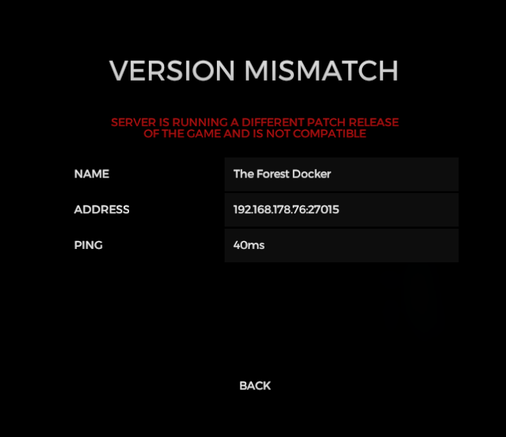

hey i´ve installed this docker with the forest from the appstore. the setup works without a flaw. but when i try to connect it tells me that the server running a different version. (and the ping is kinda high for local???)
the docker is up to date. (yes i know its turned off right now)

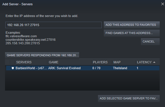

I am now able to see the server using the local IP via the Steam server command.  However, when I try and connect it doesn't work.
Also my friend who is not on my network can't even see the game world
20 minutes ago, Saiba Samurai said:
I tried testing the ports locally using nmap.
Have you even tried to connect with the Steam Server Browser from your local network?
To what port do you try to connect? From in game I think you have to use port 7777 from the Steam Server Browser you have to use 27015.
Please try it first with the usual tools not with network tools and from your local network too, this would be the first troubleshooting steps.
Also the outputs doesn't help I think, where did you run these commands from inside the container or from the host?
The game server containers aren't updated with updates from DockerHub, they update itself when you start/restart the container with the latest version (the description also tells you this) because updates will be a big mess...
This container runs through WINE because there is no native Linux server for the game, this can cause various different things including a high ping, that's why it's marked as BETA.
What doesn't work?
Steam Server command?
What did you do exactly?

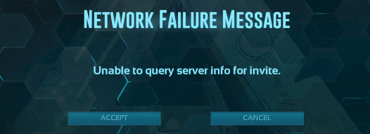

After it's added.  I right click and do Connect.
The game launched and I get this...

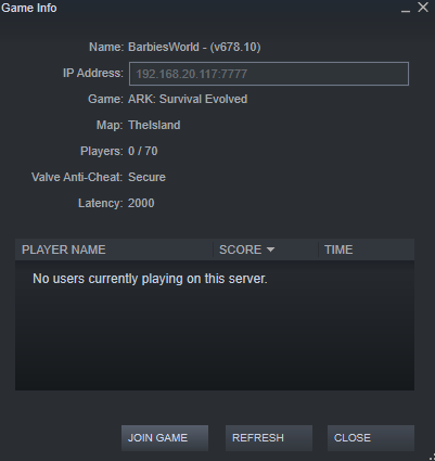

Back in Steam when I click View Server Info.. I see this...
Showing :7777 on the IP Address.
Edited by Saiba Samurai
This seems perfectly fine, because 27015 is the Steam server query port so that it can communicate with the Steam servers and it is then translated to 7777.
Have you changed any port in the template itself with another one or is this the default template as it is available in the CA App?
Eventually @Cyd can help with this.
I have now tried it with the bare default template and I can connect fine without a problem, but I also run it in bridge mode.
