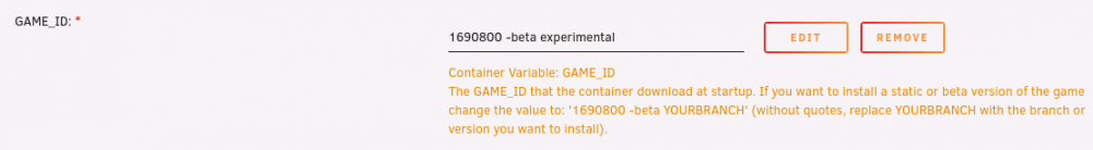

9 minutes ago, Robc390 said:
how can I get Experimental of Satisfactory?
Simply set it to "1690800 -beta experimental" like so:
and set the variable "Validate Installation" to "true" (without double quotes).

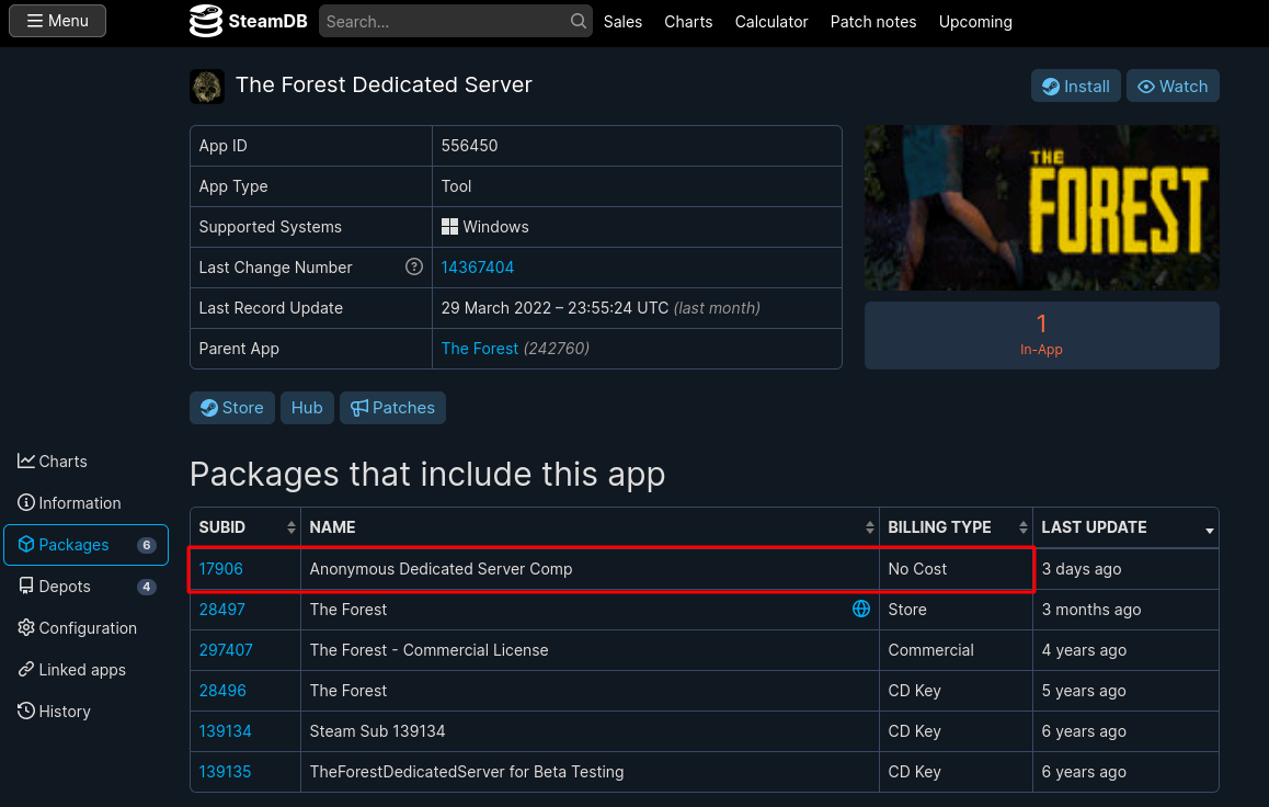

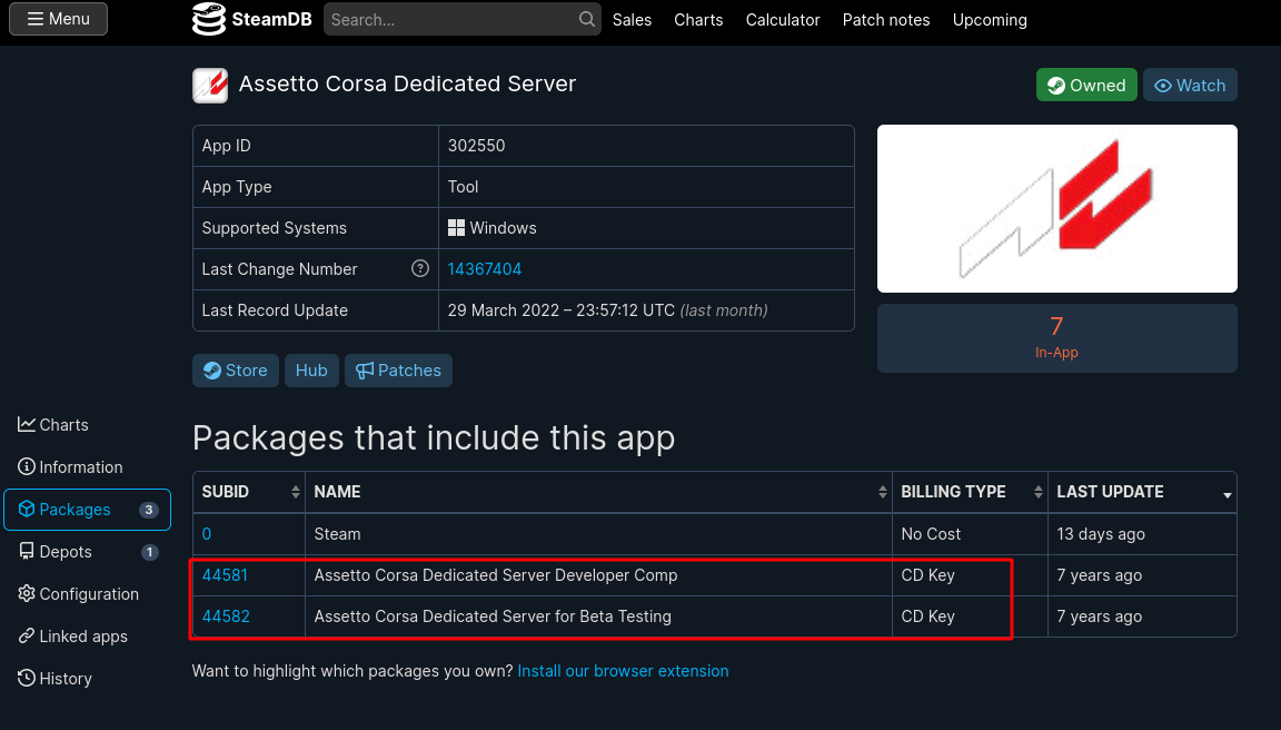

Is there any possibility that the AssettoCorsa image could be updated to support key managed server creation like what was done with the image for The Forest (so that those of us with Steam Guard turned on can use it) or is it not possible with that game?
No, because these are two different things.
The developers from AssettoCorsa made it necessary to provide Steam credentials from a Steam account with the game in the library to even download the dedicated server for AssettoCorsa where this requirement isn't there for The Forest.
You have to ask the developers from AssettoCorsa to allow anonymous downloads from the AssettoCorsa dedicated server.
Hope that makes sense.

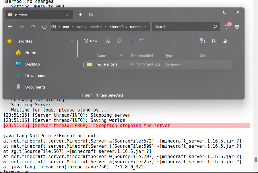

Hello, I have a problem with the MineraftBasicServer Docker.
The Version of the BasicJRE is not recent enough. In the following picture you see the folder with the version number "1.8.0_261" but as you see in the logs, i need at least version "1.8.0_322". So can you help me update it manually, or is it a problem that I cannot do someting about?
For context: I want to host a Valhelsia 3-3.5.1 Modpack Server
Do you need Java 8 or something more recent? Won't "jre11" work?
No, I have tried it. Right now I had an big brain idea. I downloaded the newest Version of linux and opened it with 7zip. So I put the folder in the runtime folder, this time "jre1.8.0_333" and I thought, I won. But after I start the docker, it removes the folder I put in and it downloads the older version. Now I have depression.
Edited by Mammutor
From where did you downloaded it? Can you give me the link and I will fix this.
