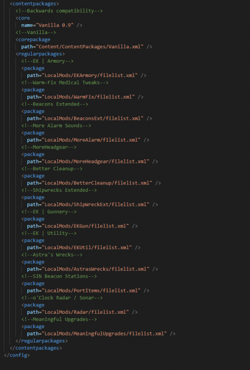

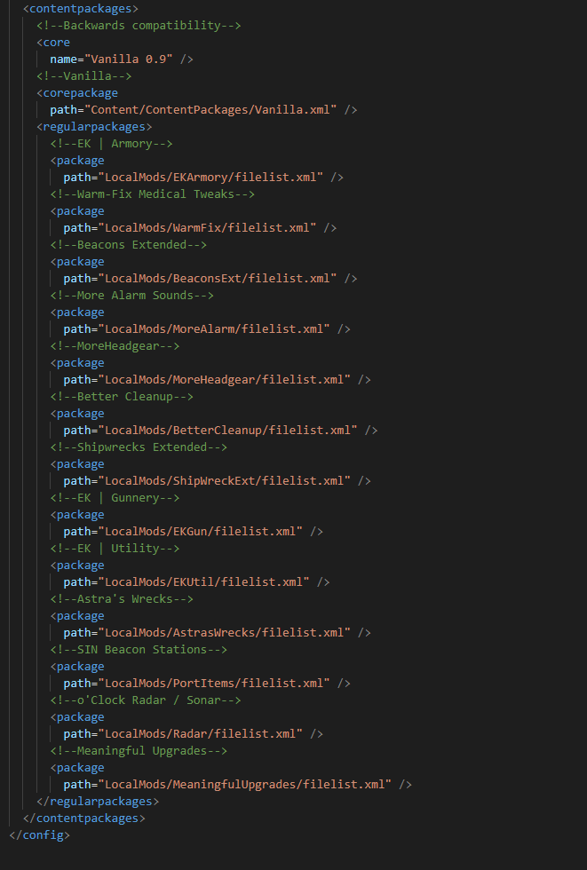

Got the mods working in a workaround kind of way, in case anyone stumbles on this thread.
I took all my client downloaded mods (after booting client into the game and enabling them in the main menu -> steam workshop menu) and copied them to my server folder path "LocalMods" (if you don't know where your client folders are, right-click Barotrauma in the Steam Library page and click "Manage" -> "Browse Local Files"). They will copy over with their steam ID (i.e. "2651474931"). I then renamed the containing mod folders so that the game would consider them a Local Mod and not a steam workshop mod. For instance the folder named "2651474931" was renamed to "Radar".
Then, back in the main directory, open config_player.xml:
1. Change the language from "None" to "[your language]"
2. Go to your client directory and open it's config_player.xml and copy everything between <contentpackages> and </contentpackages>
3. Open the server file version of config_player.xml.
4. Paste the section in between the <contentopackages> and change all the mod directories from the client side (i.e. path="C:/Users/Name/AppData/........../filelist.xml") to the correct path in the server directory for all the folders that you renamed (i.e. path="LocalMods/Radar/filelist.xml")
5. Complete step 3 for all mods in your modlist and save the server file.
6. Restart Barotrauma docker if you accidentally left it running
If you see your server listed on the server browser in Baro, click on it and look to the bottom right pane and it will show the mods that are currently running. That's how you know it's worked. Also, if you get an error that says something along the lines of <StartGame>d__95 has failed, you need to ensure that the language is not still set to "none" in the config_player.xml file.
See the attached image if you need more help.
I'm sure they'll patch the game soon to fix this for dedicated server users, but this should help people get going again.

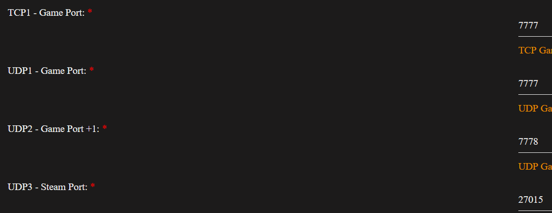

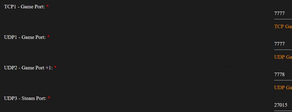

i'm having a bit of an issue with my Conan Exile Server. Installed it in default, did the port forwarding and it runs flawless in LAN. But i can't connect to it via internet. I think this might be the reason:

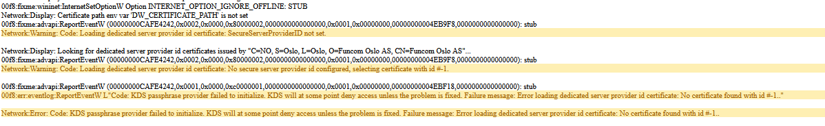

No, these are messages from WINE and doesn't affect the functionality from the container at all.

What ports have you forwarded in your Router/Firewall?
From where did you try to connect to the server, did you try it from your local network through your public IP address or did you try it from a foreign machine? Keep in mind some times hair pin NAT doesn't work properly and people are maybe able to connect with your external IP/domain name.
thank you for your response :)
I forwarded the Standard ports + 12029 because i saw in the LOG that he was complaining about that too. But maybe it also makes no difference.
Edit: a Friend of mine tryed to connect from Home and i tryed from LAN.

Please make also sure that you've forwarded the ports with the right protocol, also keep in mind to don't forward TCP and UDP when only UDP is needed, some game servers will not connect if you do that.
May I also ask how did you try to connect? Through the server list or through direct connection and what did you enter, your public IP or your domain name?
I exactly forwarded the ports from the screenshot, also i allowed ipv4 connection only.
After the Setup i've found the Server in the Serverlist of Conan Exiles, so i tryed first to connect via the join button (Home Pc and Server at the same Network). Also tryed my Friend via Internet.
After failure i connected via direkt connect and internal IP and that works fine.
Direkt connection via public ip causing a time out by both of us (Port 7777).
