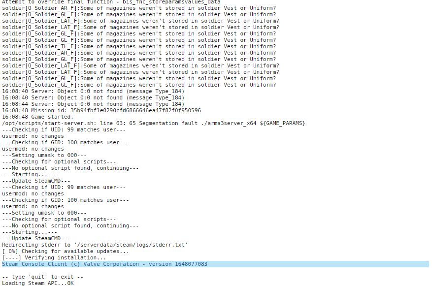

Trying to run an Arma3 server using this docker and it's acting really weird. Everything seems to work fine, server starts, and we can connect remotely to it fine and pick mission and roles, but when you try and start mission from the map briefing the server just restarts with no apparent error, and clients hang with "no message recieved for XX seconds". During this the server restart, and my dashboard gui goes unresponsive for 1 min or so.

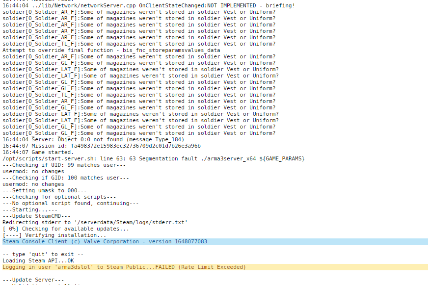

I tried removing and readding docker and i was actually able to get in game only for it to crash after 1 min. After this its back to crashing right at the map briefing.
It's vanilla - no mods and i removed all mods on clientside too.
Can you help? i cant seem to find the arma logs, or the ones i can see are empty

In the meantime can you share your Diagnostics? I've switched the container over to the 64-bit version but this was about a month ago and it should work correctly from my testing back then.
You should see the Docker log when you click on the icon from the container and click on log.

thx! yeah i was watching the log on my second screen as it restarted itself. This log window autoscrolls super fast, and also start hanging when restart happens. Therefor it was hard to spot and copy text, but i managed to grab 2 screenshots :/ is it perhaps the "Server 0:0 not found" entry?

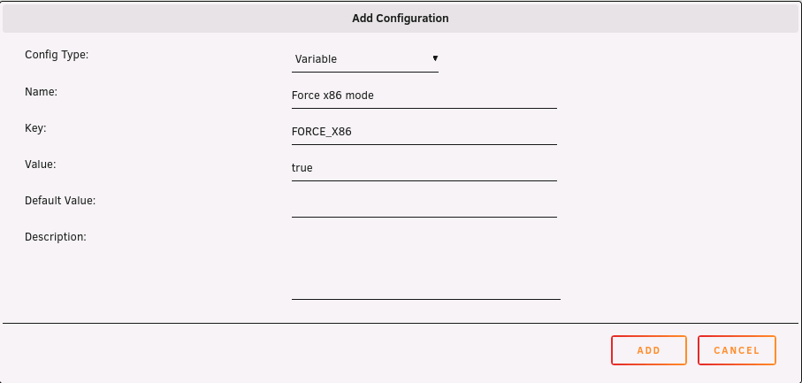

Can you try to add a Variable like this in the Docker template for ArmA3:
This will basically force the container to execute the x86 executable and not x86_64.
Please report back if this helps to fix your issue.

@ich777
This fixed it all it seems! yay thank you so much for taking your time to help
