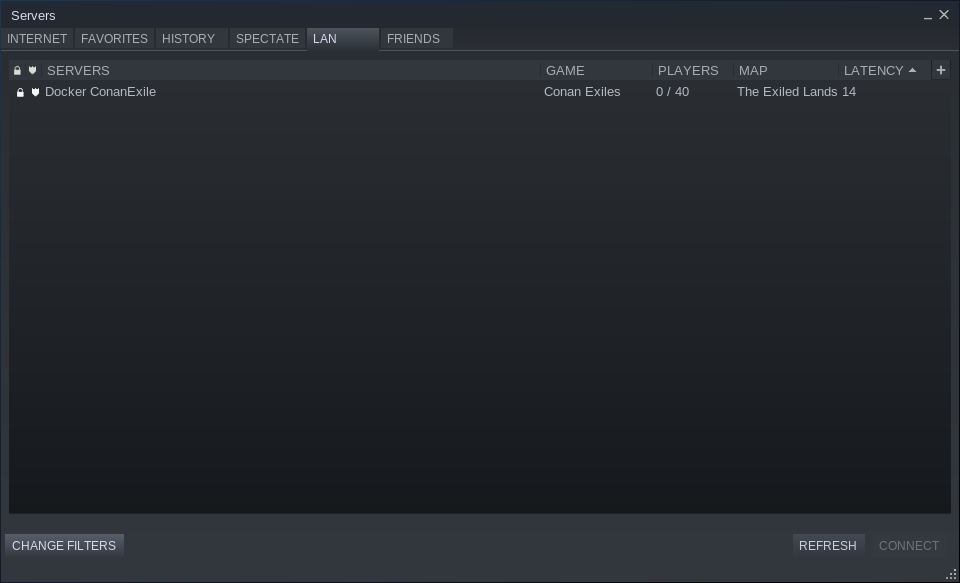

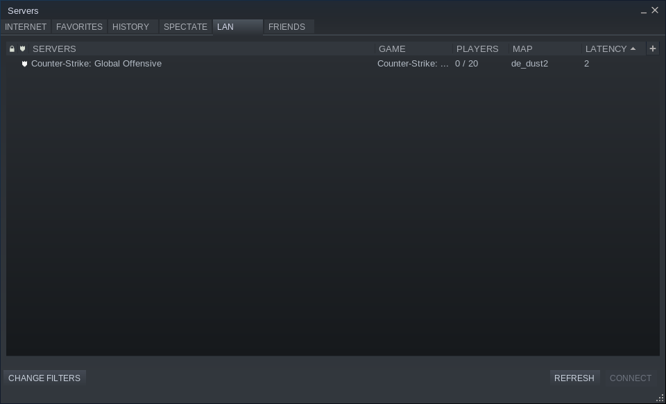

I've now tried it on my server and it works flawlessly, here is the log after the first installation: ConanExiles.log and I also can browse it in the Steam Server Browser:

I've now tried a fresh install and it works right OOB: CSGO.log and I also can browse it in the Steam Sever browser:

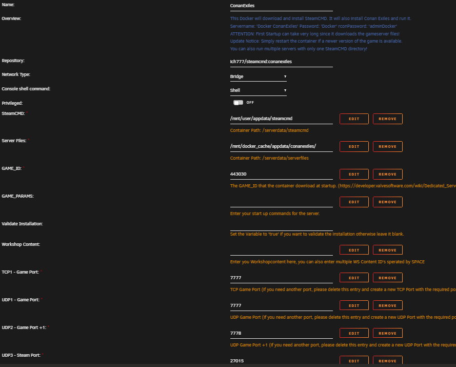

Can you post a screenshot from the entire template for ConanExiles?
I would strongly recommend that you not just point the existing template to the new drive, I would recommend that you really start over, delete everything related to the ConanExiles container and pull a fresh copy from the CA App.
TBH, I think I never saw this error, seems like it doesn't start the xvfb server but I actually can't tell why that happnes on your system. Have you changed anything else to the container, maybe mounted another directory or do you change anything in terms of the /tmp path inside the container?
Do you use a docker.img or do you use the path? Maybe it's related because the Docker images are on a XFS filesystem, but that's only another guess, as said above, I've tried it this morning and it works flawlessly.
Went ahead and re-formatted both my cache drives to BTRFS, and to remove the WINE64 folder that I was unable to delete from previous attempts.
This is the template, I'm not changing any of the settings, download and install with the setttings exactly as they are shown
Please keep me updated if it is working after you've did this, sorry for that many tries, but it's really strange that it won't work on your system...
