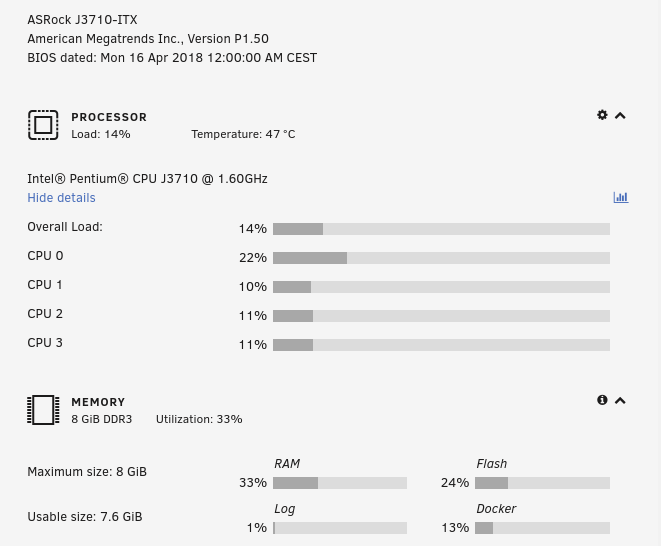

I googled "GMod Segmentation fault and it seems like I am running out of Memory...
Well I thought 8 gb could run at least a teamspeak and a gmod server
Is there any workaround for that problem or do I just need to buy more RAM?

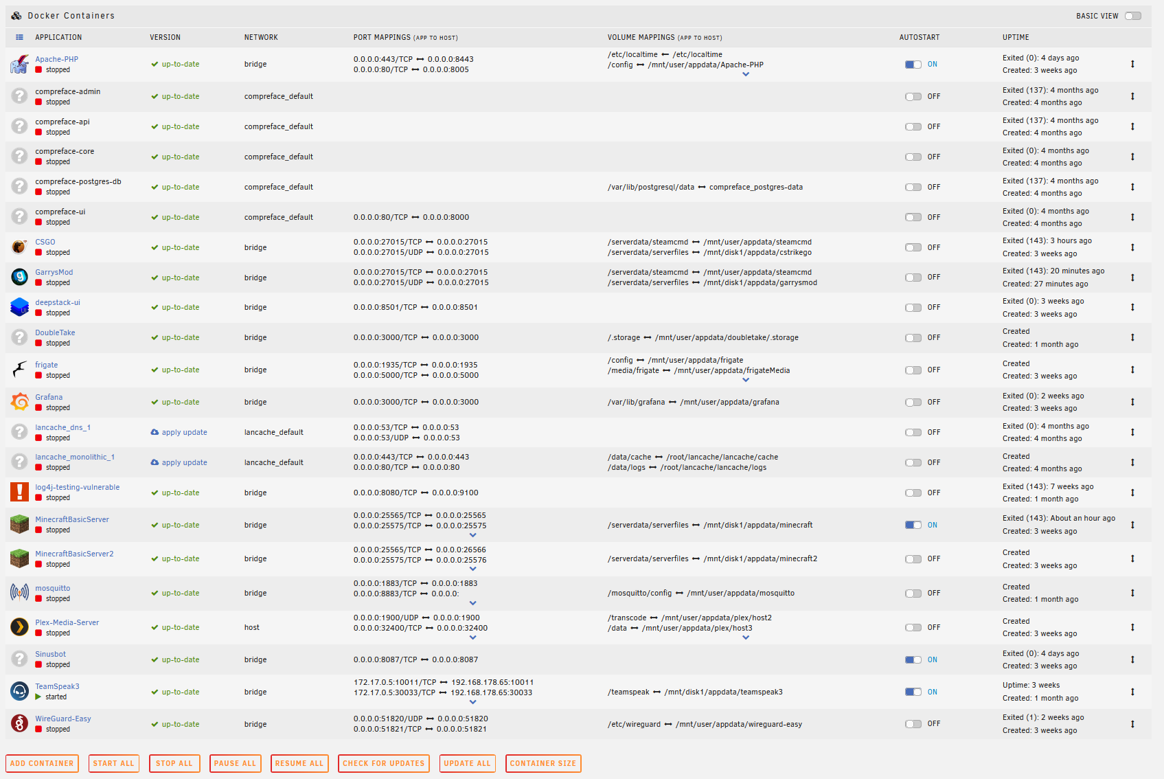

Only Teamspeak is running on the screenshot
You are definetely running not out of RAM…
The container doesn‘t need that much RAM.

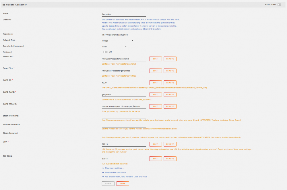

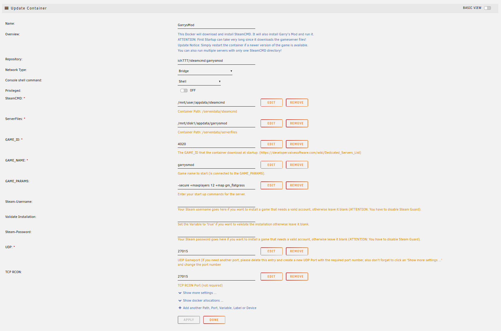

can you please post a screenshot from your entire Docker template?

11 minutes ago, ra4e1 said:
Ok, I restarted the Unraid and reinstalled again and now we are here:
What CPU are you using? Maybe a pretty old one that don't support AVX or anything like that? I tried it now on a Unassigned Device formatted with XFS because I had in mind that maybe the filesystem is the cause of the issue but that's also working fine, log is as always here: garrysmod.txt
As you can see the container needs only about ~800MB of RAM:
It's the i7-2600

1 hour ago, ra4e1 said:
It's the i7-2600
I think it's probably caused by your CPU would be really great if someone else with the same or a slightly newer CPU can test this.
Can you maybe try to add a Cache drive to your system if you have one lying around and try if you can get it to run with a Cache drive.
I really can't think of anything else than a CPU issue, similar issues where reported with Satisfactory on older AMD chips because they don't support AVX2 and since GarrysMod is a heavily CPU bound game that's my best guess that they've changed something that also needs newer instruction sets.

I tried to install a gmod server (without docker) on a fresh Ubuntu server vm. Same CPU, same Unraid Server. It's worked out flawlessly. Is that a proof for the CPU?
No, definitely not because if you do a Host pass through it see the same CPU.
Maybe it's really related to the filesystem, I can't tell for sure because it works flawlessly on my system... And I've now also tried it on my test system:
This is my test server with the container running, as you can see my test server also has 8GB of RAM installed and it works also flawlessly.
The only difference is that I've installed the game to a BTRFS Cache drive, I really can't tell why it won't work on your system.
Here is the log from my test server: garrysmod.txt
Well I added the cache drive and now it worked right oob. So was it caused by the filesystem?
Anyway, thank u very much!
Maybe, really can't tell, on my disk that is formatted with XFS in Unassigned Devices it works flawlessly...
Please make sure that the share the the game is on is set to use Cache "Only" or "Prefer" otherwise you could run into new trouble...
Has the path in the template also changed to /mnt/cache/appdata or am I wrong?
