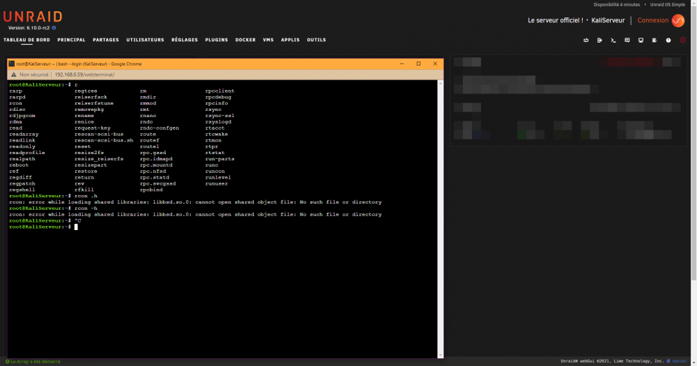

Hello I have download the Garry'sMod server in the community app's, I want to know is there a way to acces to the server console or a panel ?
Through RCON yes.
What is your exact use case?
Okat I see, I just asked if I could use the docker console or something like an console for the server 😛
I've recently released a unRAID plugin (RCON) so that you actually can connect to the game server from the unRAID console with this plugin.

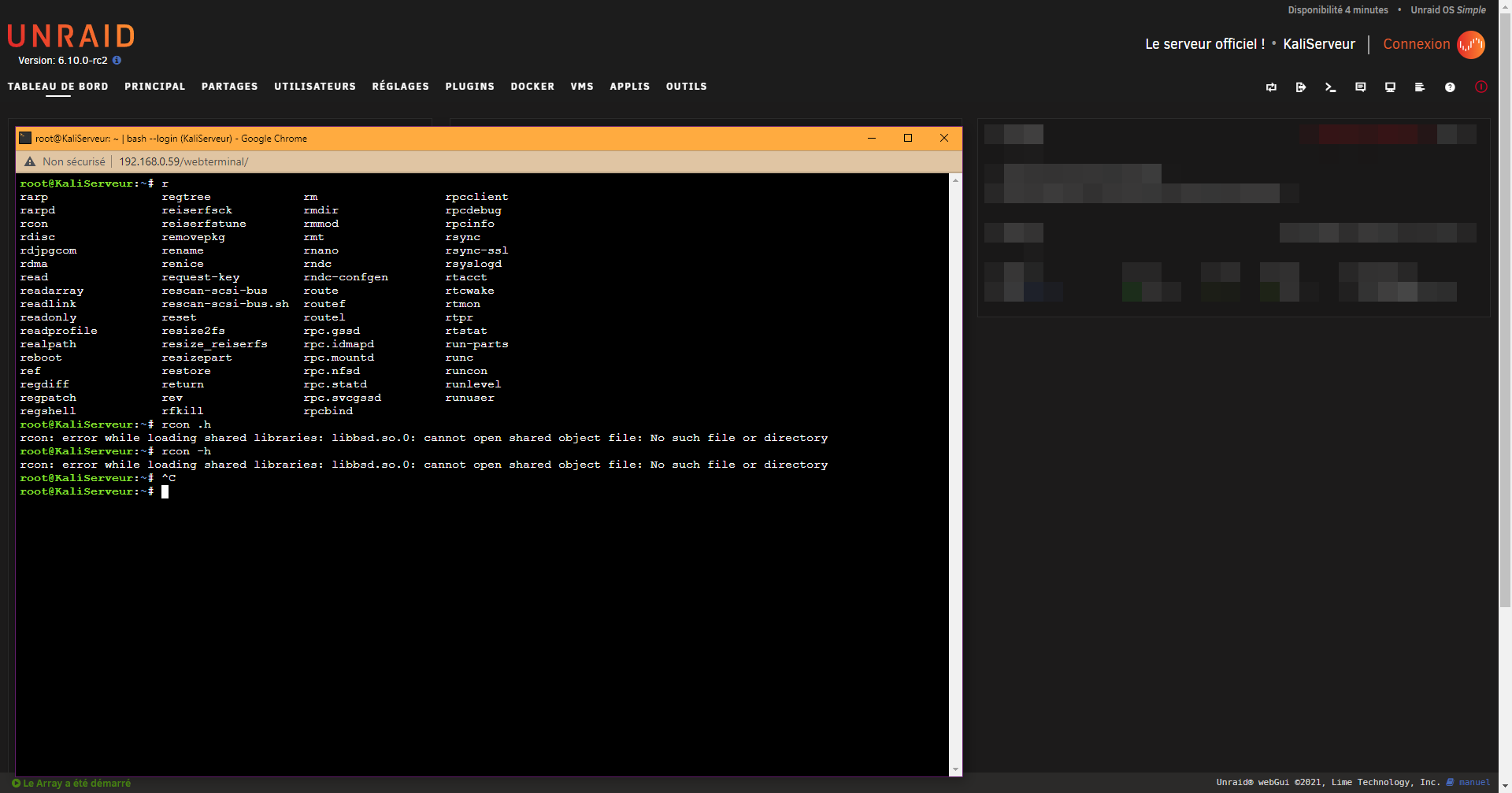

I used your plugin, but hmm seem to not really work with me :$ image.png.a73fed43716ac23477b1918b20fcbcdd.png
Edited by Fantucie

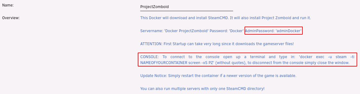

On 12/21/2021 at 7:25 AM, ich777 said:
Sure thing, you can either log in as admin with the admin password or you can connect to the game console by opening up a unRAID terminal and enter: 'docker exec -u steam -ti NAMEOFYOURCONTAINER screen -xS PZ' (without quotes and of course replace NAMEOFYOURCONTAINER with the container name, should be ProjectZomboid).
This is also mentioned in the description from the container itself:
Hope that helps.

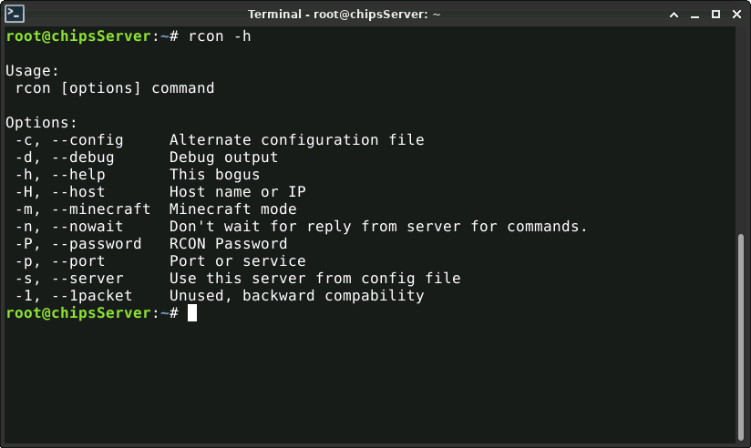

This is really strange, it should look something like this:
Are you on unRAID 6.9.2?
Yes I have the last version of unraid, the 6.9.2, but I cannot use the rcon plugin at all :/
Just got an error of librairies :/
Are you able/willing to upgrade to 6.10.0-rc2?
I'm running the latest build and it works without a hitch.
I just upgrade to the 6.10.0-rc2 and still the same error.
'rcon: error while loading shared libraries: libbsd.so.0: cannot open shared object file: No such file or directory'
Please give me a bit and I will look into this...
