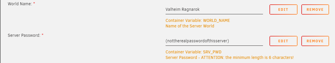

Sorry to ask another question after my Wreckfest issues earlier this week, but I have a problem with the Valheim container now.
The issue is that I can't seem to get it started when a value is changed. When I download the container, and don't change anything, then I can connect to it in game.
But when I download the container and change the world name and password, then the container does not want to start. I think it is stuck in a loop. I can see the CPU usage and ram usage ramp up, then drop down all the way to almost zero, then ramp up again. This keeps going and going. The logfile also seems to keep repeating the same steps.
I have only changed the world name and given it a password:
(the password field is not the password of that server. I only changed it to show what field I am editing)
Here is a piece of the logfle. It seems to keep repeating the same steps at the bottom.
valheim.txt
Edited by ich777
put log into file to not bloat the thread
How long is the password? make sure that is at least 6 characters longe, maybe also avoid special characters.
That might have been it. The container runs now.
I used a long string made by a password manager that contained lot's of characters. I have now tested with a more reasonable password and now it starts.
