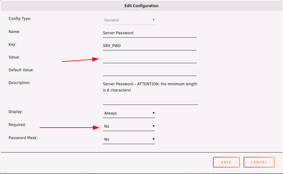

When I try to create the docker container using these steps It just gets stuck.  It appears as though it's setting up the server but just kind of stops.  Also how can I create a server without a password?  I think maybe deleting the password field is causing my problem so I'm trying again on adding a second server.
For Valheim that's not possible only with a mod server from what I know.
Yes, Valheim by default needs a password that is at least 6 characters (without special characters).
Do you have a log from this? This is very unlikely to happen.

So, it appears that something got hung up during installation I've already deleted and rebuilt.  I deleted the password field in the container settings which was dumb because now it has a password and I don't know what it is.  LUL.  I'm kind of just a do stuff and see what happens.  I learn the most when I have to fix my mess ups.  Always had that approach to learning.  I think I have everything figured out now I was really just hoping for a way to go public no password to have an open server for kicks to see what happened.  If anyone knows how to make that happen I'm down for stumbling my way through figuring it out.
The default password is "Docker" (without quotes).
You have to enable ValheimPlus in the template, start the container once with a password and wait for it to start up completely after that stop the container.
Go to your Valheim directory, edit the file ".../BepInEx/config/valheim_plus.cfg", search for the string "disableServerPassword", set it to "true" (without quotes) and save the file.
After you did that go to the Valheim template, turn on Advanced View on the top right corner and click on Edit at the Password (don't delete it), at the drop down for Required set it so "No", delete the Value, and click Save and Apply:
Please note that only players with ValheimPlus can connect if you've enabled ValheimPlus from what I know, maybe this can be also disabled in the config but this is a thing that you have to research on your own.
