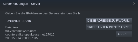

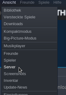

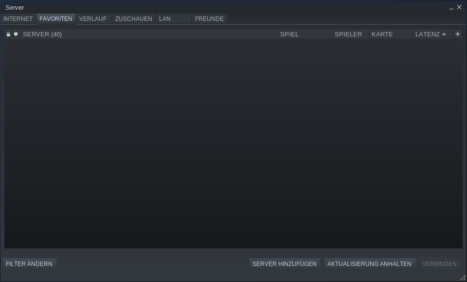

First of all I would try to connect through the Steam Server browser if you can see the game, please do the following:
Open up Steam and click on "View" -> "Server":
Then click on "Favorites" and in the bottom right on "Add Server":
In the next dialogue enter UNRAIDIP:27015 (of course please replace "UNRAIDIP" with the IP from your unRAID server) and on "Add to Favorites":
After you have done that you have to click one more time the "Refresh" button in the lower right corner and you should hopefully see your server.
If you see your server you can go to the next step and try the exact same thing as mentioned above with the only difference that you have to enter your Public IP instead of you unRAID IP.

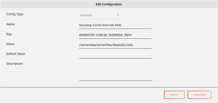

On 12/30/2021 at 11:36 AM, icepik said:
Thanks ich777!  That was fast.  I'm seeing this now after following your instructions:
Not seeing any BepInEx in the output_log.txt in 7DaysToDie_Data folder either.  The screenshot above says it's hooking into UnityPlayer instead.  Is that possibly why?
*edit* - I am seeing some BepInEx in the log file...was just further into the log than I thought it would be :D.  Looks like it's working!  Thanks for the quick update on this!  You're awesome!
Would it be possible to get the container updated for 7dtd again so that when the BepInEx value = true it will call run_bepinex_server.sh instead of run_bepinex.sh ?  The mod author updated BepInEx to 5.4.18 for his mod and now it's not hooking it in before the server launches.
The container doesn't run run_bepinex_server.sh or run_bepinex.sh anyways, it runs the required commands on start.
Can you please post your log?

8 hours ago, icepik said:
It works perfectly fine launching it with a full Linux distro when you launch the 7d2d server using run_bepinex_server.sh, just doesn't work from the docker instance.  The only thing I can think of is something in the that sh file is causing issues maybe.
I found the cause of the issue and that is because this developer uses doorstep differntly from everything else and that is the issue, as said in my previous comments this is a nightmare if there is no unified build from BepInEx for 7DtD like it exists for Valheim.
The developer from the mod uses this DOORSTOP_CORLIB_OVERRIDE_PATH:
BepInEx/core
but I use this in my container:
${SERVER_DIR}/unstripped_corlib
Anyways, I've updated the container so that you can create a variable like this:
Please do the following:
  1. Stop the container
  2. Do a grafik.png.e29219e3689777a2164289a73e693e5b.png from the container on the Docker page
  3. Edit the template
  4. Add a variable with the Key: DOORSTOP_CORLIB_OVERRIDE_PATH and the Value: /serverdata/serverfiles/BepInEx/core
  5. Click Apply
