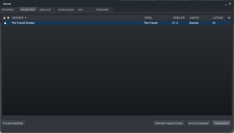

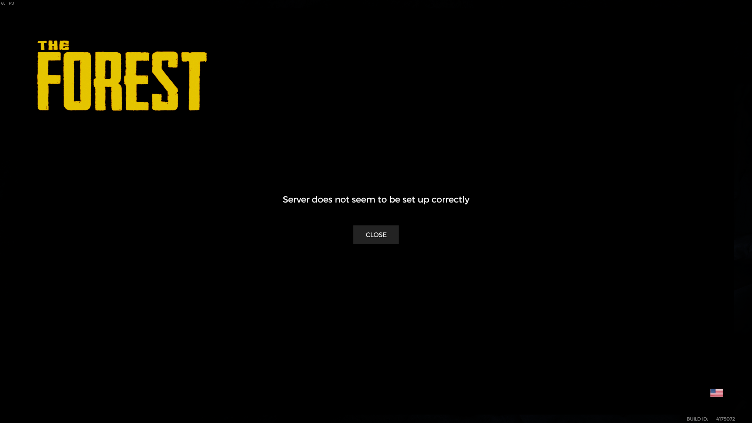

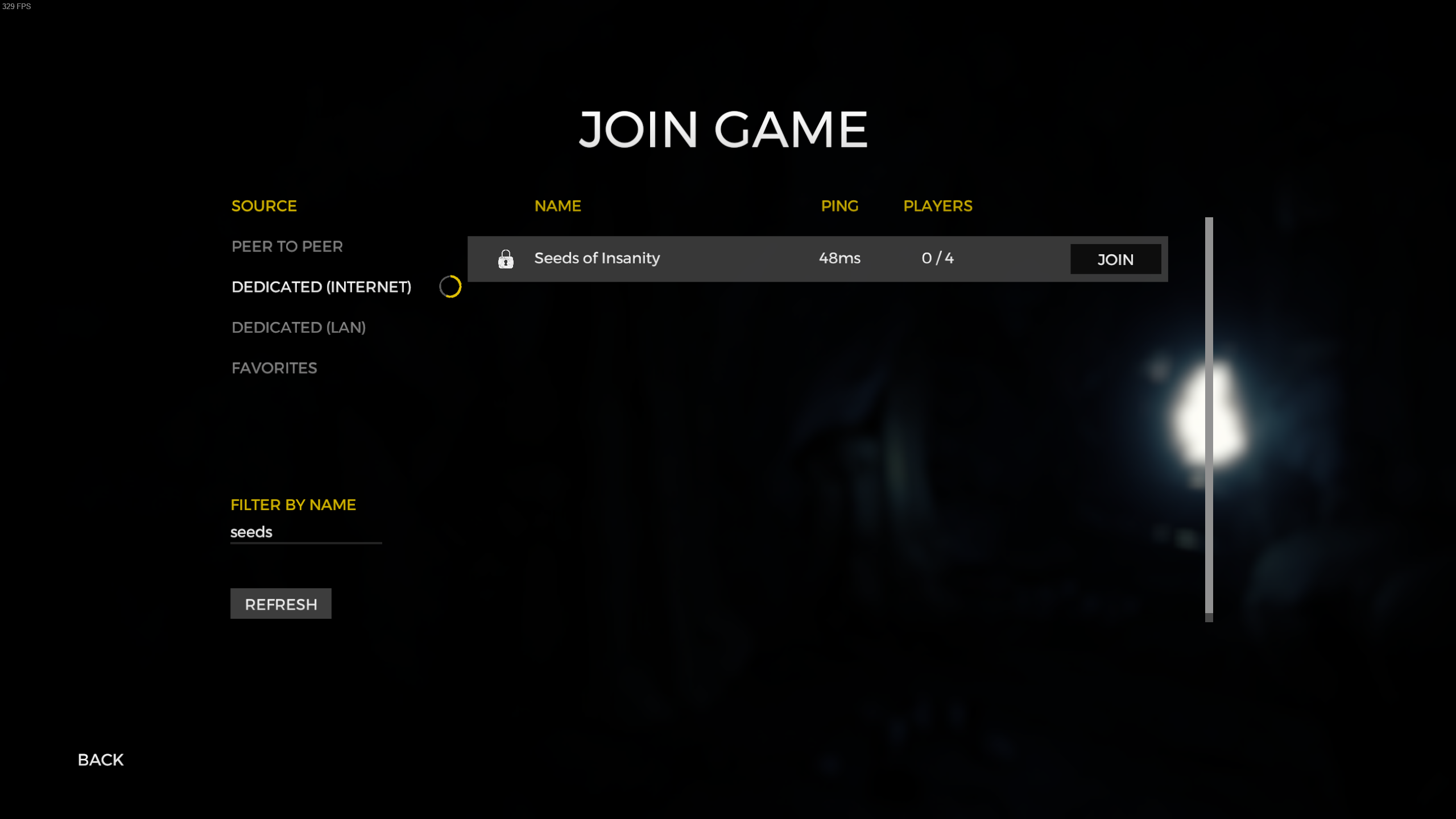

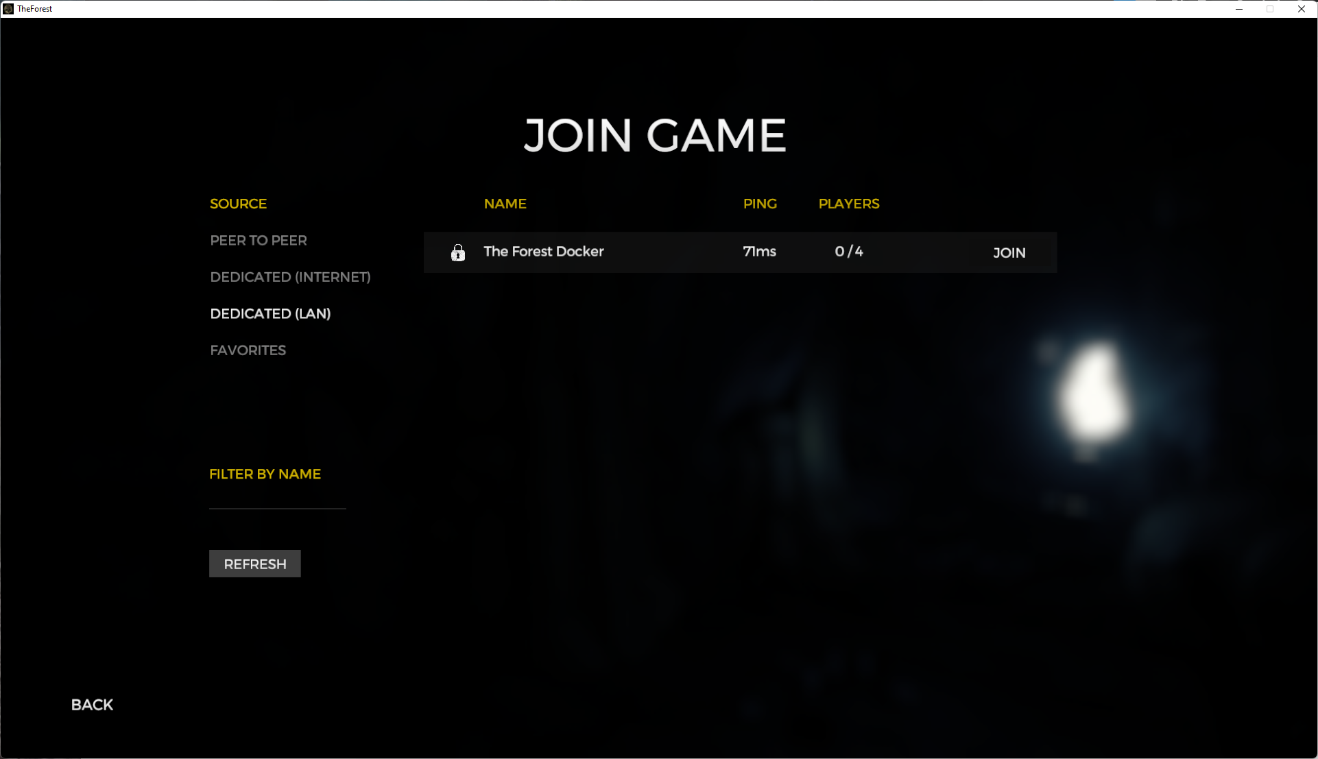

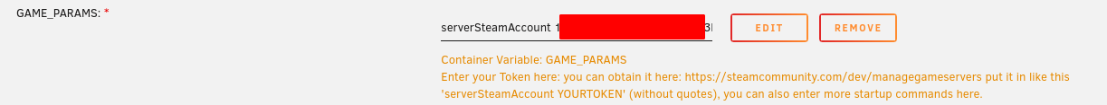

1 hour ago, BennyD said:
I don't what's goin on, the logs end with the following, the game is showing up but when you try to connect it says the server isn't setup correctly.
Can you send over a screenshot from the message?

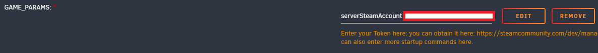

I've now tried it on a fresh copy pulled from the CA App and it works flawlessly:
Have you also created and fille in the 'serverSteamAccount' like described in the GAME_PARAMS variable?
I will also push an update to the container itself shortly to update the base. DONE
This is what a full startup looks on my server: theforest.log
Here ya go, screens of everything and a log.txt
log.txt
