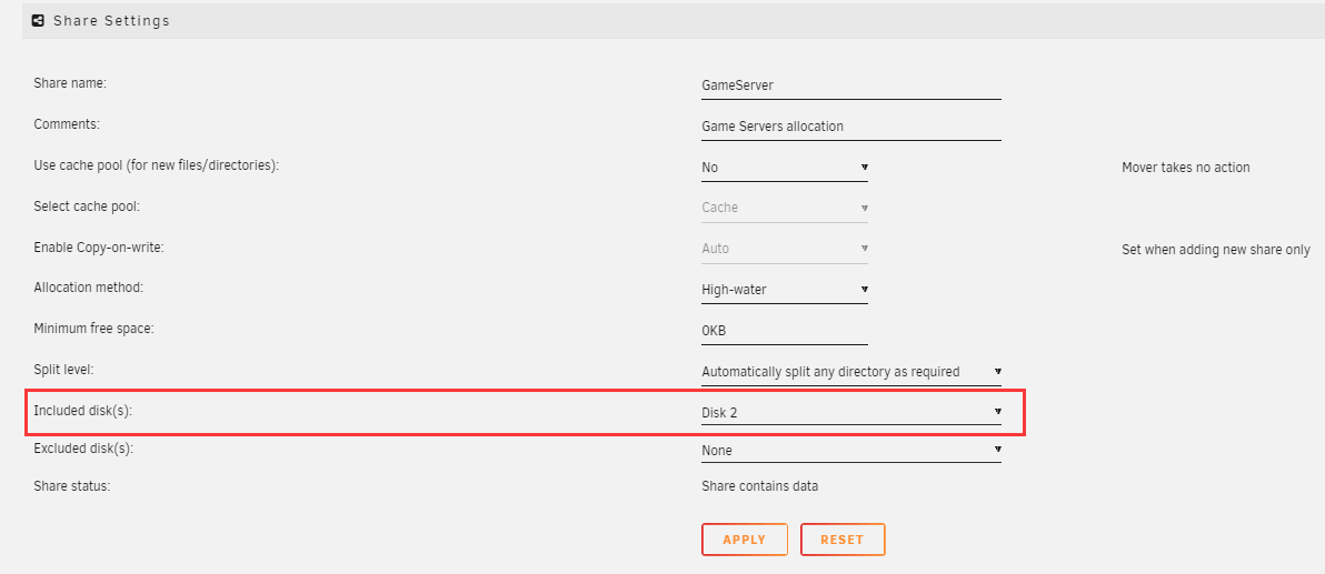

18 hours ago, Zakikun said:
Updated: Rediculous! All I have done is change the data path from disk3 to disk2 and now everything is fine. Why? Why?!
I think that's caused because your appdata directory is split across multiple disks.
Go to your share settings and select one disk at 'Include disks' with this you make sure that your appdata is loacated only on that one disk and not spread across multiple disks.
Even if I have assigned data path with “disk3”, the container still split some other files inside it (like runtimes or thread related) to multiple disks because "GameServer" share directory including "all" disks?
Setting like this should fix my problem?
Exactly but this involves maybe redownloading the container so that the files are on diskX

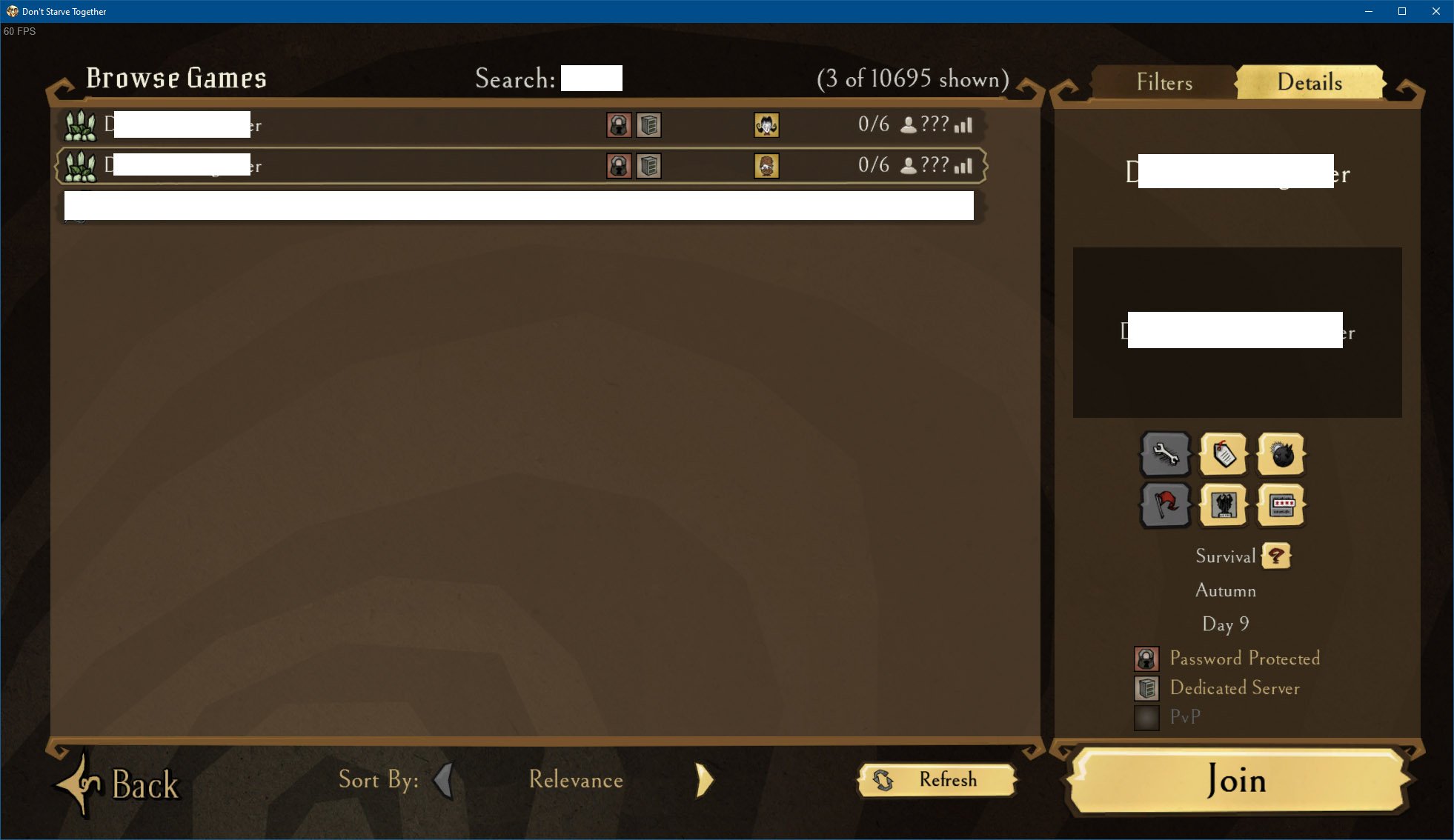

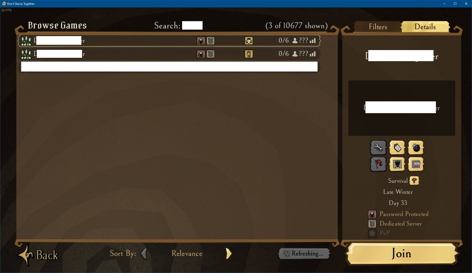

This is weird...  I've asked on the Klei forums and got nowhere, but any ideas why my Don't Starve Together unRAID instance is creating TWO distinctly separate worlds to join?  They share the same preferences as set in the cluster.ini (game type, name, password, etc.)
In the attached images you'll see that one is on Day 33 and one Day 9; both completely playable!
Left4dead2 dedicated server related.
After tested for a day, now I can say the l4d2 server works normally even with lots of sourcemod plugins.
The key to my problem is "serverdata" files are splited unexpectedly between different physical disks.
So anyone meets the same issue like mine:
Make sure the share directory ( located by "serverdata" path) is not set to split new files and subdirectories.
In operation, setting  "use cache pool" to "No" or "Prefer".
("No" keeps them in the same one array disk, "Prefer" keeps them in the same cache disk).
Really thanks to @ich777
This is really strange... Is one maybe for the Caves or did you deactivated the Caves?
Can you restart the server and send me the log output please after restarting the server until it's fully started?
cluster_token.txt
Are the logs stored somewhere in the /dontstarve folder?  The unRAID log window always slows down Firefox and will sometime crash!
You have to wait, a long, long really long time and after that you can pull the log, Firefox actually doesn't crashes.
If you are running it with caves then yes, if you are running it without caves than not.

49 minutes ago, DockerBubba said:
maybe it's a corrupt cluster_token.txt?
If you only got one container running without the Caves then it should only be one server visible.
Maybe you have accidentally changed the config from the server so that it actually creates a second instance.

8 minutes ago, DockerBubba said:
The install is pure vanilla from the Docker repository, with only minor changes to the cluster.ini for name, game type, etc.
I will try it when I got home from work on my server and report back.
From what I see in the logs everything looking good for the Caves and Overworld, maybe some setting was changed so that the Caves are now a separate Dedicated server?
The default settings that I ship the container with are that a cluster is created and both the Overworld and the Caves are started as two separate instances but are only visible as one, however if something was changed in the config that no cluster is created it is possible that you see two instances running.
Hope that makes sense to you.

I just removed and re-installed the instance (making sure to completely delete the /dontstarve folder prior to re-install, again)
This time, I'll add the token and make incredibly minor changes to the cluster.ini, like just the name and password, even though hardly anything else was changed in any case.
Follow-up: Nope, same thing...  Completely vanilla install, only changed the game name, password and type (game type made no difference in the past).
There are really only two possibilities:
- the /steamcmd directory holds something that is messing it up
- the cluster token is somehow messing it up
Hmmm...
Follow-up #2:  Tried a cluster token from a friends server, no difference, still two joinable games show-up (yes, he shut-down his instance! ;) )  This time, I changed the game name and password ONLY!
Edited by DockerBubba
