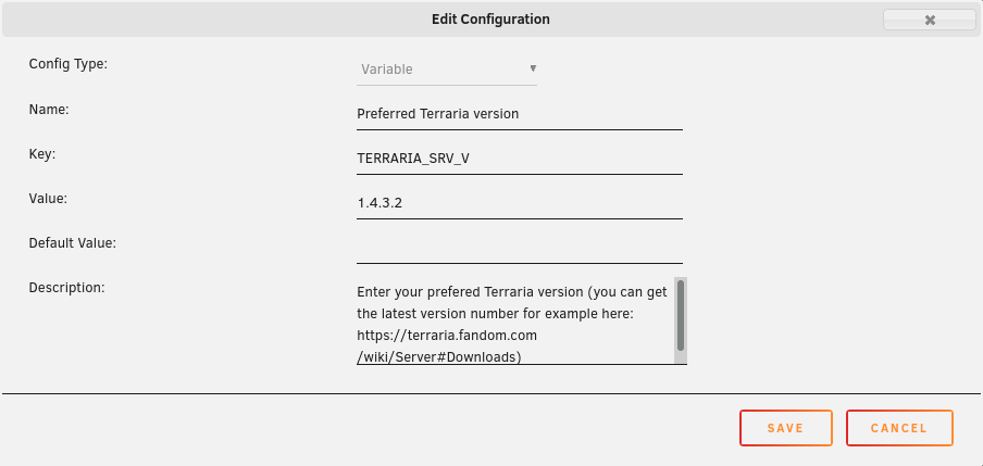

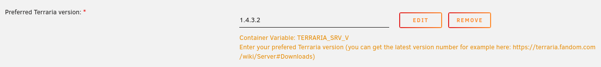

hi Ich thanks for the dockers,
I'm having an issue with updateing the Terraria one,
The info says a restart should load the latest version, but it isnt doing that?
latest version 1.4.3.2 docker version 1.4.3.1
you able to look at this at all
thanks
Change this variable to 1.4.3.2 instead of 1.4.3.1:
i Don't seem to have that as a variable?
Then create it like that:
Also make sure that you are on the latest version from the container first, maybe try to click on grafik.png.1043a5efff59aba4bb2d629212a04fa1.png on the Docker page with Advanced View turned on.
Perfect thanks
