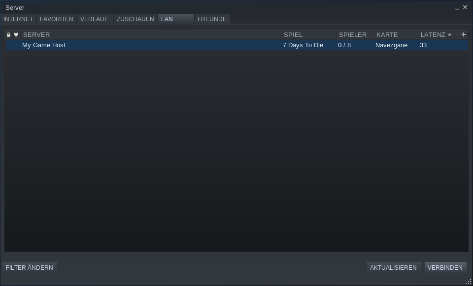

I don't know since it works just fine on my server without an issue, attached the log: 7DtD.log
...and as you can see the server is just running fine and is browsable in the Steam Server Browser:
I can't tell you what's causing that on your server but the first step would be that you upgrade your unRAID version, I have no test server available with such an outdated version.

You are totally right. My bad. It works like a charm when they connect trough the tab ''Server manager''.
I know it has been asked already but I couldn't find an answer, is it possible to let them connect trough an custom domain.
I have an own domain and use cloudflare, I got it working for minecraft etc but not can't get it to work on satisfactory. Any tips?
(not sure if i have to change something in the docker template, I set it to a custom network)
