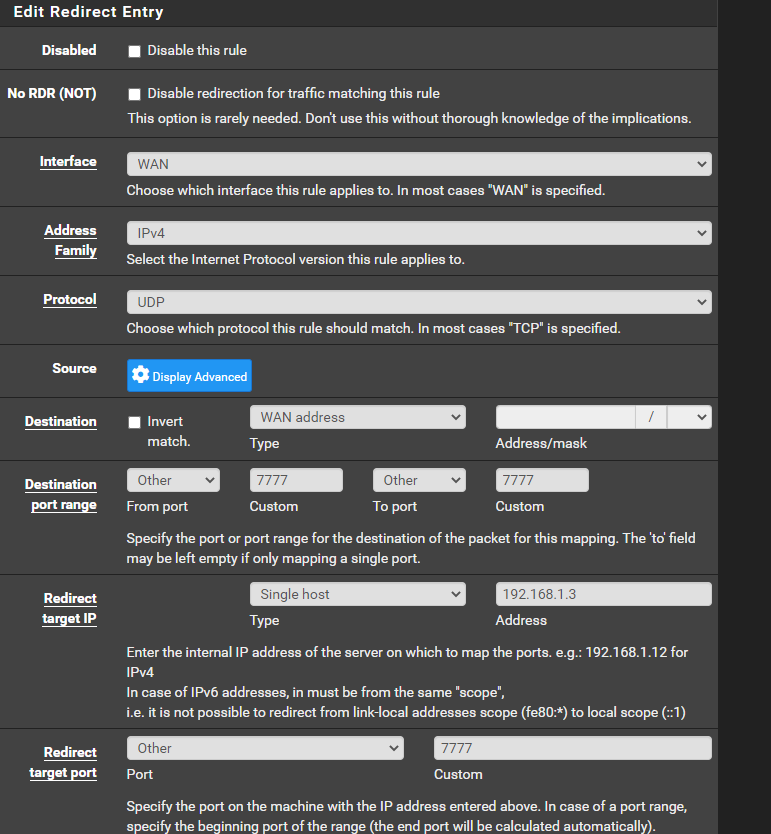

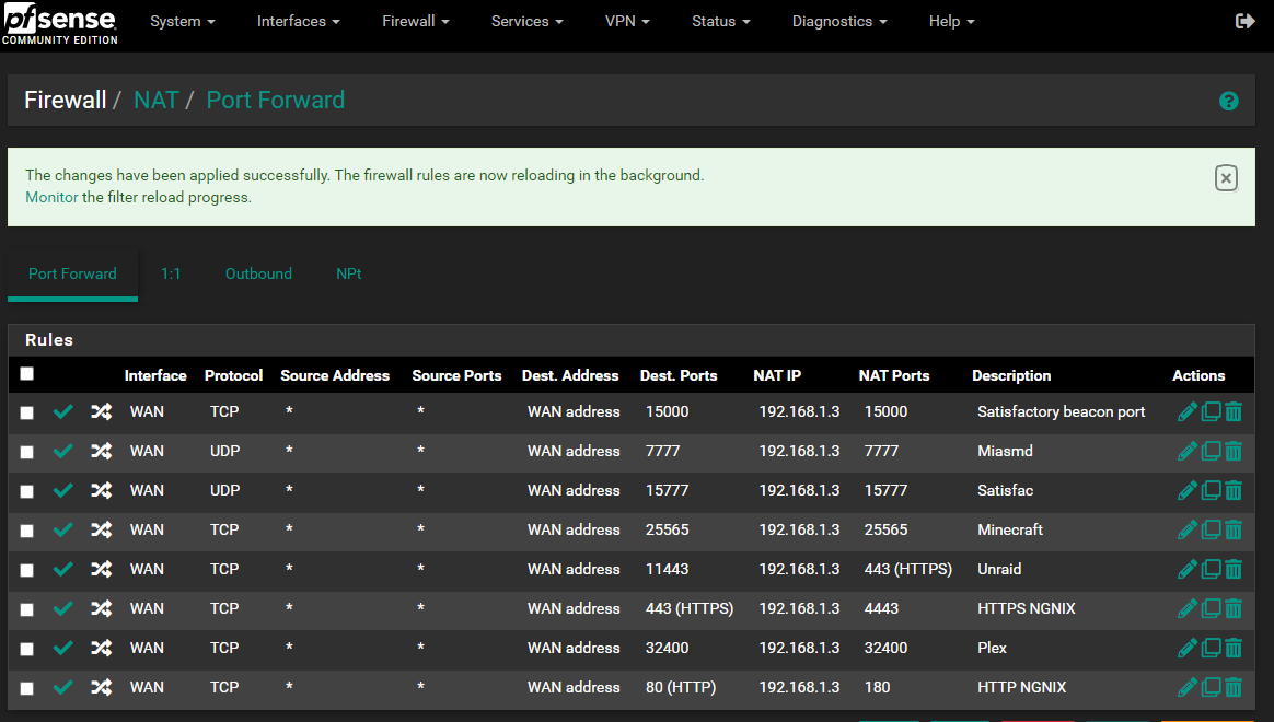

@ich777 Hi Ich thanks for taking your time responding.
i have just reset the config, back to what is default:
here you can see what im using in the pfsense settings.
tbh. i'm at a loss what to do with this one. the other ports doesnt work either? as i told earlier, the minecraft container from binhex works just fine when i portforward from that.
You need to also create the forward rules for the query port and the beacon port, because these ports work all hand in hand.

I'm not translating any ports, im just NAT'in the ports 1:1 eg: 7777 -> 7777
as you can see in this picture: image.thumb.png.e91ebaa551e35f2af7afd9c95035d128.png i have also tried and scanning my port again, and still no dice. :( even the query port? im not getting any life on that port either.

From your pfSense config I can see that the Beacon Port uses TCP but it uses actually UDP.
Do you try to connect from your LAN to the server over your public IP or do you try it from outside?
Can you see the server in the Steam Server Browser?
