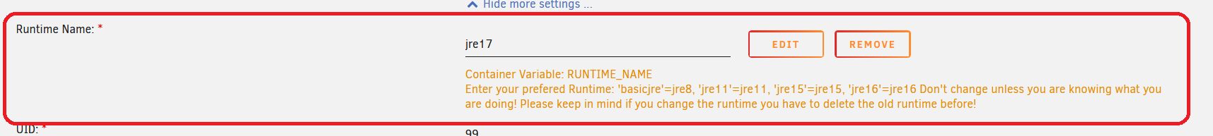

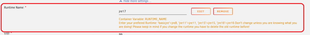

The container pulls the update just fine but give me a little bit, you need to be on Java 17 and the container isn't ready for Java 17, will update it and report back.
@Koen & @Putz.Jimmy container is now updated, please do the following:
  1. Stop the container
  2. On the Docker page switch on Advanced View and press: grafik.png.a0d330a563820cc73d39aec401e145db.png
  3. Click on the container icon and select "Edit"
  4. Scroll down to the bottom and click on "Show more settings..."
  5. Change the Runtime Name to "jre17" like in the screenshot:
  6. Press "Apply"
  7. If necessary start the container agian

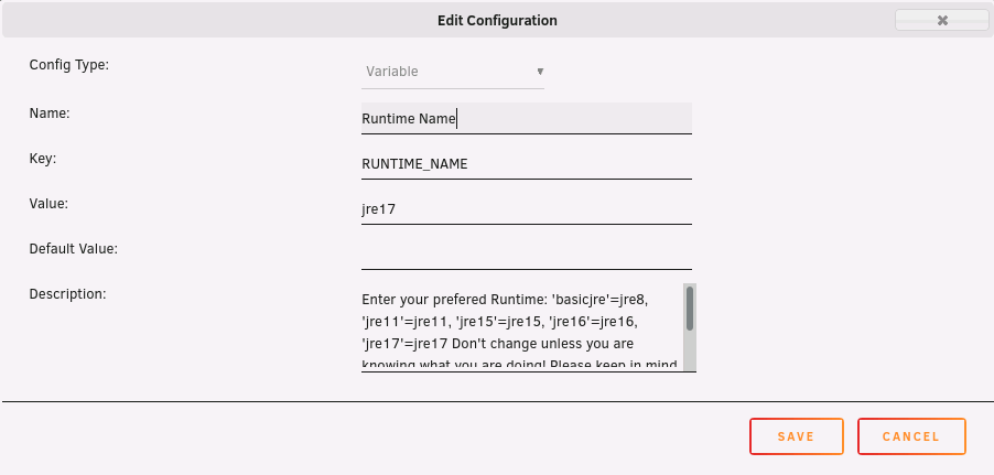

I don't have the setting "Runtime Name" in the settings..... what can i do?
Have you clicked on "Show more..." at the bottom?
If you don't have the button you can simply create it like this:
I've also pushed another update, it should now be enough for you if you don't have the variable in the template to simply force a update like described above.
