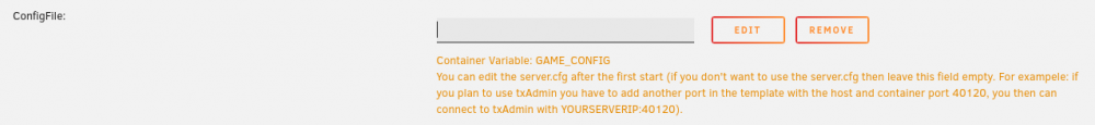

Can you try to to set the Variable "ConfigFile" in the template to nothing like in the screenshot, this will actually start the container with txAdmin instead:
You should then be able to connect to the txAdmin web panel through: YOURUNRAIDIP:40120 form a web browser.

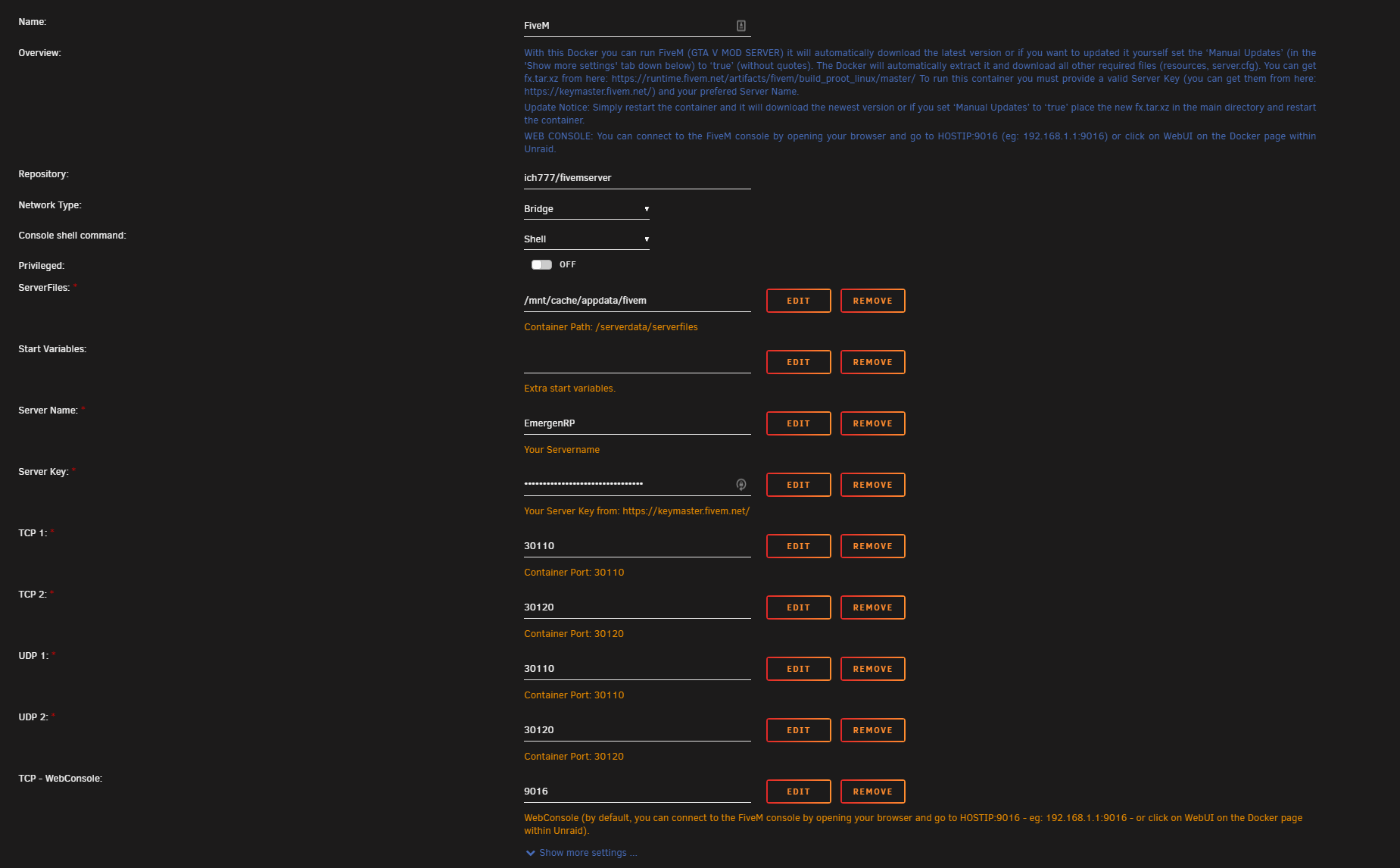

Attaching my config page.
Will also note I cant reach the 9016 port either.
I'm sure I did something wrong but I'm not seeing it as I'm still like super new to Docker.
Have you now deleted the Variable? You have to set it to nothing, otherwise nothing is changed.

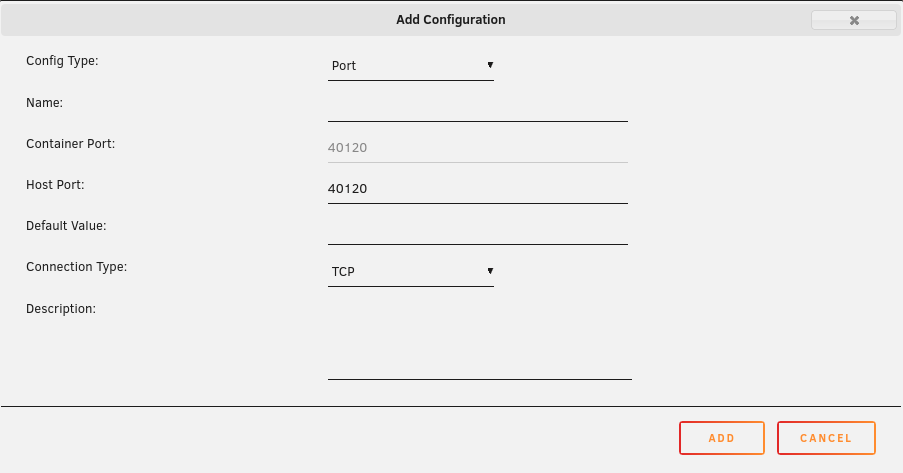

Also I have to apologize, I have forgotten to tell you that you have to create a port in the template like description from the Variable tells you to, like:
  1. Click on: "Add another Path, Port, Variable, Label or Device"
  2. From the drop down select "Port"
  3. Set Host Port to: "40120"
  4. Set Container Port to: "40120"
  5. Make sure that "TCP" is selected
  6. Click "Add"
  7. Click "Apply"

So I got the txAdmin pannel working now but in the FiveM client nothing is still showing up when typing in the IP address of my unraid server.

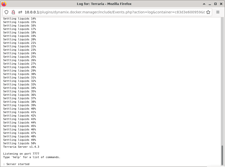

I'm having an issue with updating my Terreria server to 1.4.3 - this is available on their FTP (https://terraria.org/api/download/pc-dedicated-server/terraria-server-143.zip) but no matter what I set inside my config, it always downloads 1.4.2.3 and not the new 1.4.3 that was just released.
Thanks
Thank you for reporting this, actually had a typo in my container.
Container is now rebuilt, please force a update from the container and it will pull the right version:
Confirmed working on my end! That was extremely fast, thank you :)
