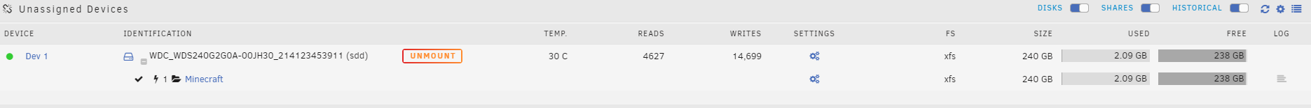

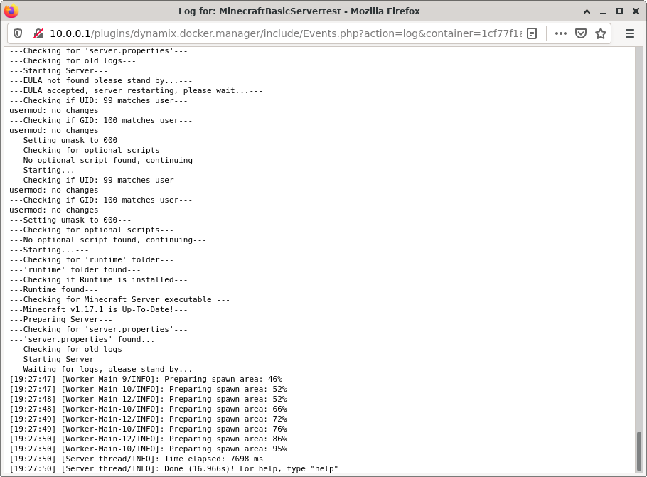

image.png.fe44604529311a59ab04a06bc3eabc8a.pngimage.png.11e96acf41e19f11a7798d6cdc1577d5.pngimage.thumb.png.f7468fb615679be3017ca440034c34f7.pngSo here are my logs, my docker path and the device it leads to. I hope that helps.

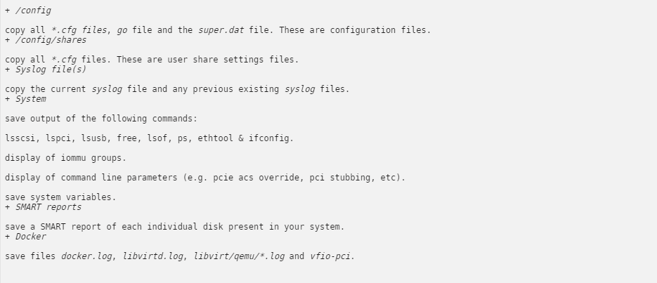

You have to click Download at the Diagnostics page and drop the downloaded zip file here in the text box.

Okay I got it. I just thought maybe I need to do the docker path itself onto "cache/system/docker/" and to save the serverdata itself onto the unsigned ssd I used the path to it while installing "MinecraftBasicServer" and it worked so the docker itself need to be on the cache I guess. At least it works, I'll let you know in case someone else will have the same problem. Thank you for your time and your help.

Can't reproduce this on my server, pulled a fresh copy from the CA App and it runs without a issue:
I've also put the game files like you did it on an disk that is mounted via Unassigned Devices:
